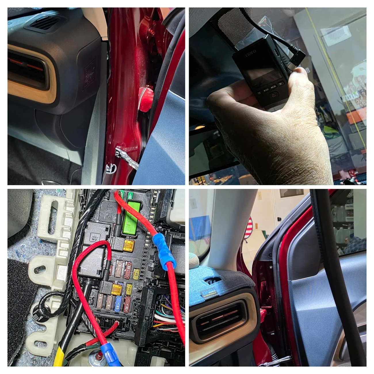

Hardwire install Dash Cam Fuse3 ACC / Fuse5 constant power
pechols
Paul
Nov 17, 2025
Cleburne, TX
2025 Maverick Lariat 2.0
I used F3(spare) for ACC and F5(Locks) for constant 12v. Ground on mount for fuse box. Zip tied cord behind airbag in A pillar. Zip tied excess to harness below fuse box. Used micro fuse taps. Used a small square of clear window film on top of uv protection film/tint on front window to stick camera!
Ford Maverick Hardwire install Dash Cam Fuse3 ACC / Fuse5 constant power 20251210_193415-COLLAGE
