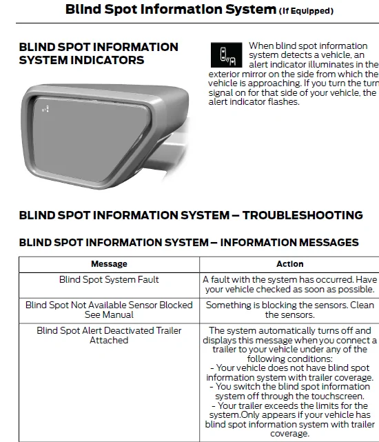

Chops, I didn't do anything like that video suggested. I noticed the indicator on the dash. I didn't know what it meant, so I looked it up in the manual. That lead me to the mud on the sensors. I learned later that the sensors on the side mirrors have nothing to do with the Blind Spot Information System (BLIS). Those sensors are behind the bumper.
Ford Maverick Blind spot information icon on 1781907699147-5n
I never saw any of the messages described in the owner's manual.
