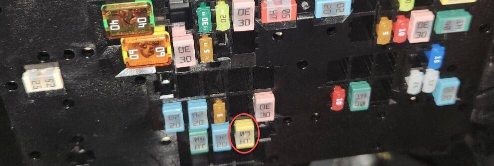

MCASE+ 60HT Fuse

Check Fuses, 10A, 60A.
