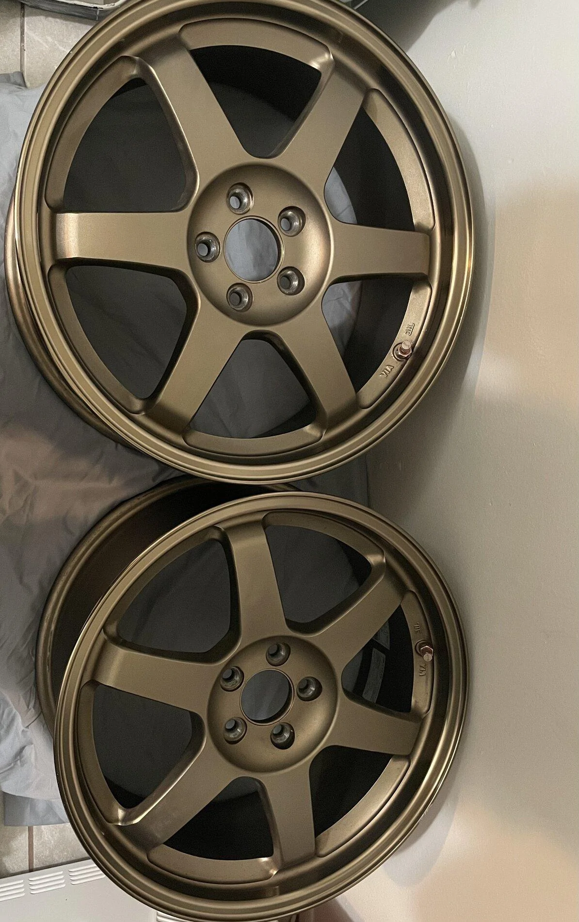

Just got my wheels. TE37 17x7.5 +48.
Think I can make them fit with a 16-19 mm. Adapter. šŸ¤ž. It’ll be a tight fit with 245/65 AT tires.
Those are a classic wheel. Should fit nice with a small spacer they are 5x108 right?
I wish they were 5x108. Don’t think they ever made many in 5x108.
I’m doing 16-19 mm. 5x100 to 5x108 adapter hub centric and wheel centric to be safe of the highest quality. Usually hate adapters but no choice here considering I won’t ever tow or haul anything to heavy I think I should be fine.

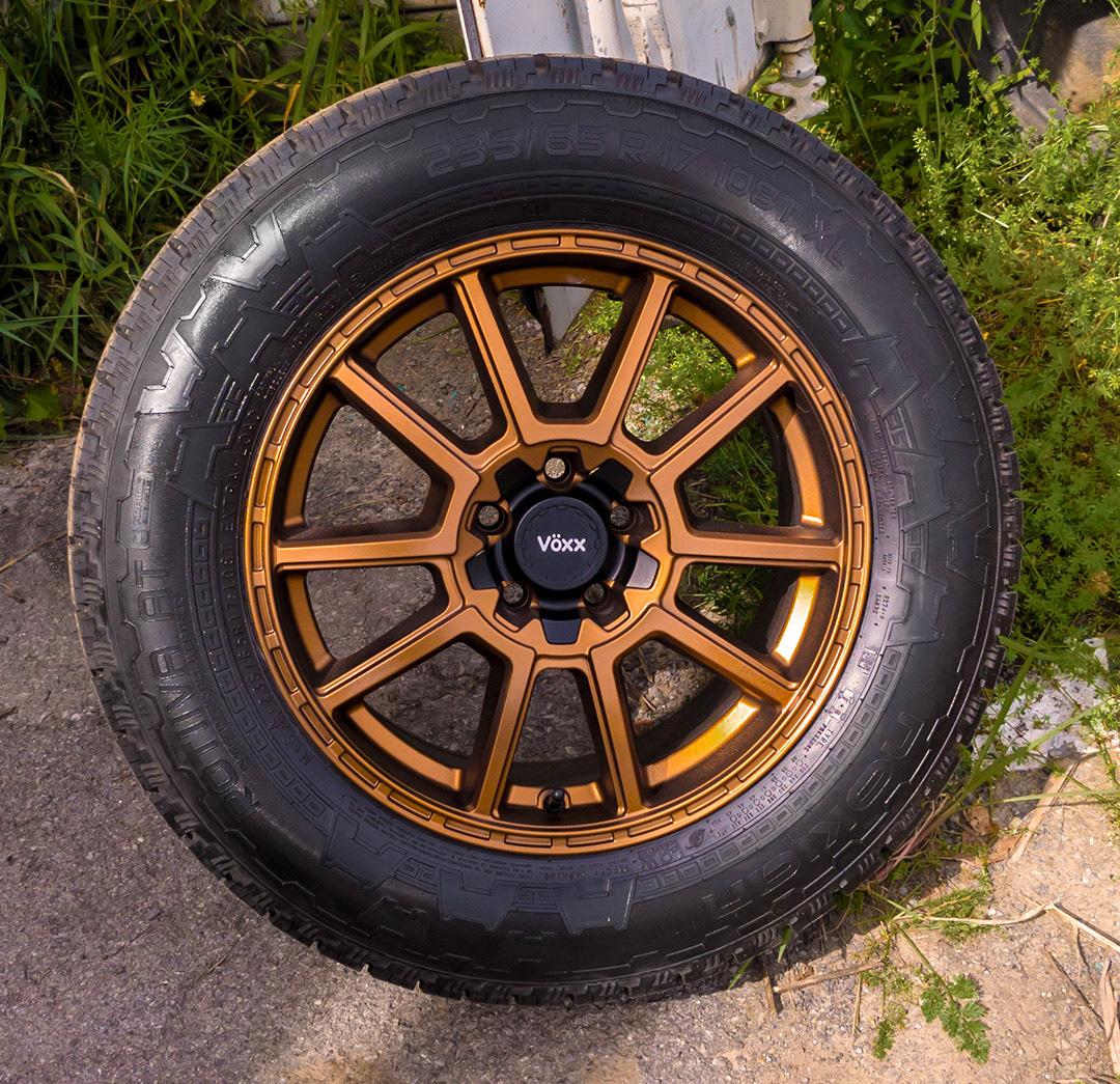

Went with a set of these 17" Voxx Monte's. Mounted up the Nokian Rotiivas and hosed 'em down with some burnt copper plasti dip. Now for the wait for the truck to put them on. 😬
Ford Maverick Anyone looking at +40 offset wheels? rimdipped2

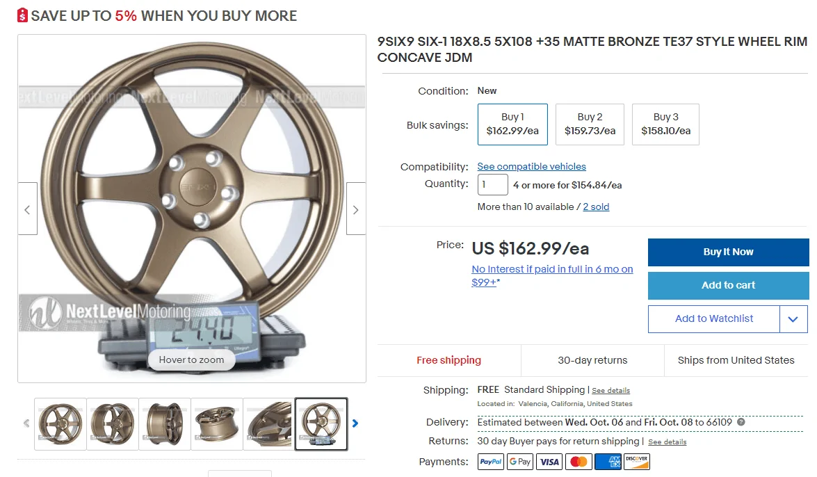

Ford Maverick XLT/Lariat.. Undecided still :O

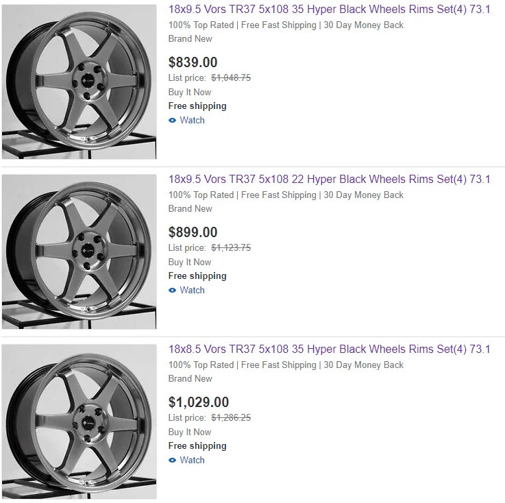

Also found these Vors TR37 in hyper black with a couple of 18" options..
18x8.5 +35 offset
18x9.5 +35 offset
18x9.5 +22 offset :oops:

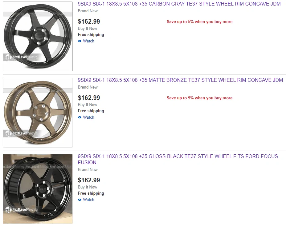

These might be the ones for me.. a little lighter weight than those 9six9 TE37 knockoffs I posted too.
Ford Maverick Anyone looking at +40 offset wheels? 1633111621012
Weights per Vors: 20.5 lbs & 22 lbs
Ford Maverick Anyone looking at +40 offset wheels? 1633111648036
18x8.5 +35 offset
18x9.5 +35 offset
I actually found some real TE’s. In 5x108 but there a 18ā€ wheel and I want to fit a 235/70 17 so went with 17ā€ and a adopter.
How are the Rotiivas?
I’m a huge fan of Nokians, but I’ve only had WRGs & Entyre installed.
Darnon
Jul 4, 2021
5,763
7,307
WNY
I've been running them on our company fleet of Tahoes and they've held up quite good there. Good tread life with even wear and the molded in indicators are easily readable. No issues with shifting belts (Goodyears are my bane) or being overly prone to punctures. They're a little squeaky when new and the size options are somewhat limited. Our tire supplier sells 'em fairly cheap although I actually got my set when Discount Tire had them marked down as a used set despite being new.

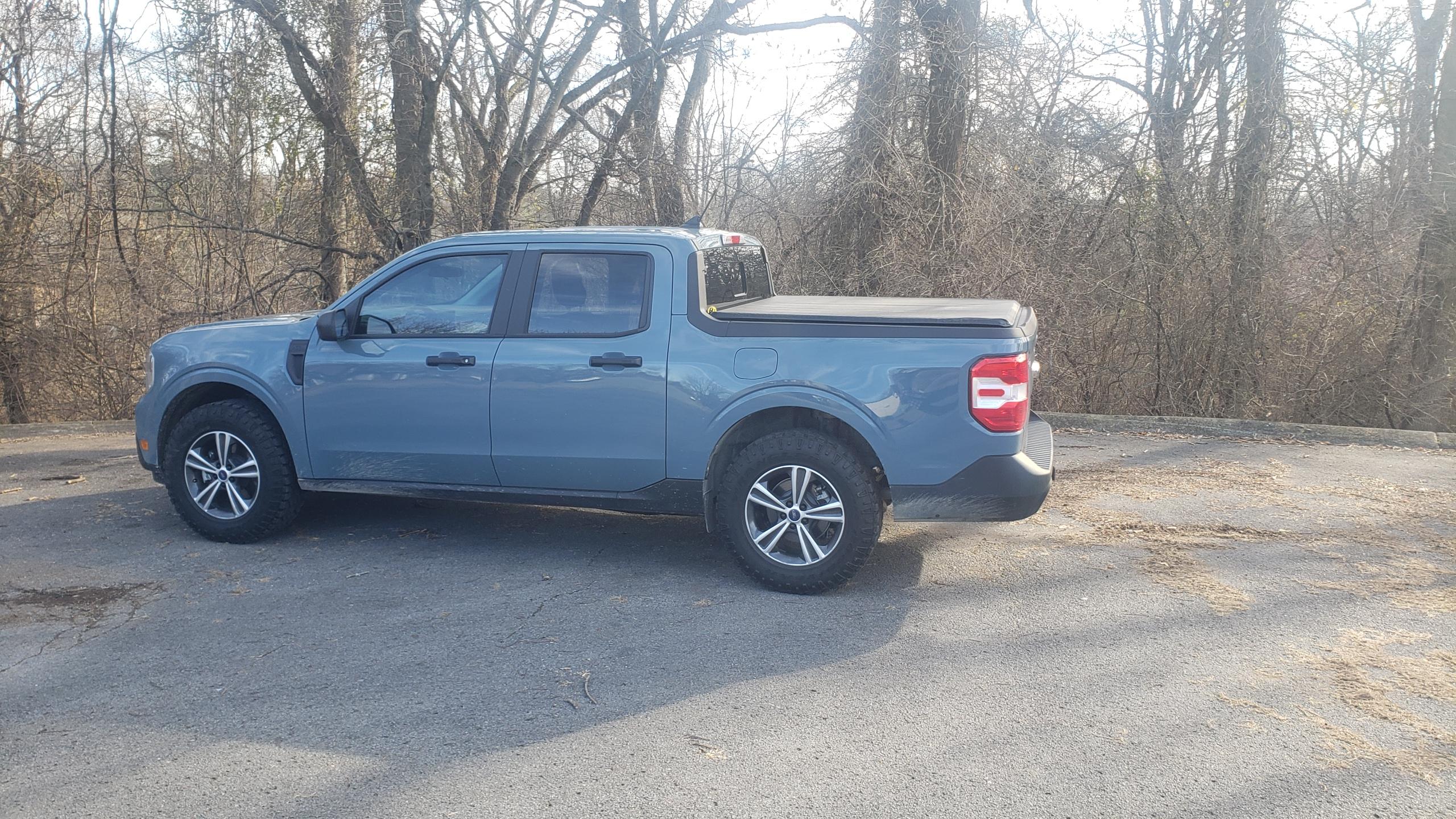

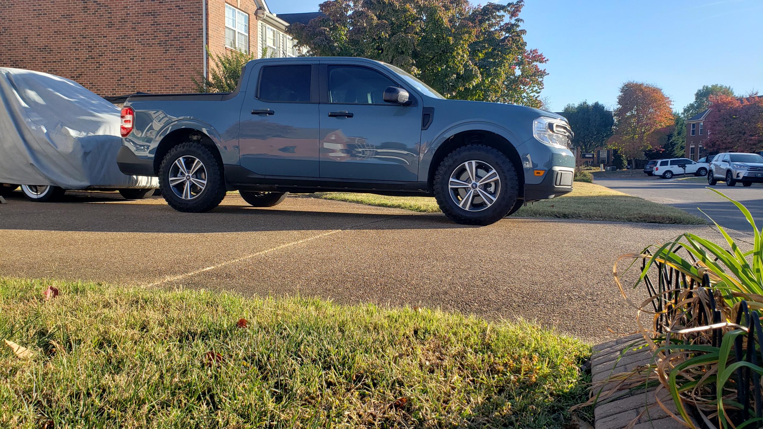

I installed Escape wheels & tires on MAVJEFF this weekend with a 52.5mm offset. I used some 12mm spacers, drilled out the wheels to 5/8" and bought some lug nuts with a shank, to get a better bite on the threads! Wheels & tires are much heavier, & louder!...but, I like the way they look. Time will tell if I can tolerate them...(plus got them at a good price after chasing them for 3 months)
Ford Maverick Anyone looking at +40 offset wheels? 20230121_140845
Ford Maverick Anyone looking at +40 offset wheels? 20230121_140919
Ford Maverick Anyone looking at +40 offset wheels? 20221021_162202
