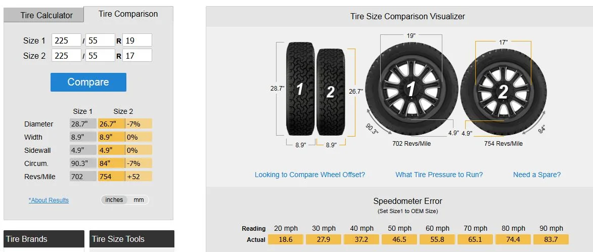

Hello Group, the 2025 2.0L I have came with 225 55R 19, I inherited winter tires 225 55R 17's , I plan to just get some steel rims for winter use, Do you see any issue going to 17's ? the drop in height, probably an inch or so doesn't bother me at all, and I'm wondering if doing this will violate any warranty, I think not but just wanted your opinions.

225/65R17 is a better size for a winter set up

How many miles do you put on during the winter? If you are going to all the trouble of getting steel wheels, I'm not sure what you really end of saving with tires that will have a smaller rolling diameter. If you don't go far, it won't matter too much, but if you will put on a lot of miles, I would just get things right.

You need 225/65R17's.....I went from 225/55R19 that came with my Lariat to factory size 225/65R17 snows on Maverick steelies for the winter...no issue at all. Used with a set of Motorcraft TPMS-117 sensors and reset with Motorcraft TMPS19 reset tool. Works like a champ!!

I had this issue on my 2000 Ranger. The winter tires were 1 inch smaller. It delinitly changed my speedometer reading and racked up the odometer miles faster. I don't know if the Maverick would adjust to that difference.

It's not so much the wheel diameter, as long as it fits your brakes...more so the total tire diameter based on both the width and sidewall ratio of the tire.
Good posts already here that indicate that's a pretty significant tire diameter change.
For reference, this is my goto site for comparing wheel/tire fitment and speedometer/odometer effects.... https://www.willtheyfit.com/
Enter stock wheel/tire and potential wheel/tire and it will give you all the details.

https://tiresize.com/calculator/
I don't know if you'll violate your warranty but you'll use it up 7% faster. :)
Any way to adjust the speedometer when you drop tire size? Maybe at dealership? I bought 17's (truck came with 18) snow tires... Tire shop said difference between the 2 would be only .25 mph at 65. NADA... Much greater. at 70 we are talking 2 mph, at 75 3. Really creates havoc when towing my snowmobile trailer. Have GPS map program running on my phone so know the real mph, but it is also screwing up the miles to empty as well. I can get down to 25 mte and gas gauge is still showing well over a quarter of a tank.
