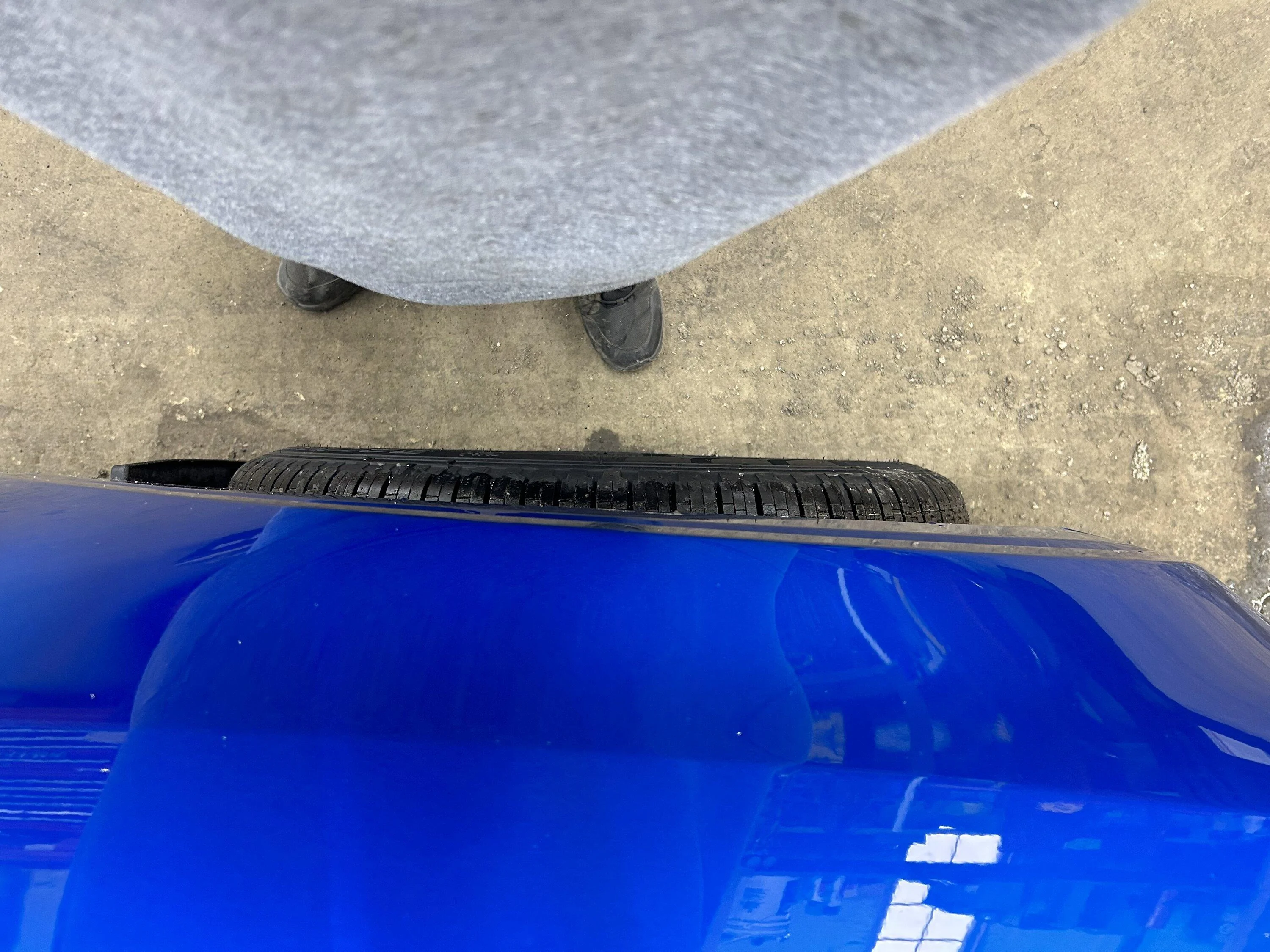

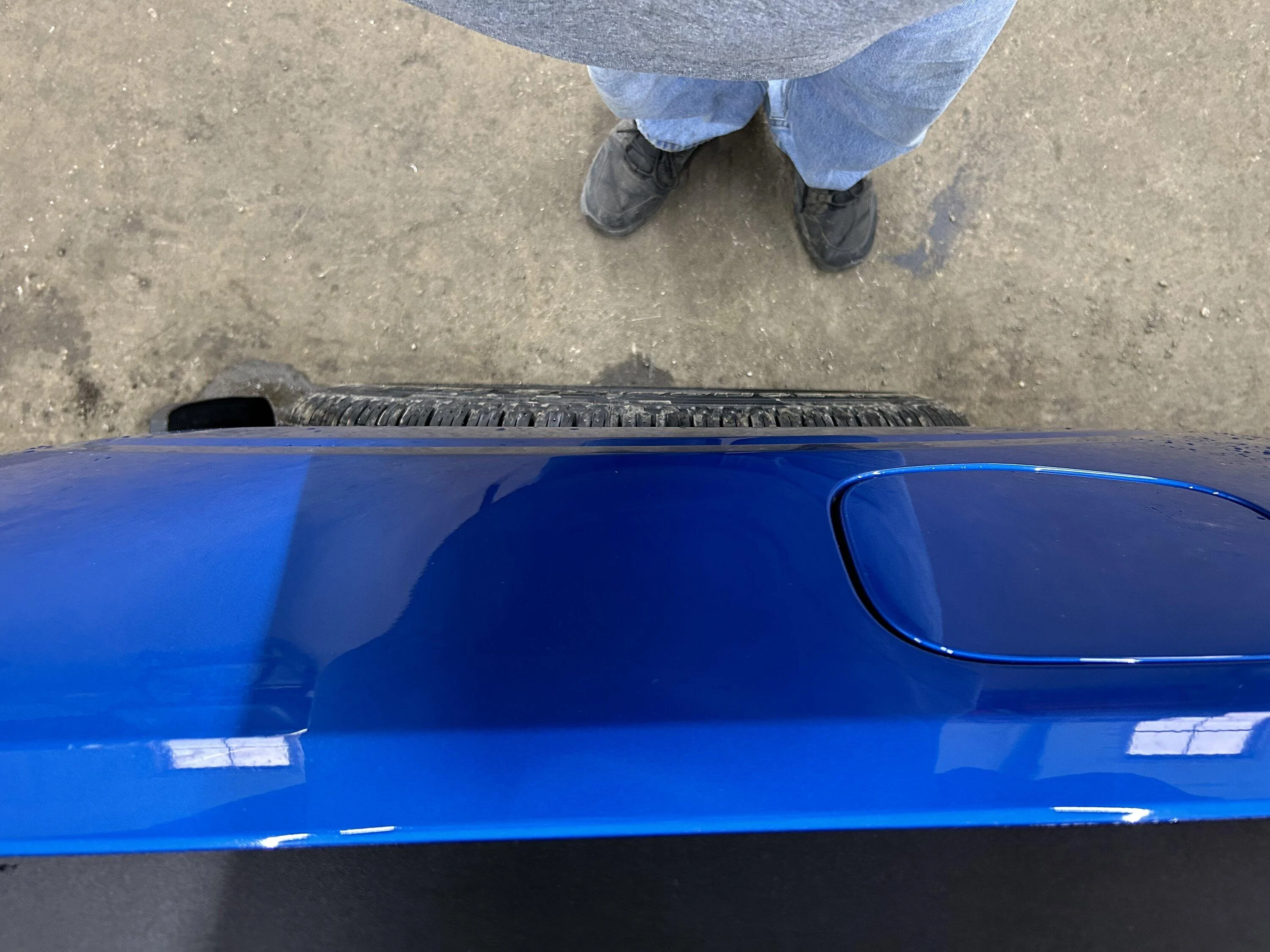

Bottom line is in addition to the track width difference of .6" (15.24mm),
you would need to measure the body width difference between front and back.
While the rear track is narrower, the fender bodies are slightly wider in the rear than front.
(Visually - i have never physically measured)
In addition to the info above from @Justin.23 , there is a thread by @Tug Toy with more pics
showing off 15mm spacer fitment.
The other thing to pay attention to is your proposed wheel/tire combo size and offset.
Tug Toy and I both went with 20x9" wheels. He went with +37/38 offset and 275/45/20 tires.
I went with a +30 rear offset and 245/45/20. Front offset is +45.
Ford Maverick What size wheel spacer (difference) to even front and rear? 89342e4b-72fd-461f-b18e-f442b82e78e5-jpeg
Ford Maverick What size wheel spacer (difference) to even front and rear? 336ed3b6-5120-4d66-9033-ba8949c04e9b-jpeg
^^^ Tug Toy

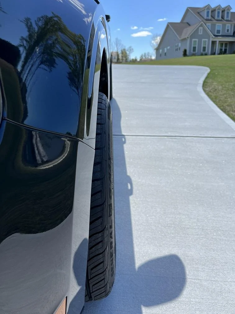

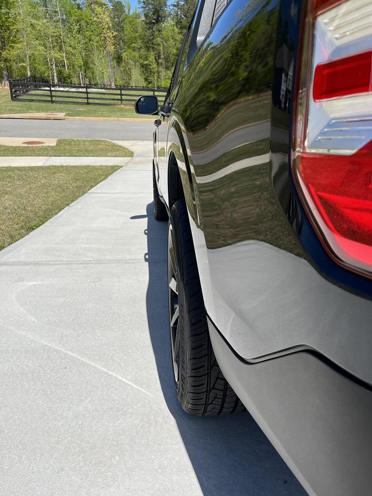

Ford Maverick What size wheel spacer (difference) to even front and rear? af_blue_back2front-
Ford Maverick What size wheel spacer (difference) to even front and rear? af_blue_front2back-jpg
^^^ "AF Blue" (sorry, not the best profile shot to compare)
As you can see, Tug Toy shows tire tread exposed past the wheel well (at top center).
My setup has the tire tread right at the edge of the wheel well (at top center)
Hopefully this made some sense and helps.
It comes down to your taste (and OCD factor :)
