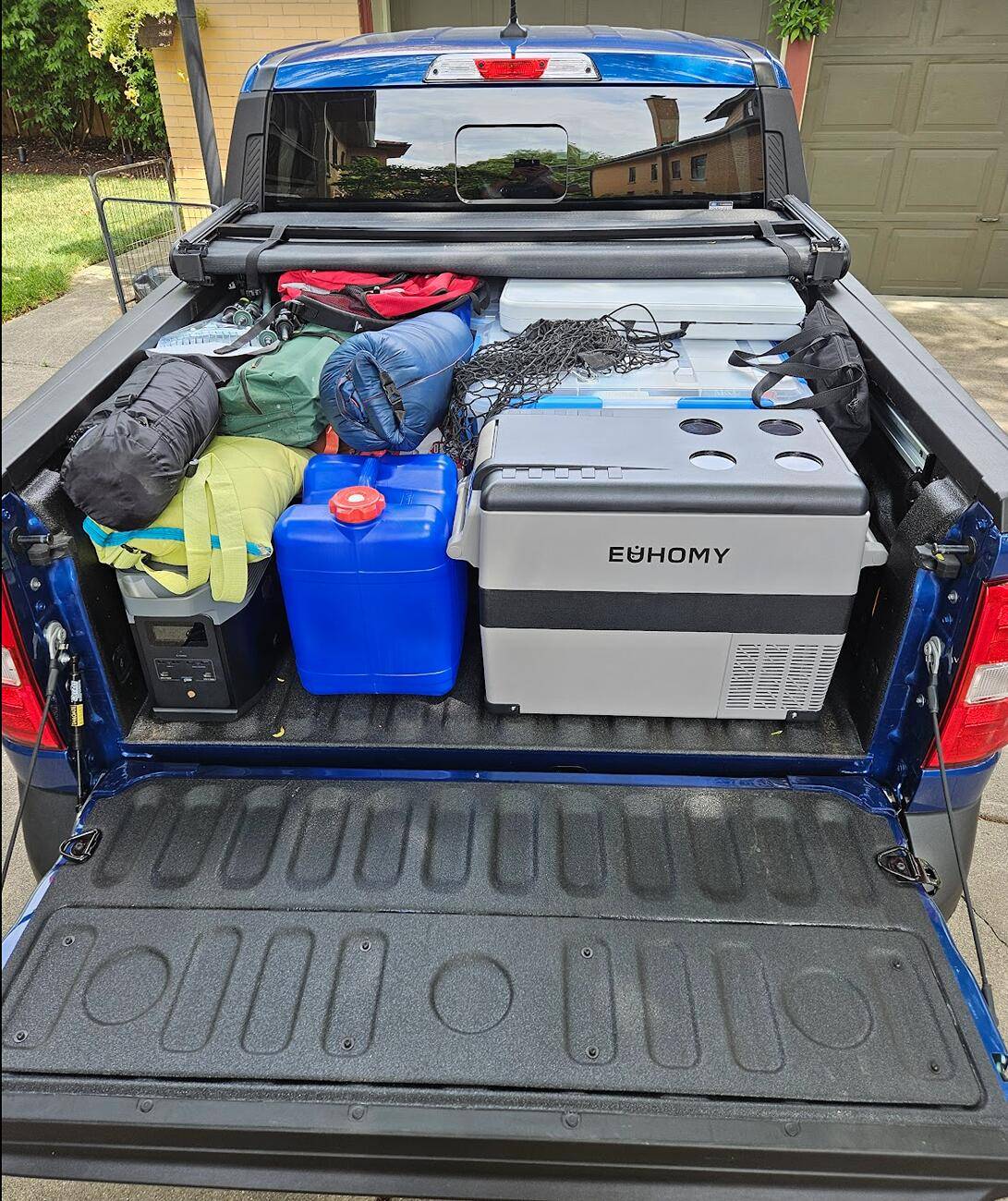

Yes. I added this to the cubby tapping off the 12V whip. It only stays powered while the engine is running. I have an Ecoflow Delta 2 power pack (left side of bed pic) to power the fridge while stopped. The combo lasts me for 3 days while camping. If needed, the Ecoflow can be recharged from the 12V connection while driving.

That looks really clean. What 12v panel is that?

You have to remove the D-hook and cubby. Attach the 12V whip and route to the back of the cubby.
Tip: Cut the square/rounded corner hole in the cubby to just circle the connections leaving surface for the mounting screws. Re-install the cubby and then attach the panel. You won't be able to reinstall the cubby with the panel and connectors already attached. https://www.amazon.com/gp/product/B0B3WXS3GQ/ref=ppx_yo_dt_b_search_asin_title?ie=UTF8&psc=1
