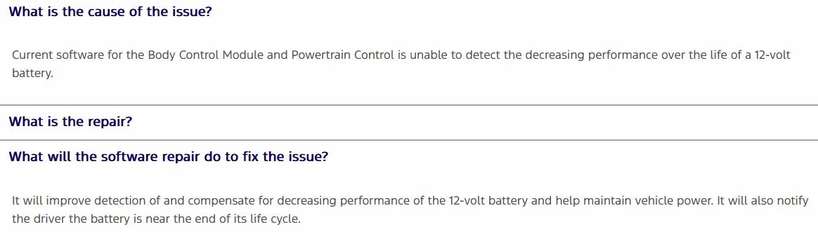

Ok, now besides the 25MY, I'm curious about the BMS tag on these EB models. (side note - this is a driving safety level recall with stop demos/sales until performed)
If the solution already was done here - this ain't the hybrid's problem I'd guess.
https://es.ford.com/support/how-tos...-and-maverick-2022-2023-loss-of-power-recall/
2022 February 3, 2021 through October 31, 2022
2023 June 20, 2022 through October 28, 2022
In the affected vehicles, the Body Control Module (BCM) and Powertrain Control Module (PCM)
calibrations may be unable to detect a sudden battery degradation while driving. If the battery
suddenly degrades during a drive it can lead to a vehicle that is unable to restart after an auto
stop/start event or experience a stall while coming to a stop at low speed. Either of these conditions may be accompanied by a loss of 12-volt accessories, including hazard lights. A loss of motive power can increase the risk of a crash.
Interesting the 2 phrases aren't really in agreement - "decreasing performance over the life..." or "sudden battery degradation".
Interesting how it is fixed - compensate for decreasing performance.
IE battery saver and disable auto-start/stop!
