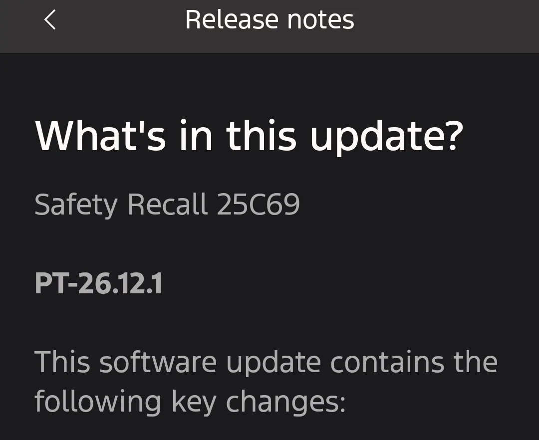

What update was it?

Yep that’s the one that is out

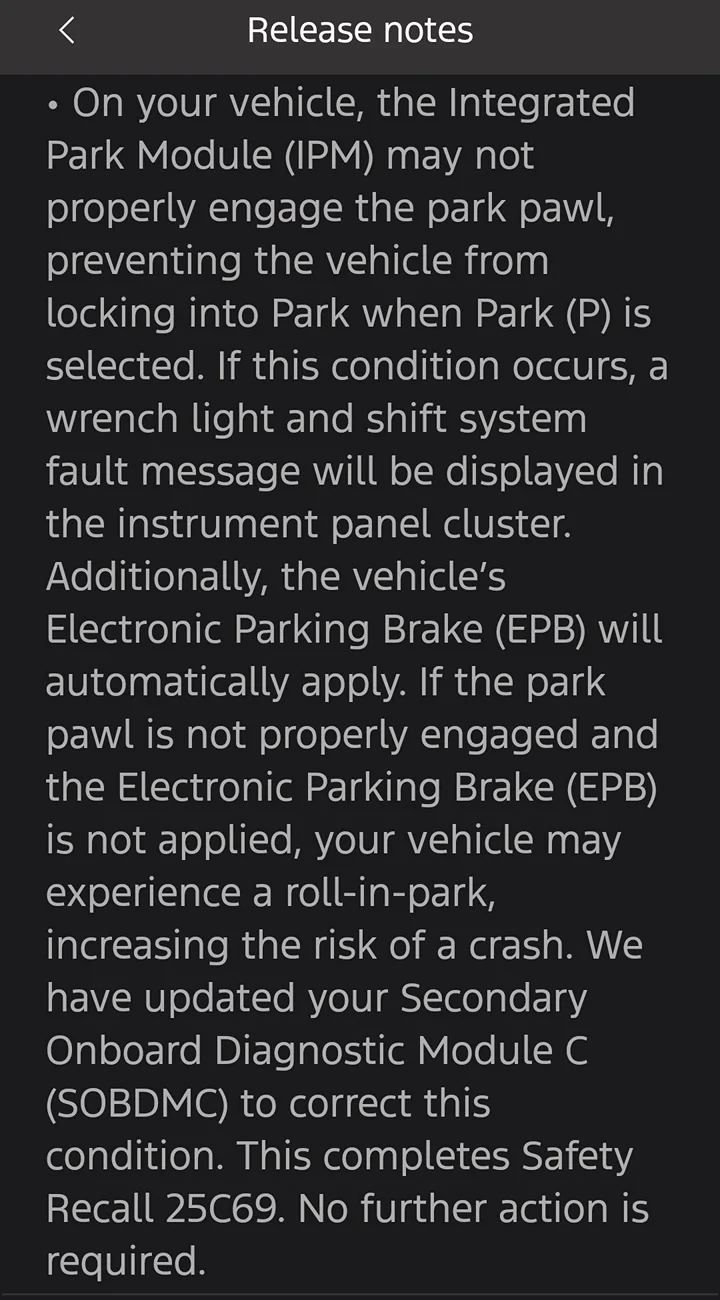

When I had Ford Mobile Service perform the 25C69 recall in the driveway, the MTE was reset and I "lost" something like 160+ miles to empty. After a drive and a refill a few days later, it was climbing back to where it usually is....a "reset" if you will as part of the software update.
