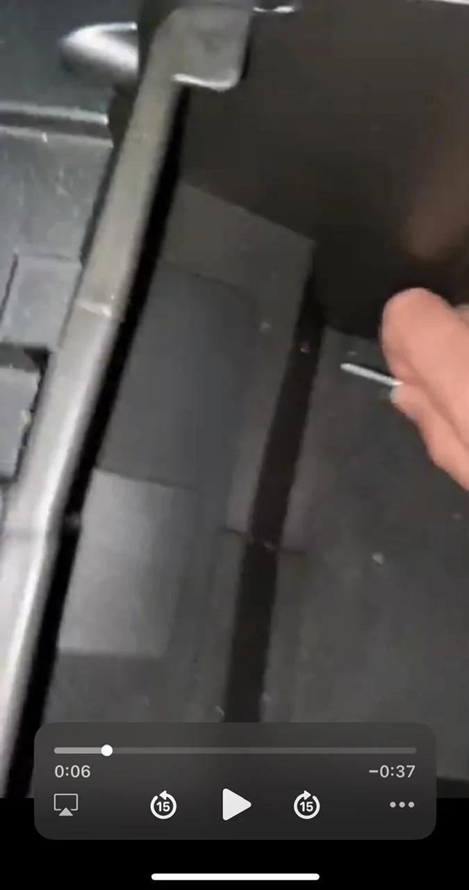

According to the Russian Video:
There is a hole and you press that in the hole to "unlock" the gear selector if you don't have a key in the ignition.
Example: you "abandon" your car in a snow storm. Tow truck comes along, you're not there, they use a slim jim to open your door; then they press this universal tool in the hole to get your truck in Neutral so they can tow it.
I couldn't access that video. Says it is "age restricted" and wanted me to login with a Google account that I don't have. Thank you for looking through it.
Any idea where the hole is located? I also don't have a key (Lariat only uses the FOB and a button to start).

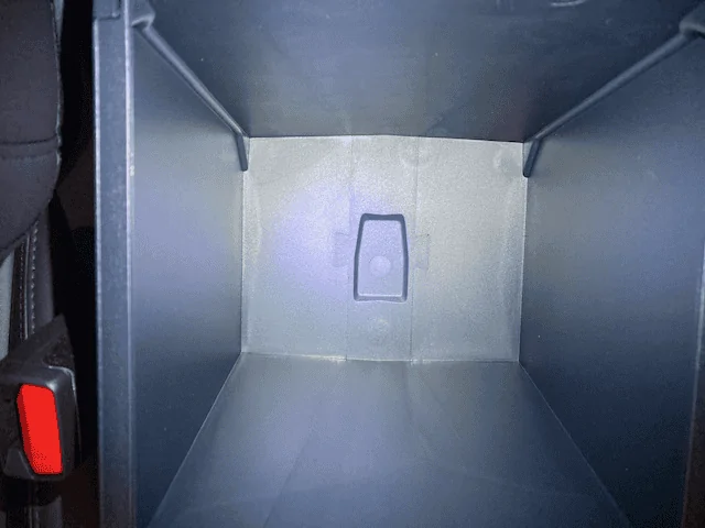

Inside the center storage bin, lower right.
freeze frame
This feels a lot like the new version of those kids who steal Kias and Hyundais with a USB drive crammed into the ignition............ Haha.

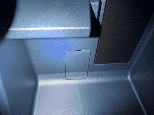

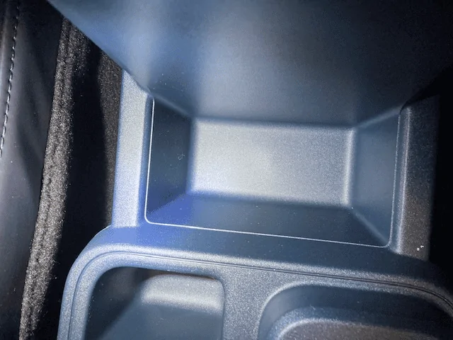

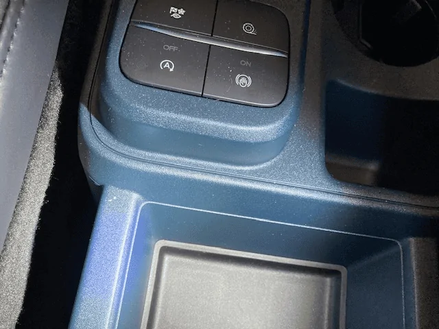

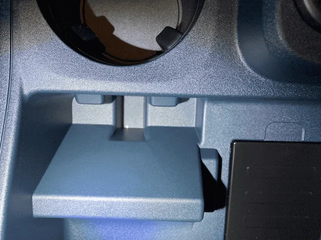

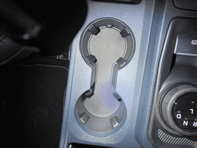

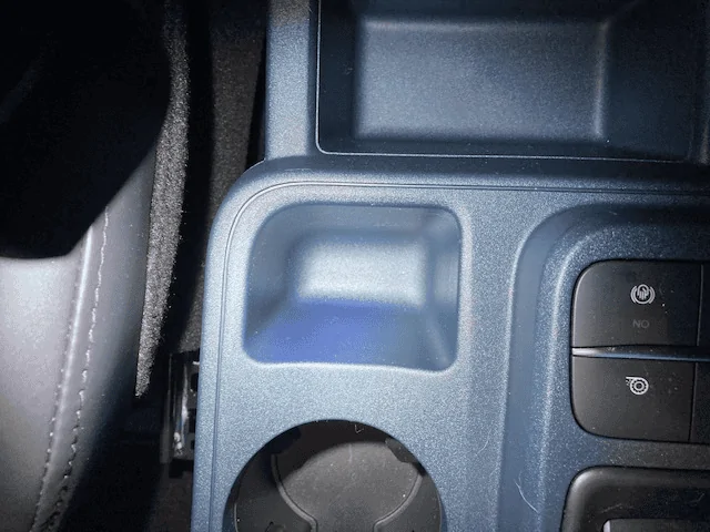

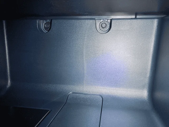

I have no idea where that picture is referring to. I can't find any hole in my center console:
Not in the center console under the armrest.
I believe it’s under the front console rubber liner that is under the dash board, in front of the gearshift knob. On the right side. There’s a small rectangular compartment with a lid under there.
And yes, we got one of these in the glove box of our XLT EB.

In the Video; was inside the cubby.
Video was Ford Fusion.
Same transmission.
Same gear select.
Even looked like same cup holders.
Now we know what it is for.
