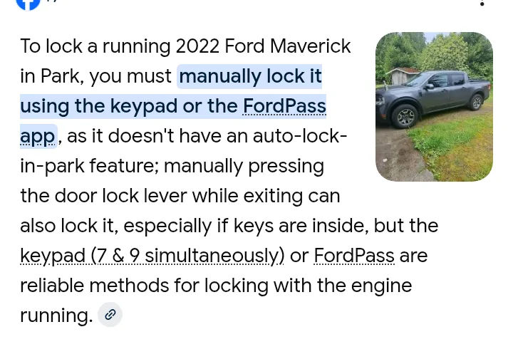

Not to derail the thread, but once upon a time I had a truck that had the lock, unlock buttons on the armrest. I was only locked out of that truck about 3 times by my dogs... Just about the time I would remember and try to get back it was too late. Once with the truck running. Thankfully I had my phone on me which was a miracle and called for reinforcements with the spare keys. The bad news was it took over an hour and it was winter and the snow just started dumping.... Good times I tell ya. At least with the door lock where it is in the Maverick I don't think the dog will be locking me out! ROFL

Because some people DO want to lock their keys in the car, even running sometimes.
With non-keyless entry system if the key is in the ignition - pressing the Lock button warns and unlocks all - you can't lock it there. Failsafe against easy accidental action.
So the purposeful action that you do want to leave key in ignition - is the lock lever.
Door closed - Lock button for all doors - open door - press lever - close door.
Sadly a bad combination of settings and design of lever location can make those steps not all required.
With keyless entry if the fob is in the cabin - Lock button does same warn and unlock.
Unless it sees a fob outside the cab.
Sounds like same process if a desired action.
Problem is - setting for unlock all doors when driver opens door may be disabled, making the accidental lever press a much worse outcome.

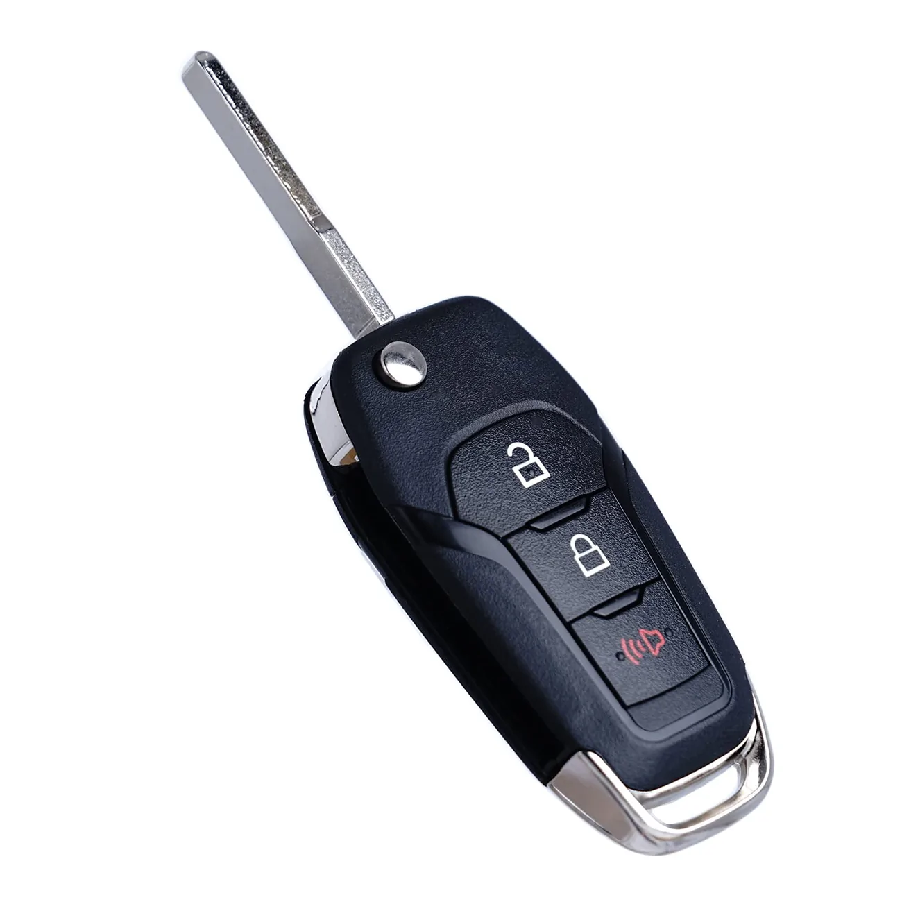

Has anyone who has a 2025 Maverick XLT been locked out? Last week I visited a farmer. When I got out to talk to him, he told me to go to his other shop building. I had closed my driver's door with the engine off, and doors unlocked. When I came to get back in, the driver's door was locked, but not the other 3! When I came to leave, I had unlocked my doors to put stuff in. I had the keys inside. I went back to put more in and found that all the doors were locked! Called my salesman and asked what to do! He didn't know! Then he called back to tell me a phone number where Ford could come and unlock my doors! It would have been great if I had been able to use FordConnect in my FordPass app, but I spent a couple of hours trying to get the authorization to come up on my screen, but to no avail! Still don't have it! Also, I have the park brake come on SOMETIMES when I stop, other times no! I've had to make extra door keys for my billfold and my wife's purse to keep this from happening (the doors)! It seems that the onscreen operator's manual isn't for this Maverick, because I couldn't find the rear window lock by the manual description! It was on the door! Also saving favorites on the radio had poor description! Wrong manual, too? Wow, not even 1000 miles!

I've tried everything I can think of and my truck will not lock.
Think about the days before we had remote locking via keyfob.
This might be a dumb question... but have you tried locking/unlocking it with the KEY itself and not the fob? At least it's a workaround until the electronic issue gets addressed.
When you're about to exit the vehicle, push the manual lock lever (not the electronic button, but the mechanical LEVER) on each door to lock them, including the driver's door. Then close the door(s).
Put the key in the lock on the outside of the door, and turn it to lock it or unlock it.
Or am I missing something?

I don't have an actual key, just the key fob with the unlock and lock symbol.
I have an XL. The fob has a silver button sticking out of it. I press it, and the key flips out of the side of it. An XLT doesn't have that?
XLT…it does. if It doesn’t have the flip out key there’s usually a key inserted into the fob that you can take out. Come on guys…It’s 2026. This in NOT something new with Ford trucks. 🥴🥴🥴
Well - you do actually.
But - did you catch the point about pushing each doors actual lock lever?
Not the lock button - the lever.
Also - you got one big computer there - have you tried turning it off and back on again?
Disconnect the negative battery terminal 3 minutes after shutoff.
Wait a couple minutes, put it back on.
I went to Ford yesterday and found out about the key. Thanks! Also, if the key is on me and I walk to the door it will unlock automatically. If I open the driver's side or passenger door, the back doors will unlock. I'm not sure this is a good idea. I would hate to think that if some creepy person is in the parking lot, they could just open the passenger door when I get to my truck. A lot of my friends are getting new cars, with all the computerization. I guess I need a bumper sticker that says "Old Driver New Truck" LOL!

The unlocking of the doors is selectable using the menu options.
