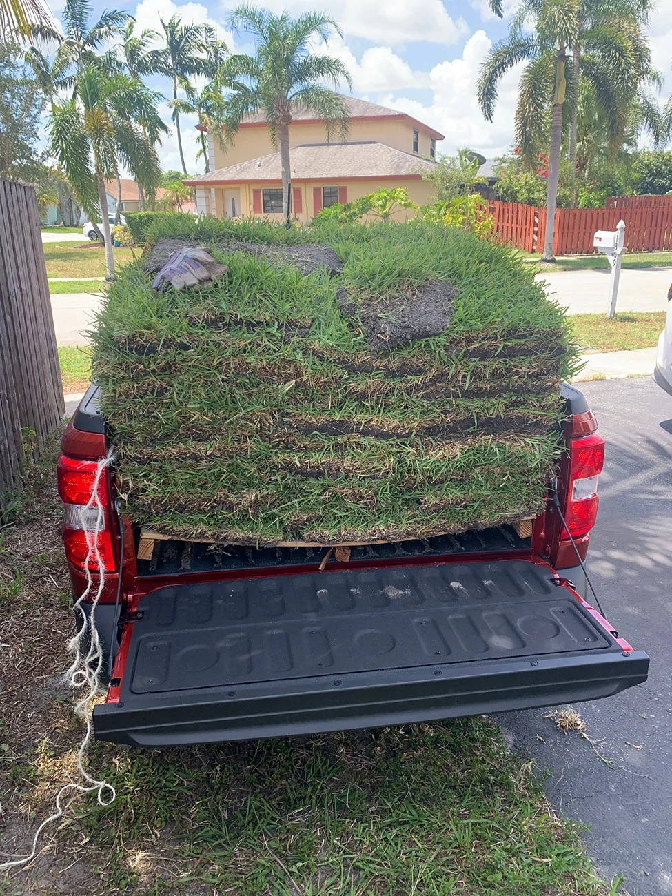

Here is an example of an owner (me) not reading yellow sticker and listening to his son. Picked up a 1/2 pallet of sod (around 1500 lb) and had 400 lbs of passengers.......truck did just fine. Son told me 1/2 pallet weighed around 400 lbs...LOL
Ford Maverick Weight in the back / bed -- 470 lbs load ok? IMG_7792

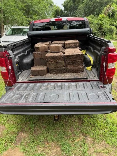

Need to make 1 hour drive to get some pavers. Approx total weight is 470 lbs. Can the Maverick handle this? It's 90% freeway drive.
You could put about half of them on a hitch tray🤗
Looks like the forklift driver was from Pakistan?

The bed should be fine. I have carried 600ish pounds of trash to a dump. 20 concrete deck pavers, six 2x6s and some plywood. The most difficult job was having concrete bags that was barely under 1500 lbs not including me and my friend. The truck was squatting and I did slow street driving but we got home with no issues.
Depends on if you get the grass with or without dirt.

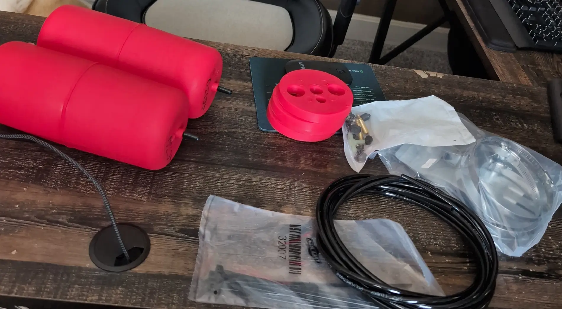

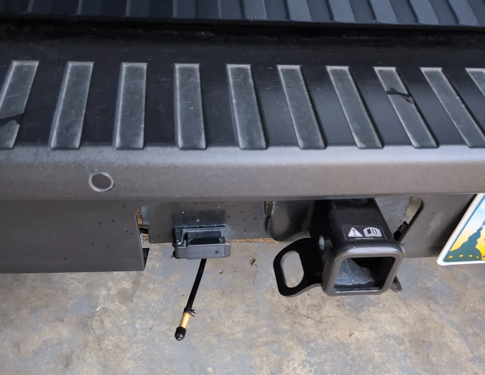

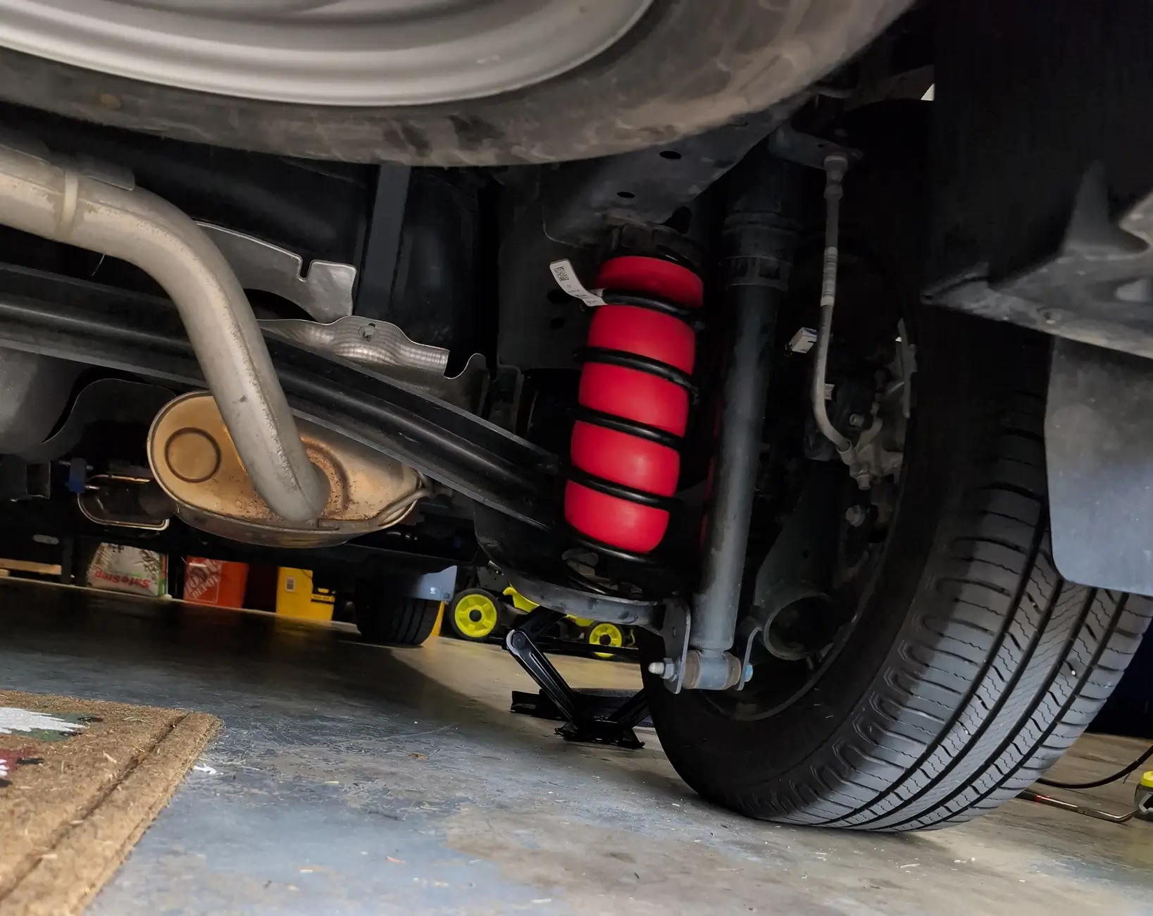

had the 60911 air lifts show up yesterday. Took a few hours and scrapped my hands up a bit fitting these things in there but i would recommend them if your going long distances/driving at night/notice you lose traction when heavly loaded.
Another benefit no more brake diving.

Ordered that tow plate cover and mounting that tip to make pretty later.
The ride reminds me of my sequoia that had airbags in the back.

Pro Tip:
Buy slightly shorter air bags.
And jack up the side you are working on and let the wheel hang. Stretches the spring and the air bag goes in easy as pie.
The bags do not need to fill the entire cavity inside the springs.
