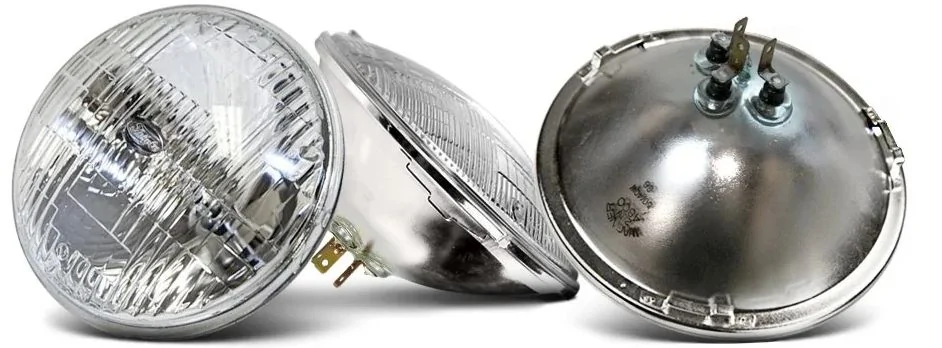

The old sealed beam headlamps didn't have condensation problems, their glass lenses didn't yellow with age, and they didn't cost $1,500 each to replace.
