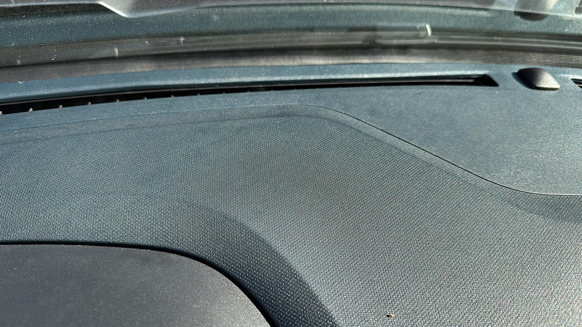

¿Alguien ha tenido un ruido similar?
Escucho un ruido de traqueteo en mi Maverick 2022, el ruido es causado por la ventilación del aire del desempañador.
Estoy pensando si es posible acceder a esa ventilación quitando el grupo, ¿sería posible?

Yes, when I had my 2022 Lariat EB, it had what I describe as a rumble in that area. The sound happened over rough, uneven road surfaces.
I believe it is where the ventilation duct connects to the vent, what you show at the top of the dash. If so, it is difficult to get to that area. It requires dissassembly of the dash.
I determined it would cause more damage to try to fix it than it was worth. I don't trust Ford dealers.
Because I purchased the 2022 EB while I waited for my hybrid to be built, I just ignored the noise. My 2024 Lariat hybrid does not have the noise, the dashboard is tighter than in the 2022.

Some people stuff strips of colored felt or foam tape in the plastic joints to avoid the movement noise.

Thanks, it seems like a good solution but it didn't work in my case.
It is difficult because accessing the ventilation requires disassembling everything
