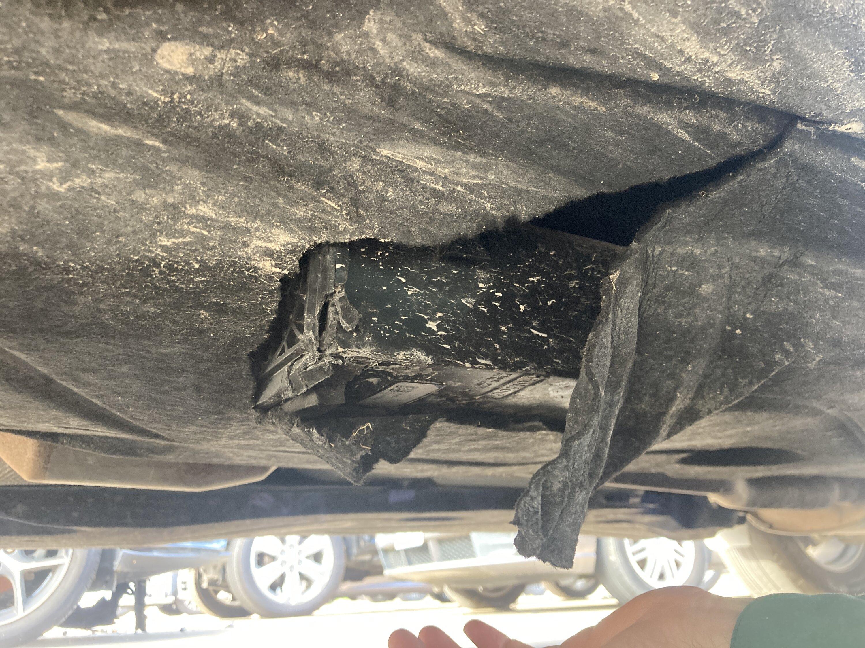

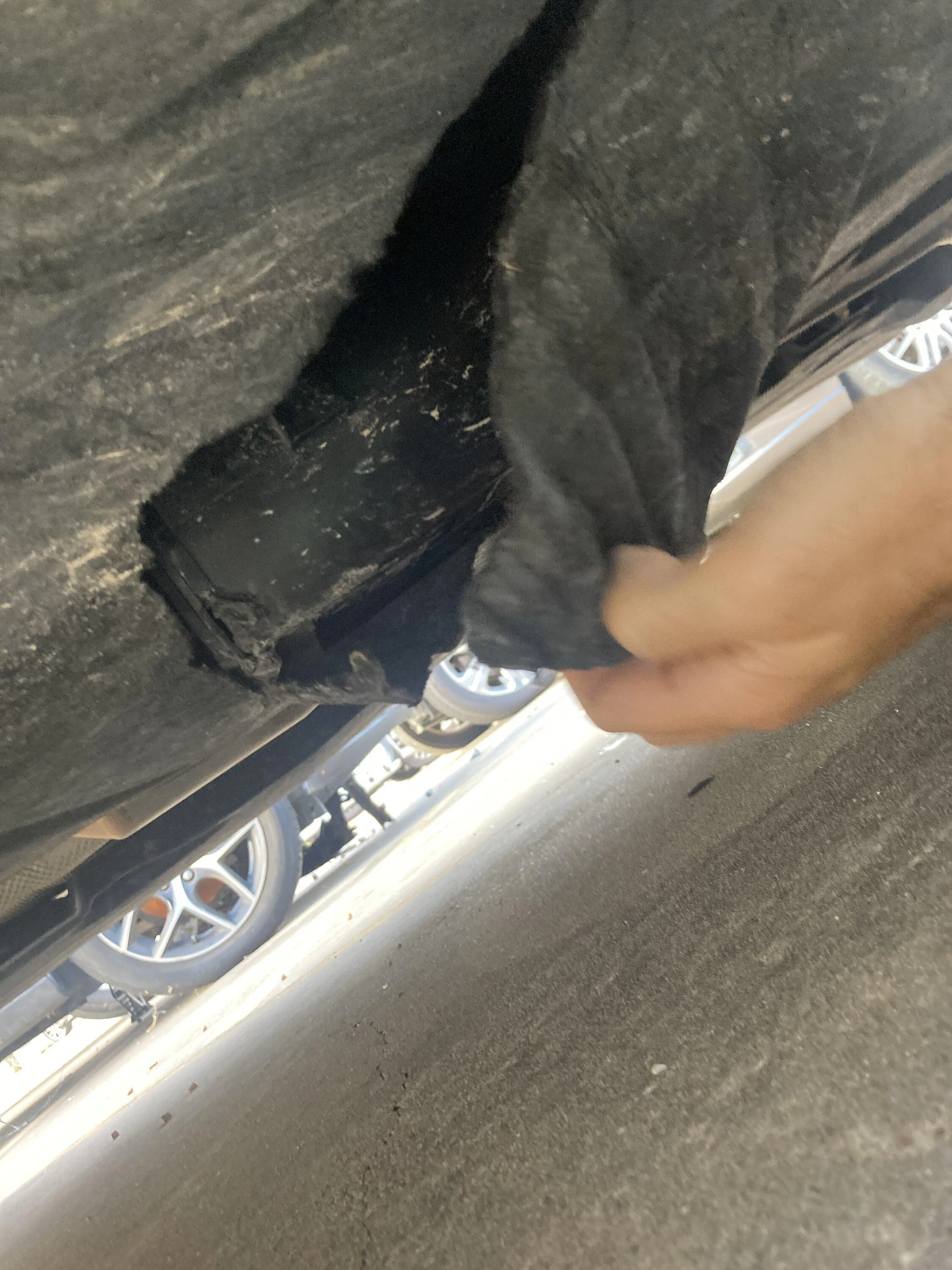

I haven't been able to bring myself to paying Ford $750 to do this repair yet. This felt skid plate is a joke. Somebody please stamp some out of steel or sell us some rock sliders.
I'm going to try the fiberglass method of plugging too. I hope I can get the mounting tab back on their well enough to hold it for the foreseeable future.
Parts Dept. gave me PN LX6Z9D653F $459 for the evap canister
and LX6Z6775R $97.17 for the "under shield".
Service Dept. gave me PN NZ6Z 9D289 A $207 for the evap canister and PN NZ6Z 9B007 AA $45 for the "under shield".
Why the difference?
Service department wants $725 for evap canister replacement and $200 for under shield replacement.
O'Reily's website says they're $269 and special order...
Motorcraft Vapor Canister CX2660 | O'Reilly Auto Parts (oreillyauto.com)
I took the Motorcraft number you got from O'Reillys and got a link to RockAuto for the same part for $235.79. They even show the Ford part number which matches the number you got from the Ford parts department.

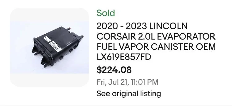

Found a replacement on eBay with the same part number for a “Lincoln Corsair”. The photos look the same. For $190, I’m going to give it a shot. My understanding is that fiberglass won’t permanently or chemically bond to the plastic Evap canister. It will just stick to it like a clamp or glue that will eventually rattle free. Once it does the check engine light will come on again.
I might try some stitching/sewing and/or adhesive on the felt cover though. That thing needs to be steel asap.

Found a replacement on eBay with the same part number for a “Lincoln Corsair”. The photos look the same. For $190, I gave it a shot and it’s an exact fit!
Truck has run another 25K miles with no problems.

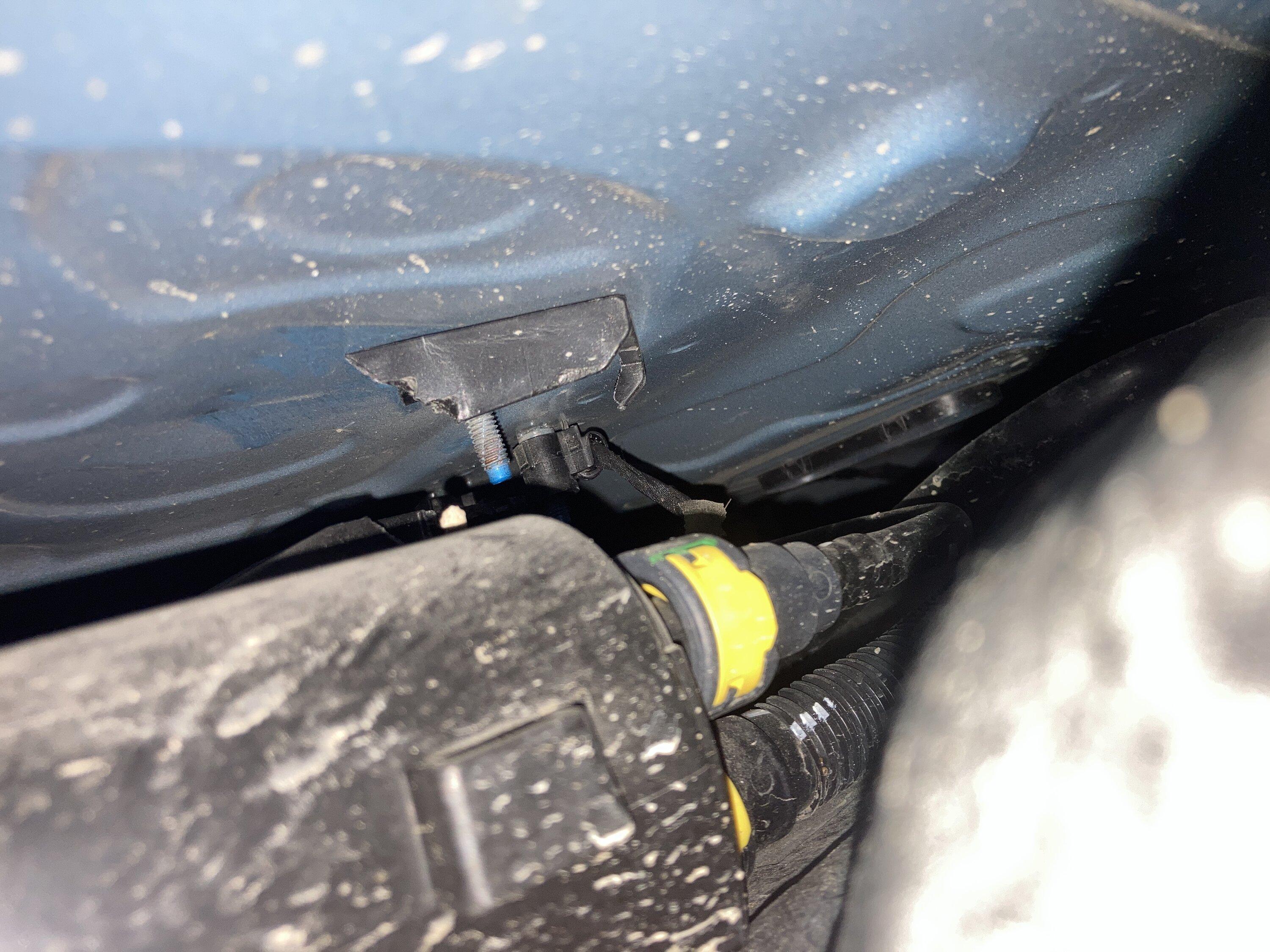

Oh boy.... Mrs hit a road gator (tire casing) on the highway and cracked open the vapor canister. Got a replacement from LKQ for $119+tx (<6k miles on canister), but darn it I cannot figure out HOW to get the large hose pipe off the existing damaged canister. The two smaller lines I figured out, but the large one...? No clue. Any suggestions would be helpful. Thanks -
jmk63
Feb 27, 2026
North Bend, WA
2025 Maverick XLT
Whoops. Nevermind. LARGE black connector is a side squeeze and pops off. Now to go back to LKQ and tell them their part interchange system doesn't work for this canister. <sigh>
