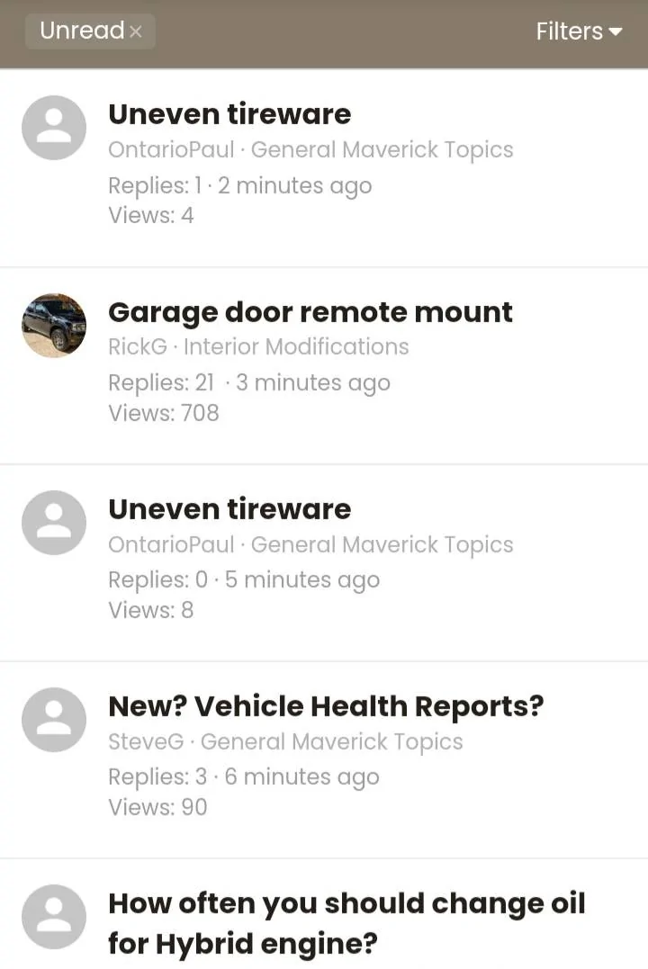

Anyone having problems with uneven tire wear on their Maverick.
I have a 2023 hybrid tire pressure is Good and have no damage, not even driven off A curb. Tires have been rotated regularly and i have a total of 60000 km. Rear passenger tire has bad wear on the outer edge alll the other tires are fine.
You may want to have the mods combined or delete one of your threads as a duplicate
