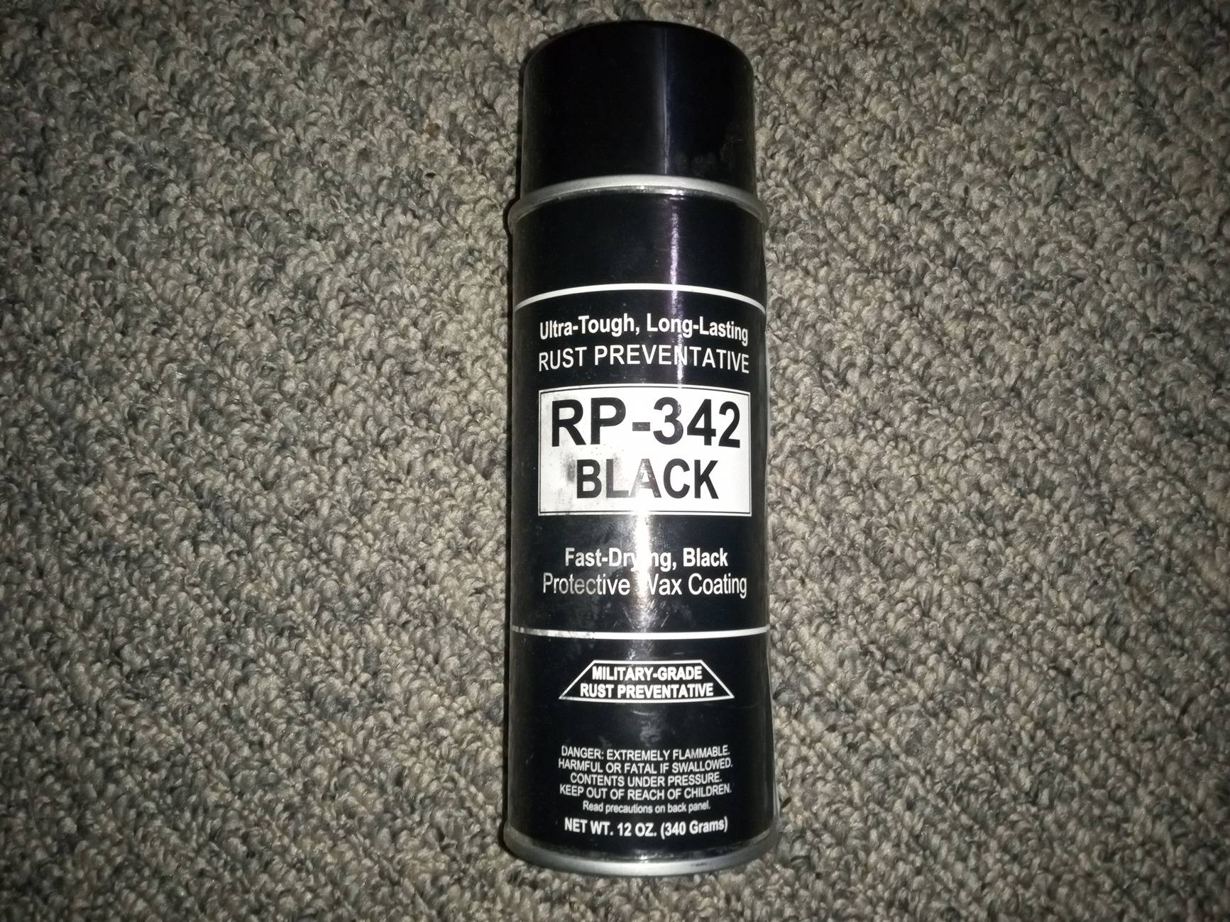

I bought some spray cans of undercoating from Amazon for my Maverick when it comes in
