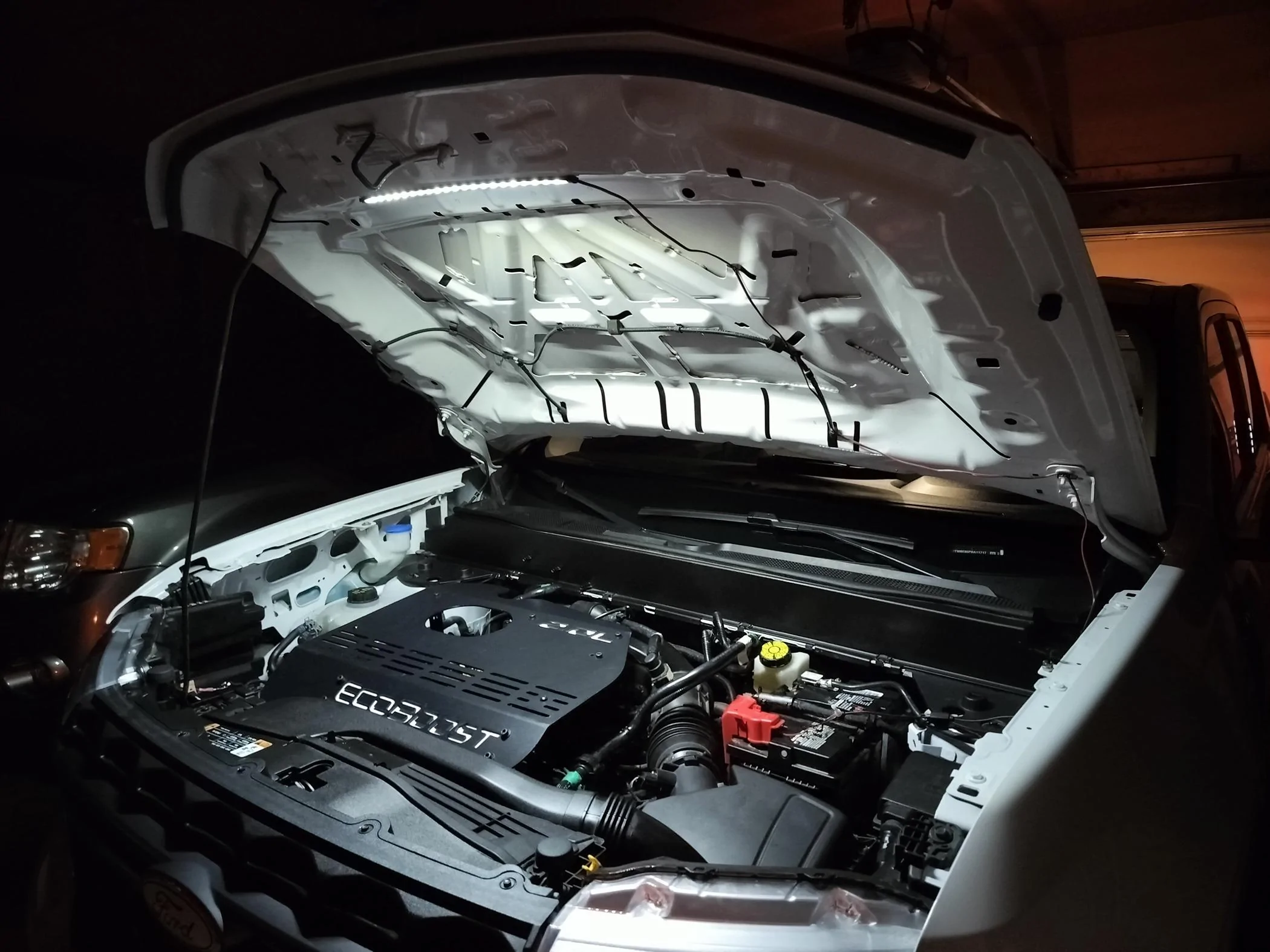

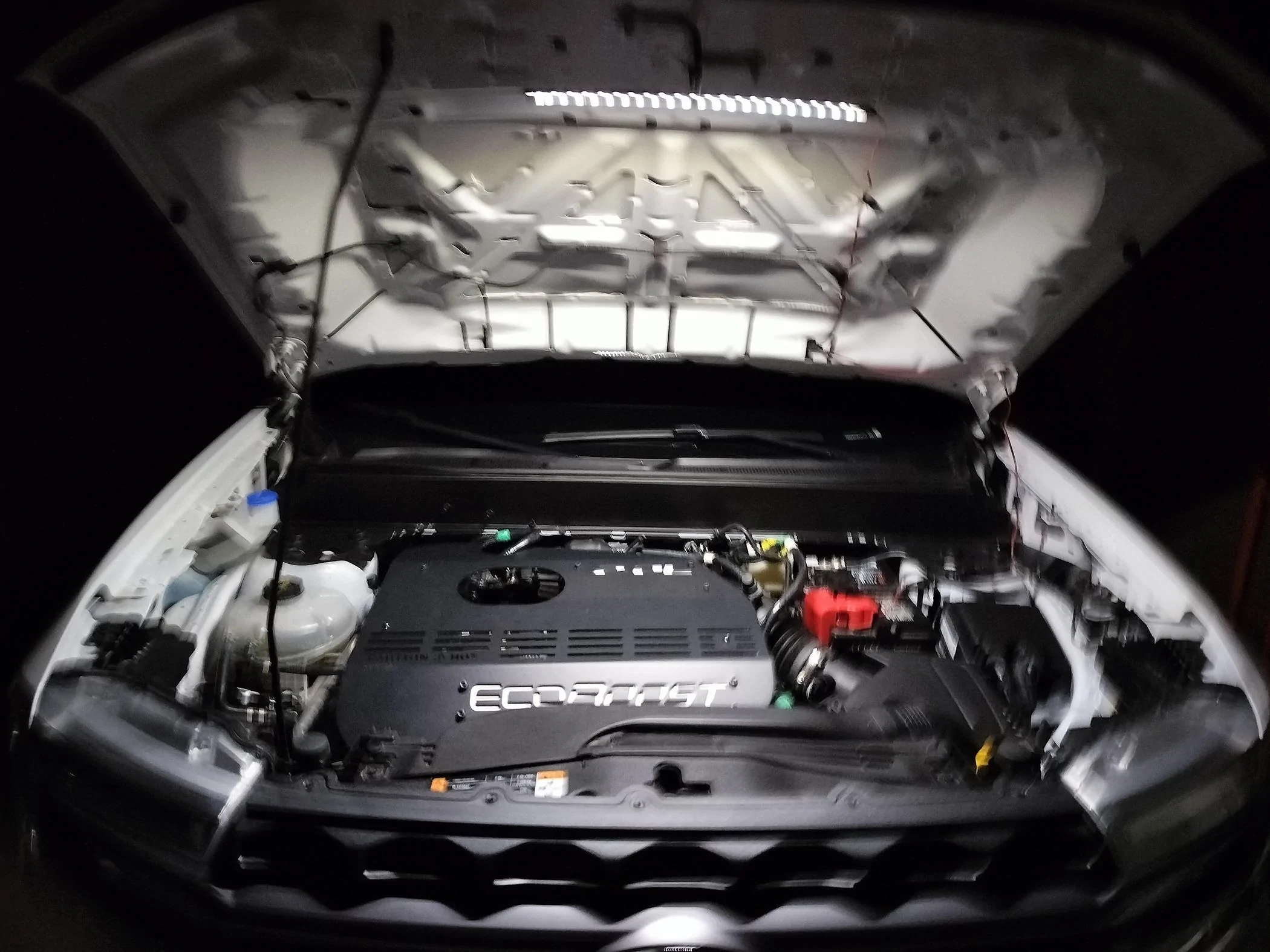

Got my LED underhood light installed today and took about 10 mins. It makes a big difference now that I can see when working under it and it's bright .
Ford Maverick Under hood Light installed photos IMG20240621203724
Ford Maverick Under hood Light installed photos IMG20240621203709
I know Ford is cutting back on cost so I did it for $10. Great improvement.

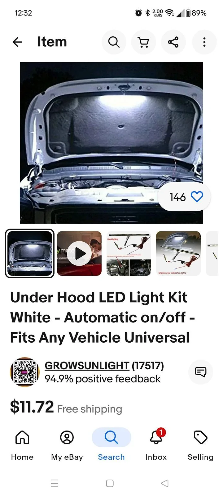

Hello, I got it on eBay. It's so easy to install only 2 wires. Red to battery and black to terminal on the pressure switch that comes with it. Here is a screenshot of the one I got. Good Luck
Ford Maverick Under hood Light installed photos Screenshot_2024-06-22-00-32-23-01_260528048de7f2f358f0056f785be619
Many thanks!

Hello, yes it is on a pressure switch that you can install anywhere the hood will make contact to stop power to it. If you look at my previous 2 pictures in the 2nd one I installed mine on the edge of the driver's side fender in an open hole . Also just 2 wires, 1 battery and 1 to the switch. It has a built in fuse also. Very simple to do. Got it from eBay . Good Luck
