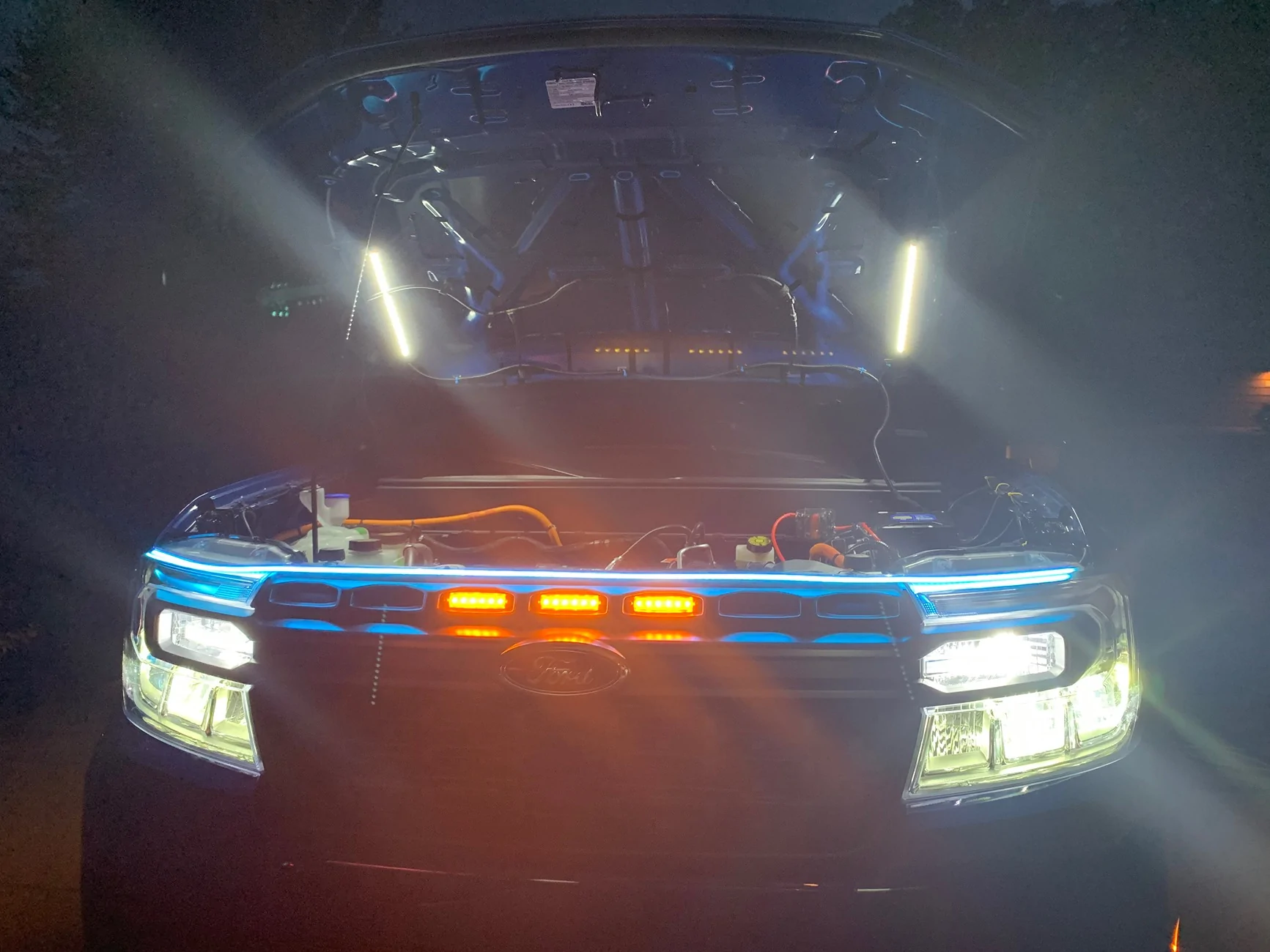

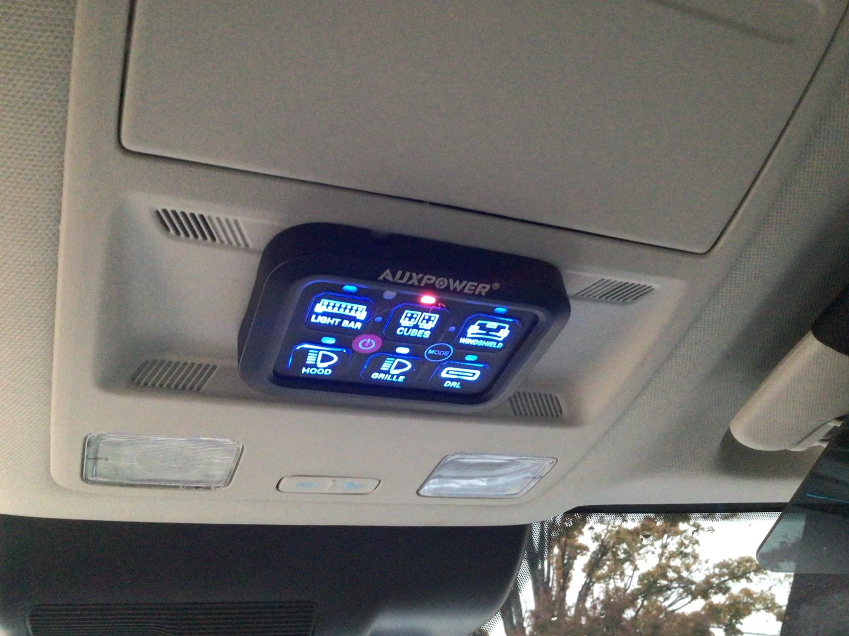

An easy and inexpensive mod. AliExpress offers dozens of options. I ordered a double LED strip kit that included a plunger-type on/off switch. I choose not to use the included switch. Rather, I wired the strips to an overhead switch panel controlling all my added external lighting. Even easier would be to use LED light strips or pods controlled by a remote.
