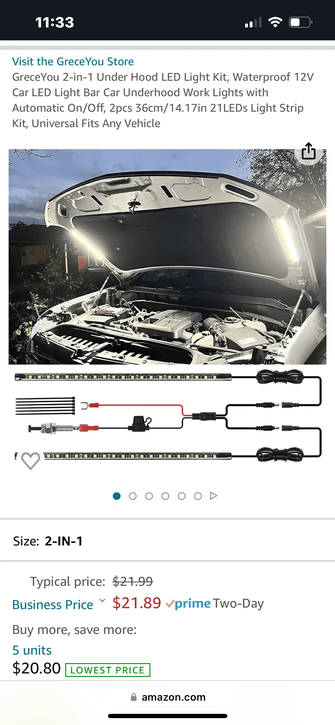

First of all if your reply is “Why?” then please move along . This is for those who wrench on their trucks. It may even come in handy if you break down on the side of the road at night.
$20 bucks on Amazon, maybe 15-20 minutes to install. Two wires. Cheap, Quick, and Easy.
Ford Maverick Under hood lighting 9ADF4CB2-9E36-4F9B-9311-A17D7554E333

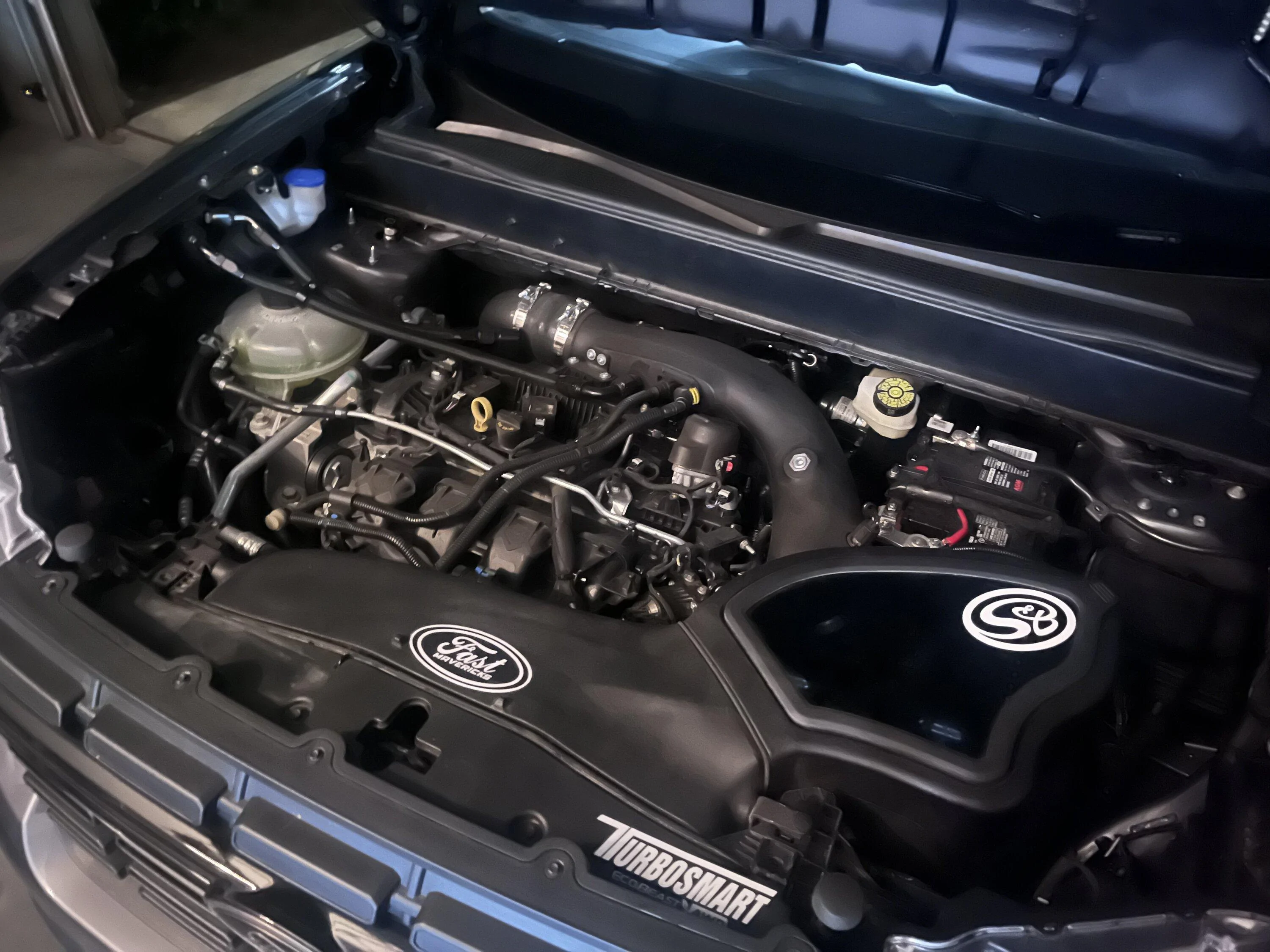

Before, no lights.
Ford Maverick Under hood lighting AA521456-3911-456A-83B3-F22301CD4F4E
Ford Maverick Under hood lighting 6F4B4E4A-C6E9-4305-B602-A1608948A873
Ford Maverick Under hood lighting 1472670E-352F-4375-A2C3-7DC5305BEE09

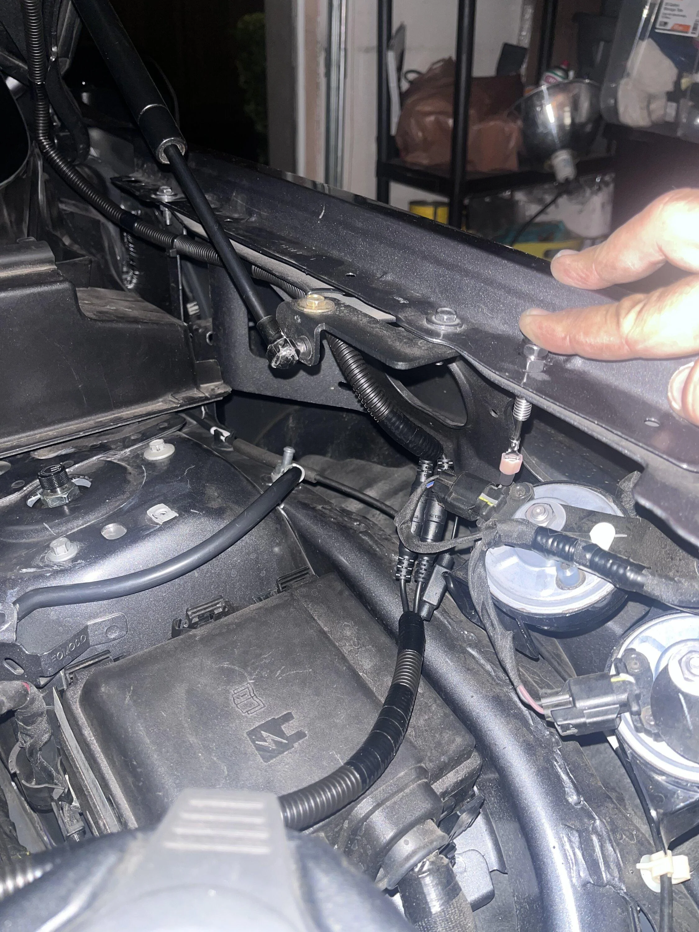

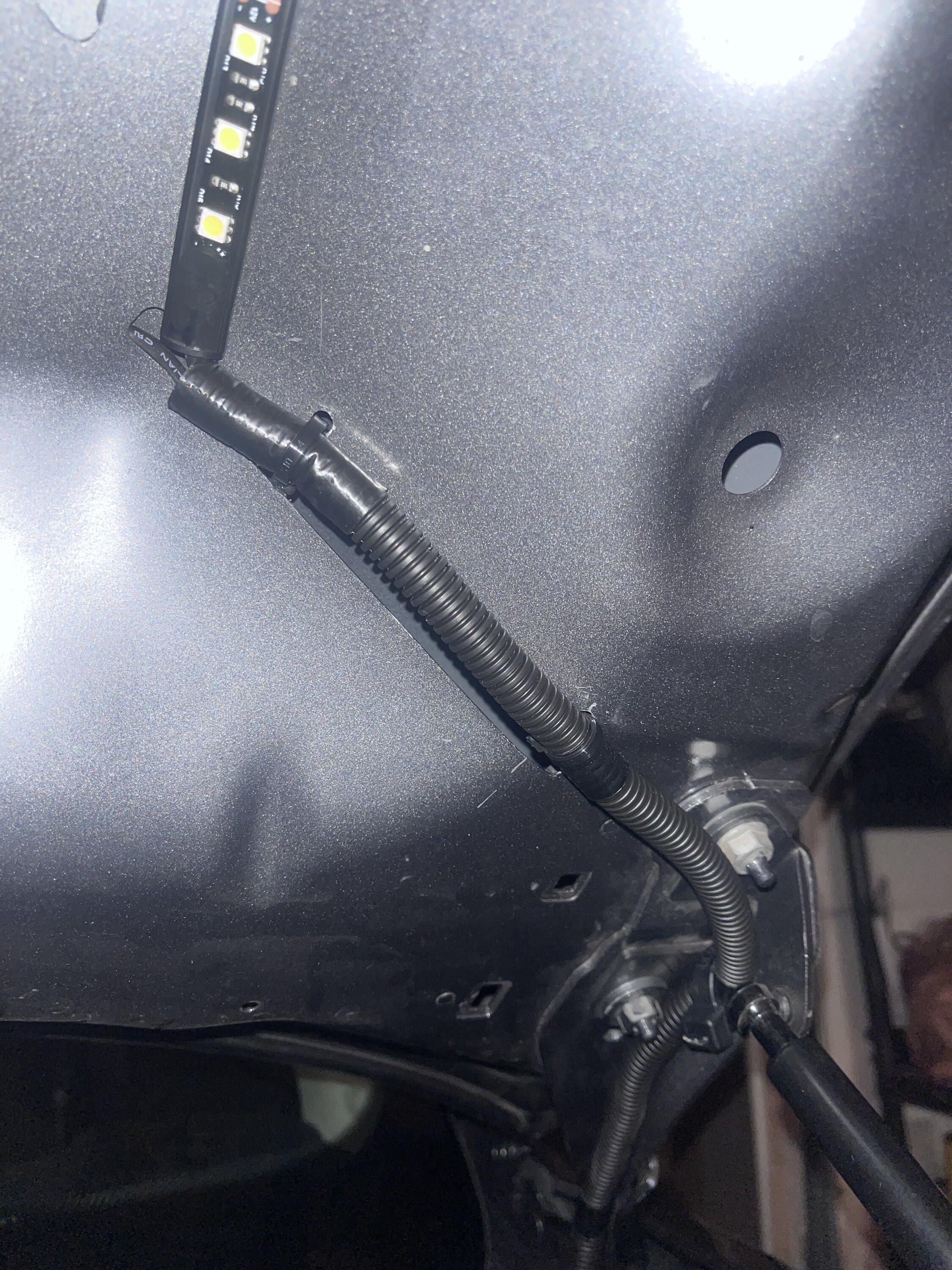

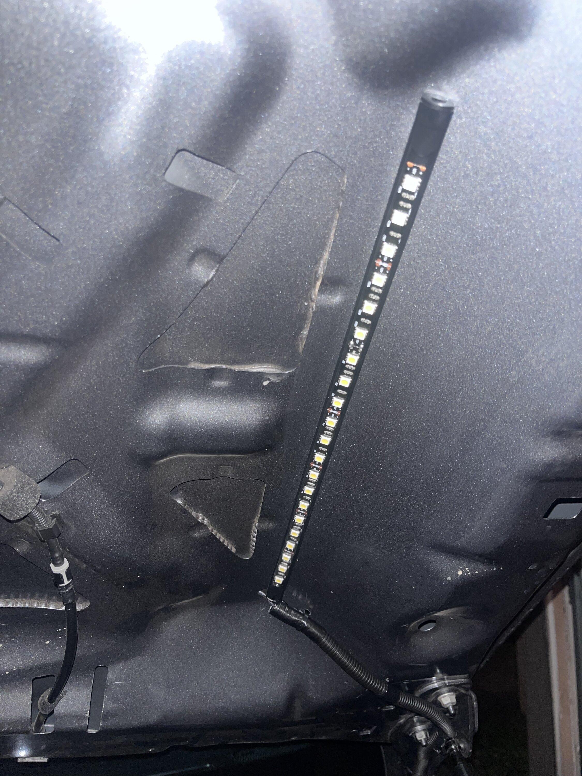

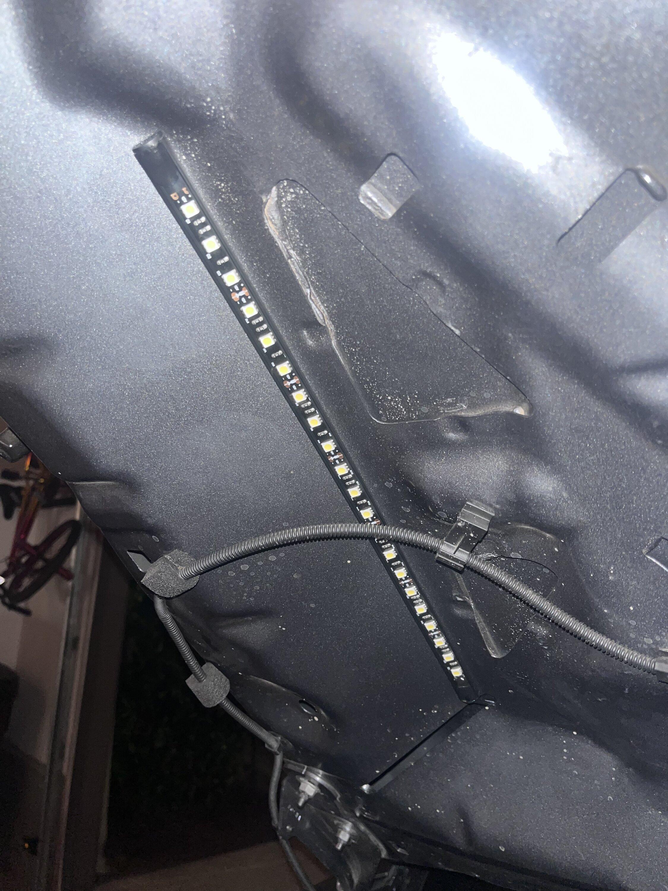

Attach a strip on each side. I ran the passenger wire through the holes and wire loomed them down and to the driver side by the fuse box.
Ford Maverick Under hood lighting 945A98DC-EB4E-4A83-9431-A49FB16B77F7
red wire to battery, black to the push switch. Used an existing hole and tightened the nuts.
Ford Maverick Under hood lighting 3233A473-146B-441C-9258-644FA460B11F

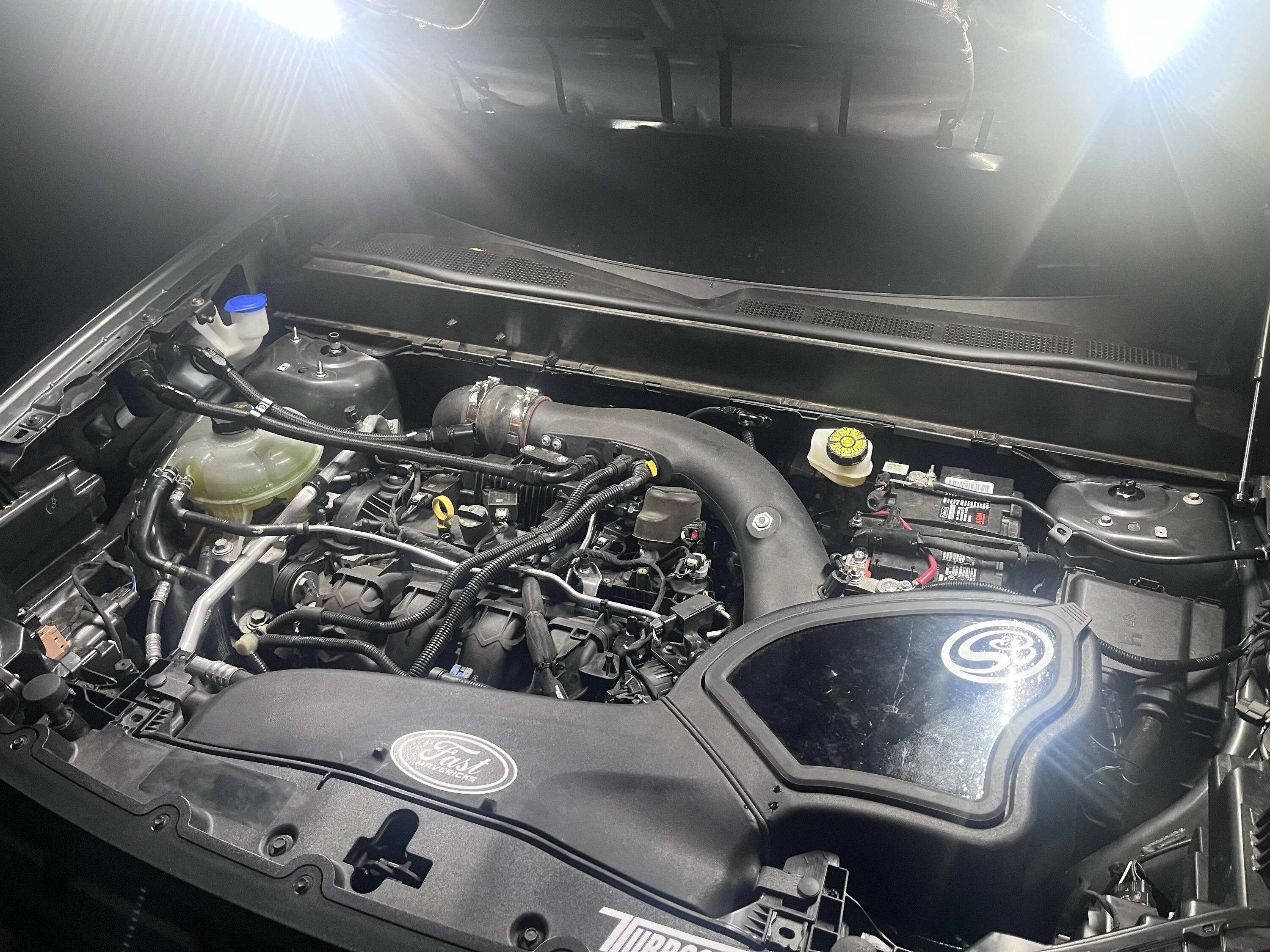

Done!

Hey how is the light holding up for you? I'm thinking of grabbing one of the single strip versions.
Not a single problem. Just make sure you align the push button correctly so the hood pushes it down enough to ground or you’ll wake up with a dead battery

Does the center of the hood get lit up well even though the strips are on the sides ? Thanks.
