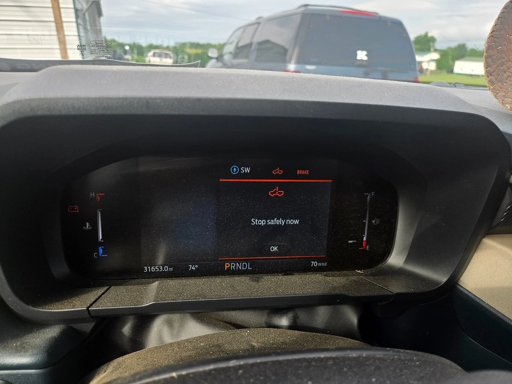

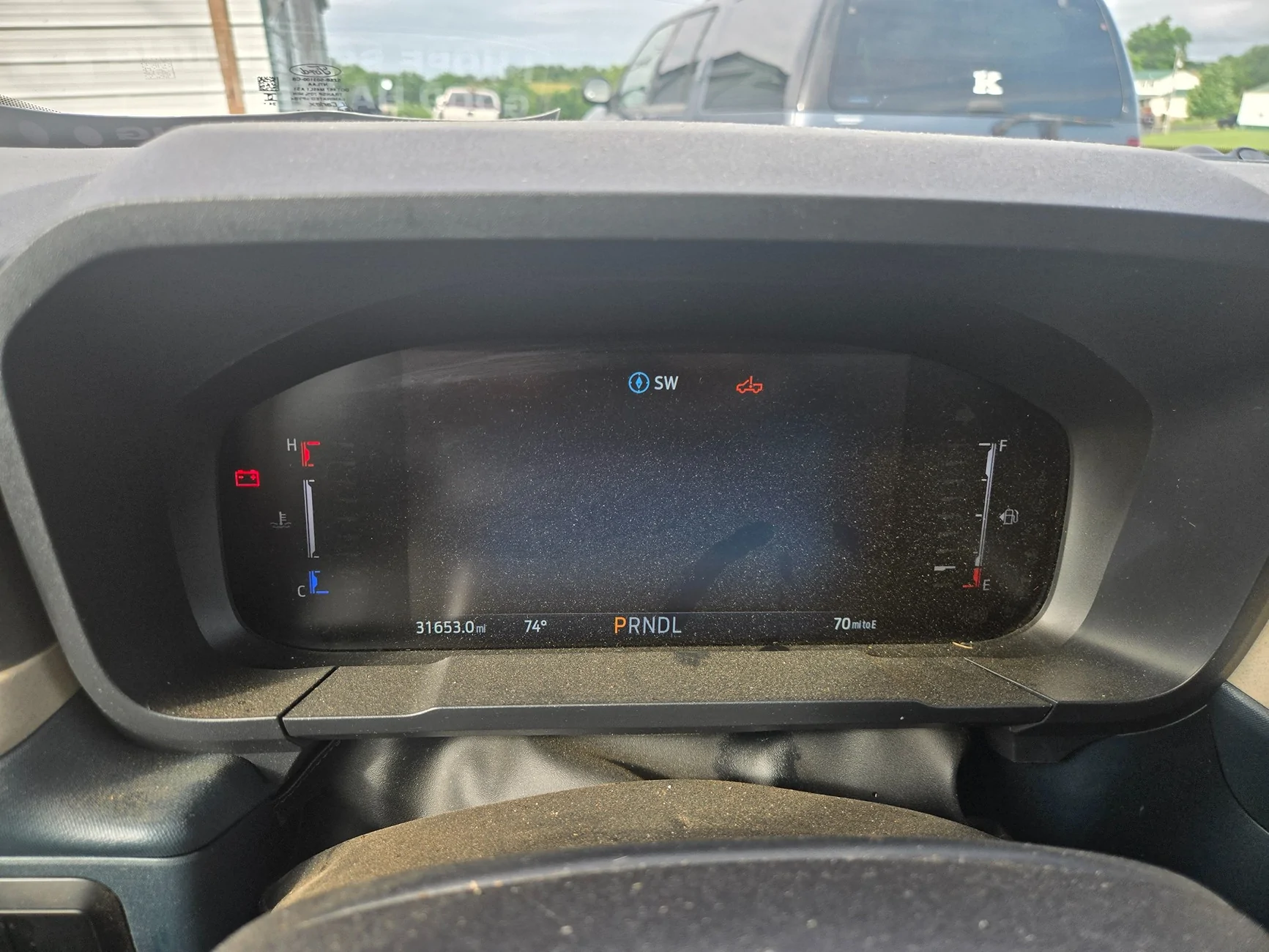

Wow, this takes the cake! My '25 Hybrid AWD Lariat locked itself up in full accessory power on mode when I went to start the truck. It won't start, it won't shut down. The battery light is on and a symbol of a red outline truck with an exclamation mark on the middle. A warning told me to stop the truck. Hell, it never started to move!
For two weeks I have been calling a Ford dealer to schedule service with no call back. The 120vac went out and the rear brakes give out during moderate braking. I mean a solid lurch in the truck like I took my foot off of the brake pedal, but I'm pushing it and now suddenly pushing harder to stop where I intended to. I hear a clunk in the rear end.

I do like my Maverick but this thing is full of glitches and bugs! I just had two recalls performed earlier this month. It sucks that I have to leave this truck on and in the way. Boy a wrecker is going to have a fit trying to get to this truck after all this rain!

A ScanGauge would be handy to have in this case, as the clunk is known to be part of the AWD system (if you have it), but the lurching comes from the hybrid system very suddenly deactivating due to HV battery weirdness, and that you can see in HVB voltage and amperage readings. My theory (I wasn’t able to definitively test) is that Ford has a bad batch of contactors out there.

Mostly happy motoring. I came back 30 min later and the display was off. The truck fired right up with some message on the radio that I didn't catch. It looked like a download progress screen then disappeared. I have the truck set to perform updates at 1am so I don't think that would have been it. No check engine light, no warnings so I filled up the gas tank.

Yeah, my confidence level in this truck just took a severe hit. The shutdown timer was still operable, so the truck shut down after 30 minutes. Once it was off, the issue reset.
I suspect the can bus dropped out or a module lost communication. Due to my work/life schedule, I can't unload and surrender the truck until Wednesday at the earliest. Regardless, it's going back to Ford for a while.
