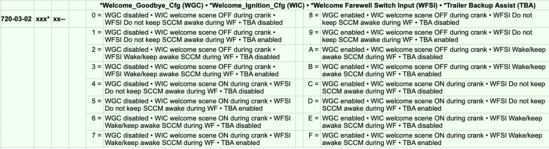

What was modified, IPC? "720-10-02" back to whatever factory?

can you send me your vin in a private message if you want. im going to compare your original IPC to mine to see how it differs and try to narrow it down the coding that way.

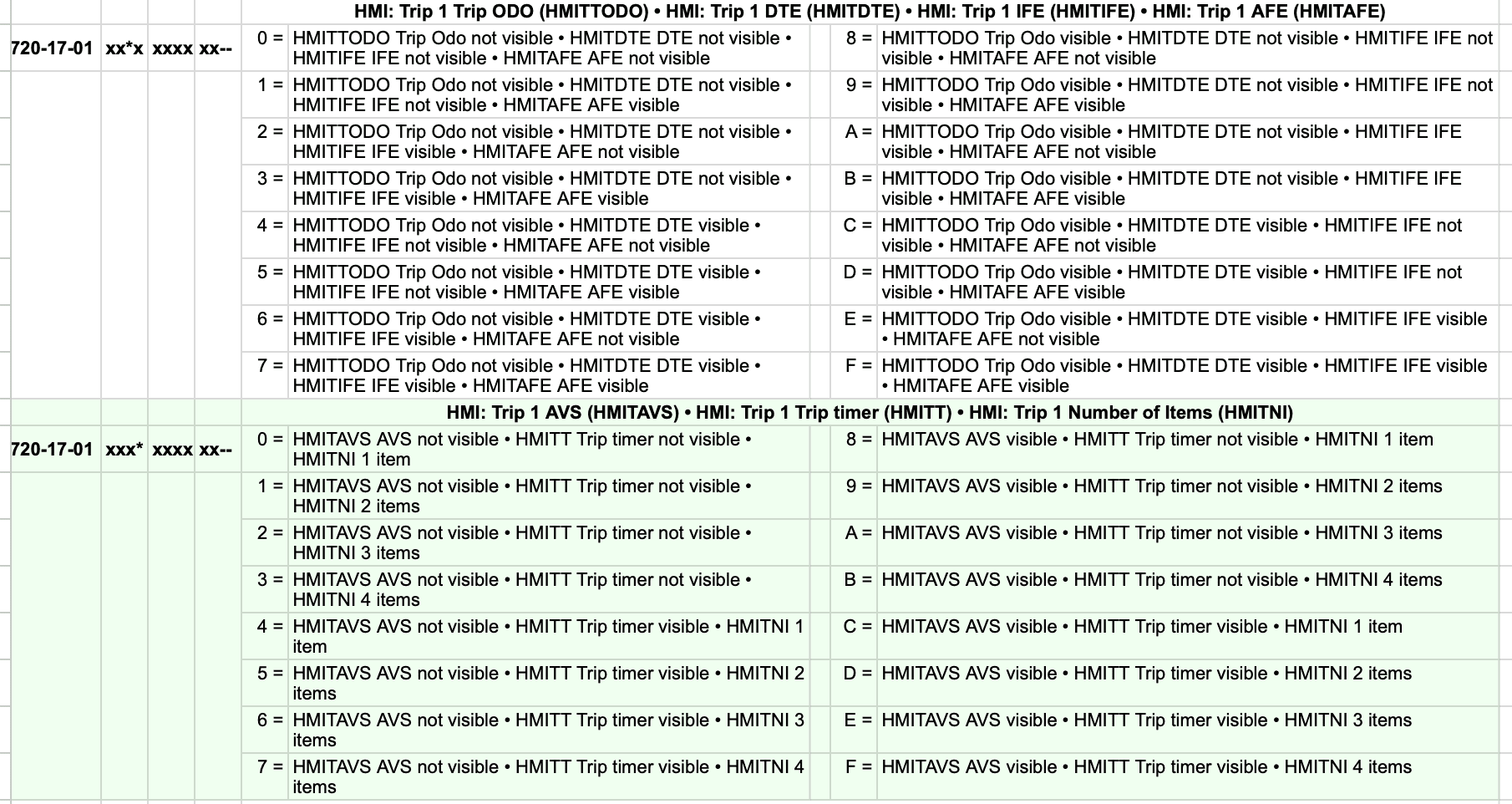

Did you ever find a fix for the trip settings disappearing. I added LKA to my Hybrid and the same after trip display is black accept for total odometer mileage at the top left. I also noticed that it changed one setting in my TSR Forscan hack. Had to go back in and enable one setting to get it to work again. Both now work fine but missing the recent trip display like inline_5
Figured it out after I read on further!
