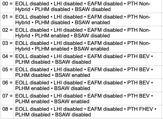

08 Hybrid VS 01 Ecoboost. This is what was messing your coding up on 720-10-02.

So trip report would be PTH FHEV I guess?
yeah it seems like FHEV enables this trip menu and maybe other things specific to the hybrid cluster. Also, I ordered my XL with co pilot 360 option from the factory and it has cross traffic alert enabled that comes with it. My coding matches the OPs in that DIY for 720-10-01 from the factory.
