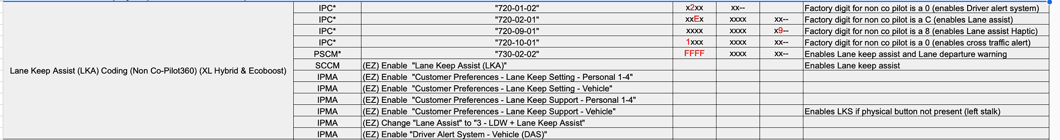

SO I double checked some of the coding from that link and a few of the codings are completely unnecessary and may cause other faults and some codings are missing. I made some corrections and made new instructions. @TrailMaster try these codings pictured below.
I also kept the EZ mode instructions and believe it does work now that I added the driver alert codings to it.

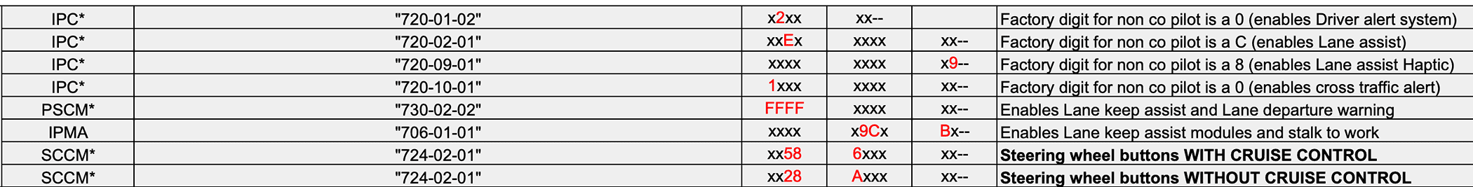

I updated the spreadsheet to reflect that link almost exactly. @TrailMaster Can you confirm your coding matches the picture of the instructions below at some point? Just so I know I have it written correctly for other people to use in the future ! Thank you
