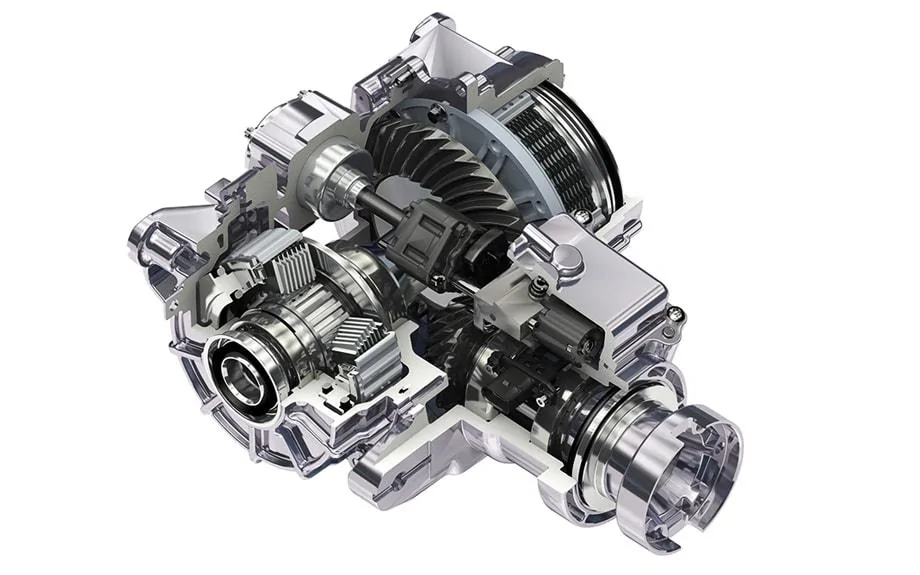

kind of looks like a wet clutch set up to me. notice the multiple plates, looks a lot like a wet motorcycle clutch.
I apologize - I stand corrected, but heat continues to be an issue even in the cold.
The standard AWD Mav uses a single dry clutch.
The Advanced AWD on the Tremor uses a liquid cooled PTU clutch:
" The Badlands (and the low-volume First Edition) adds liquid cooling to the PTU and a second clutch to the RDU, providing a “differential lock” feature, as Ford calls it. This is different from a real mechanical locker, but the point is that the rear drive unit can keep powering both wheels even when one has little grip. The schematic below shows the basics of the Badlands’ off-road system"
In their testing, they show that the standard Mav will overheat when calling AWD too frequently and disable:
While on the trail ride in a group, the driver of an Outer Banks model attempted to ascend a hill. After just a couple of failed attempts to climb the rather modest incline, she said over the radio that her vehicle indicated Four-Wheel Drive Temporarily Disabled.
The Ford rep pointed out that the Outer Banks model does not have the Badlands’ liquid-cooled Power Transfer Unit (a Ford engineer told me that this is cooled via coolant in the engine’s cooling loop), but CNET’s review indicates thermal concerns with even the Badlands model. From CNET:
Unfortunately, after 15 minutes of hooning around in the sand, my Bronco Sport overheats and goes into limp-home mode. I might expect this if ambient temperatures were very high, but it’s a perfect 82 degrees Fahrenheit. Thankfully, the Bronco cools back down quickly so I can keep on playing — albeit a bit less aggressively.
Driving on loose terrain is extremely taxing on vehicle thermal systems. The slippage leads to a lot of fluid churning. When there are clutches involved, those can get hot, and their function can degrade, causing slip. There’s also quite a bit of engine load and engine speed, which means the potential for a lot of heat rejection in a sandy dune environment. Since the tires are slipping, these conditions tend to correspond to low vehicle speeds, which also means there’s low incoming air velocity and reduced cooling capability.
Still, overheating after just a couple of attempts on a freezing cold Michigan day? Overheating after just 15 minutes of sand driving with 82 degree ambient temperatures? I’m not going to harp on about this since I didn’t experience a failure in my vehicle, but as a former off-road cooling system engineer, I’ll just say: That would be pretty wack if it turned out to be a common issue.
https://jalopnik.com/the-2021-ford-bronco-sport-has-everything-it-needs-to-c-1845821988

I think the heat issues that circulate the web are actually the PTU, even with the cooling, and not the RDU. This is a common issue with the Subes and the like. This normally occurs on up hill climbs in the loose stuff or going hog wild in the sand. Since this RDU is the same unit as in the 350HP Focus intended for some track use it should be able to do off road without issue in the Mav.
https://mavericktruckin.com/tech/fords-dana-twin-clutch-axle-awd-system/

Yeah - sorry was specifically meaning the PTU for overheating issues. The RDU should never really be used to an extent where it would overheat.
I'm not dogging the system - just what I had seen previously on the Baby Bronco.

tremor ptu main difference is that it's liquid cooled which allows the multiplate clutch pack to stay energized longer before overheating. without the clutch pack engaged any AWD Maverick is using fwd only.
tremor (and lobo) rdu is radically different than other AWD models.

Currently, the Ford Maverick Tremor is the only Maverick model that comes standard with an intelligent all-wheel drive system featuring a torque-vectoring rear differential, making it the only Maverick with a dedicated off-road capable AWD system; other Maverick trims may have AWD options, but they won't have the same advanced off-road capabilities as the Tremor package. Sorry sir but you are wrong.

the status screen in any AWD Maverick literally says intelligent awd. Ford has used that terminology for many years predating the Tremor Maverick. here's an article about it. https://www.willisford.com/ford-int...D is an,to provide optimal power distribution.
that blurb you posted is talking about the torque vectoring rear differential. that's the piece that is special, but you don't need that to have intelligent awd.
because articles don't get updated, that part can't say what I did above which is the new Lobo has that same differential.
