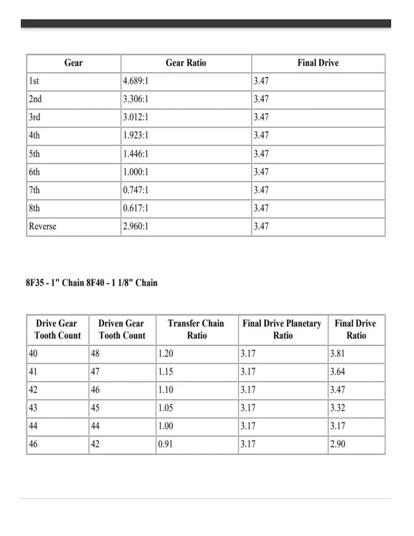

As it turns out the final drive ratio has nothing to do with the rear but everything to do with the drive and driven gears in the transmission. What they will include on the Tremor rear I have no idea but all rears are the same on 2022 models ecoboost or hybrid and have a gear ratio of 2.58. I haven't looked at the hybrid transmissions yet but the 8F35 on the ecoboost engines are set up the following way.
The final drive for all gears including reverse is 3.47 to get to final gear ratio and available ratios is the following according to the service manual.
The 8F35 uses a 1 inch drive chain between the drive and driven gears and they are spec'd as follows. To change the existing gearing you'd need to remove the transmission, then the torque convertor, then the torque convertor housing cover. Now you can get to those gears and swap them out with the appropriate gears assuming you can find them for sale to change the final drive gear ratio. Unless they change the transmission these are the actual available final drive ratios and the way to get the 3.81 final drive gear ratio that is used on the Maverick 4k tow package and Bronco Sports.

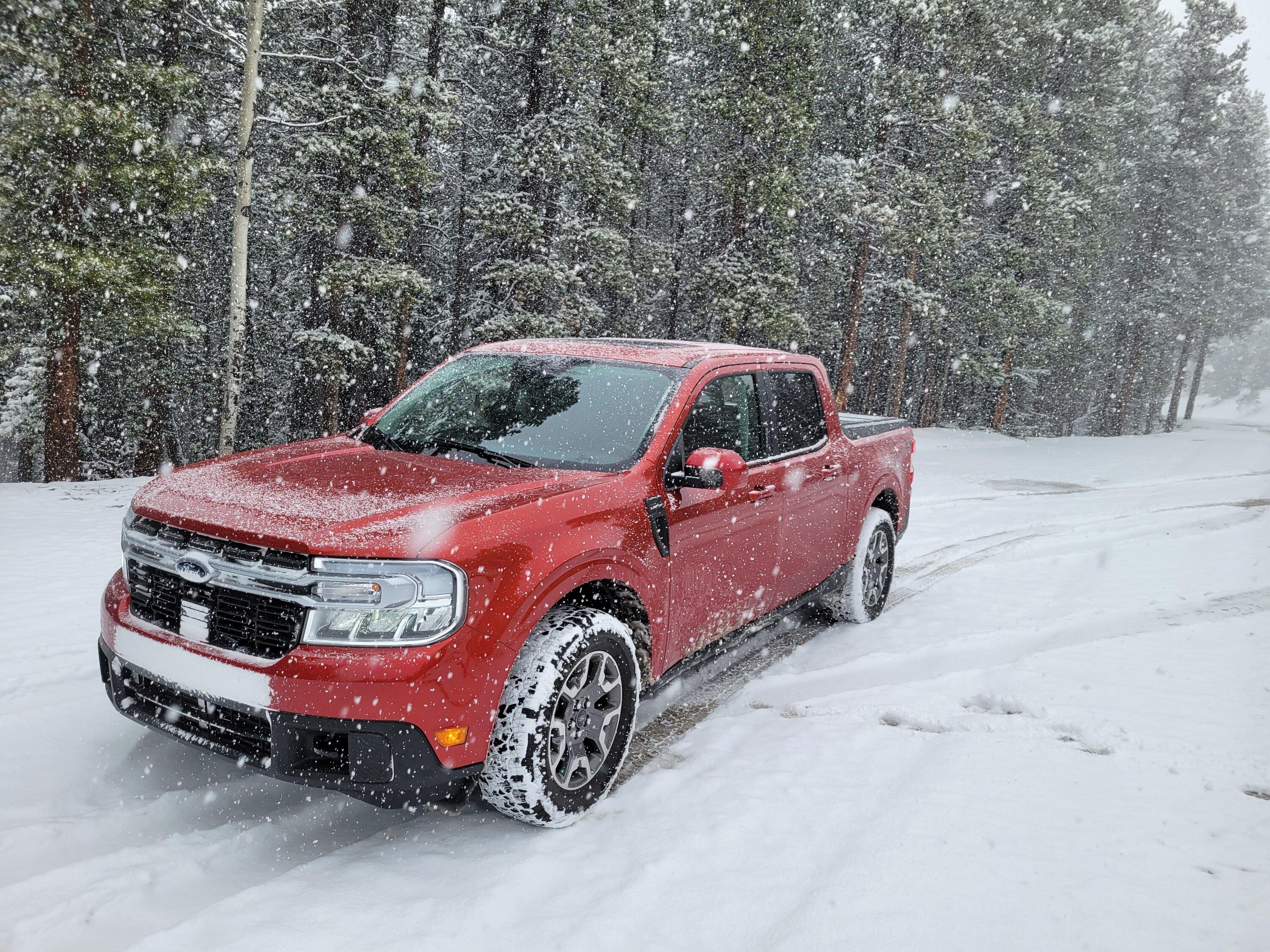

I found my 2006 Kia Spectra (FWD) can make the trip to any ski-resort in Colorado - regardless of the weather and road conditions. It's old enough it doesn't even have ABS or traction control. Snow tires, intelligent driving and judicious use of a low gear is all you need. (And maybe a little help from the snow plows keeping the snow from piling up too high)
With that as a frame of reference - the Tremor will provide zero advantages - ZERO - if your only goal is to tackle snowed out roads getting to the ski resort and perhaps getting through a poorly plowed parking lot.
We had some late season snow in April last year and I had a chance to take my 4WD/4K Mav up some mountain roads through some heavy, slushy snow.
With the Wildpeaks it did quite admirably. Up grade, off road, in the slush - from a dead stop - it had no problem.
Photo below is sort of early in the snowstorm, it continued dumping quite a bit!
