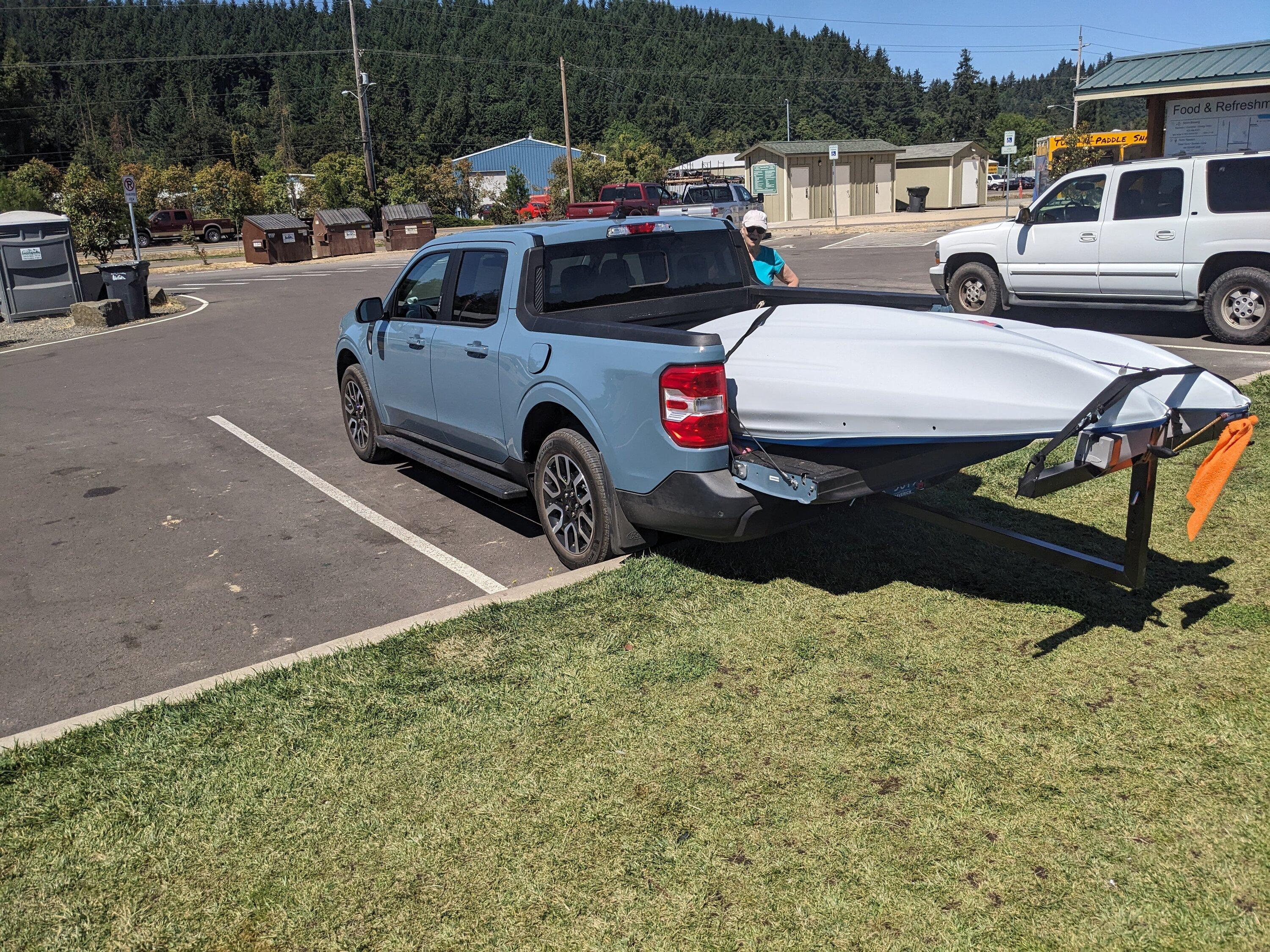

I also used the Harbor Freight bed extender to haul two 10 foot kayaks in my 23 EB. I have the factory installed hitch. I had zero in the way of problems. I don't think they make a stronger hitch for passenger vehicles. The installed hitch should carry anything your vehicle can tow.
Ford Maverick Trailer Hitch Class bed extender question Maverick Kayak carry 1
