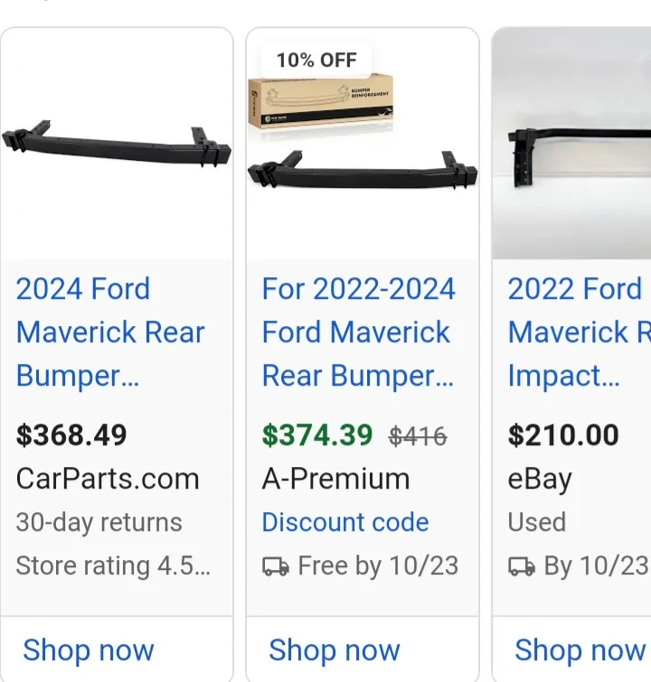

Norm,
In order for the hitch to be removed.
You have to remove the bumper.
Once the hitch is removed, pictured on the left. The OEM hitch HAS the crash bar incorporated into it.
You have to purchase a crash bar, pictured on the right and reinsert it into the frame mounting areas and then reattach the bumper.
Good Luck.
Ford Maverick Remove trailer hitch Screenshot_2025-10-14-18-56-14-47_40deb401b9ffe8e1df2f1cc5ba480b12
Unless you trade with someone.
The price for a replacement crash bar, even a used one is little high.
If you can't find someone to trade with. You can recoup some money by selling the hitch.
Ford Maverick Remove trailer hitch 20251015_084841
Removal of the hitch may affect resale or trade in a negative way.
