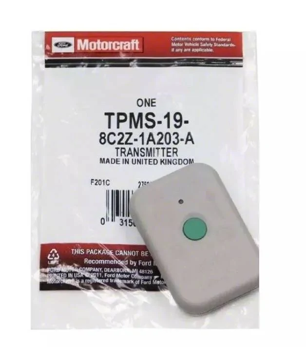

So this resets the tpms sensor in the wheel?
There is a unique sequence of pressing the brake and turning the ignition that puts the vehicle into a learning mode. It then instructs you to go to specific corners and press the button near the valve stem to relearn the sensor.
Ahh ok I see now .
I did change wheels and bought the correct mhz sensors but they won’t program with the regular sequence of letting air out at the proper times notified by the dash.
