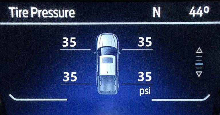

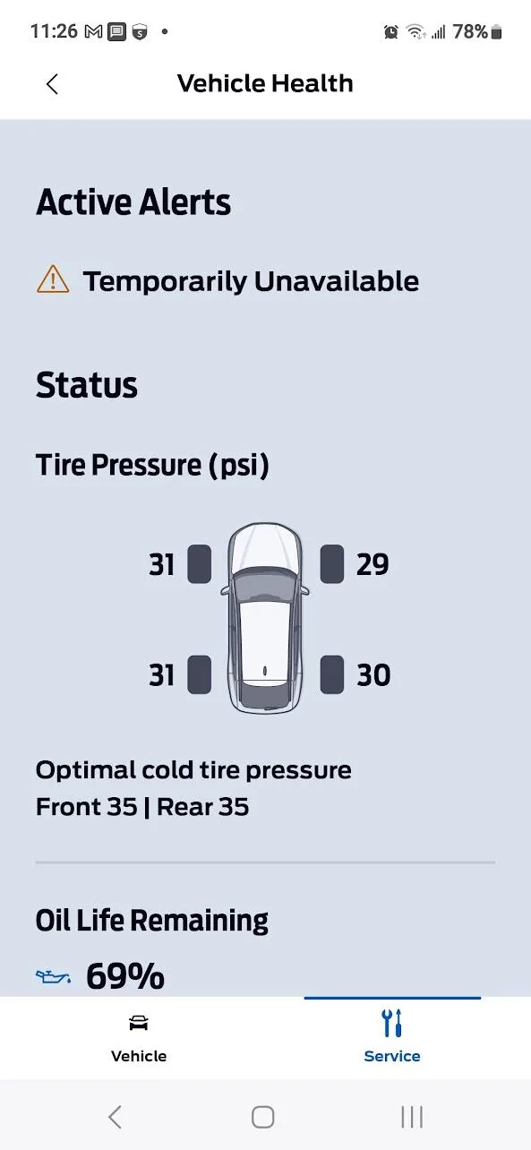

Anybody experience this, almost daily notification from Ford Pass that I have tire pressure problem but no indication on dash that there’s an issue?
Tire pressures always check out good at 35psi.
Is there an easy check to see if each individual tpms sensor is good or am I stuck with the dealer, just thought I’d ask before I go to the dealer. Thanks Ken
Get a quality digital meter that reads in tenths of a pound and verify how close the dash figures are to the digital readings.

I do and they will be going on the truck probably in a few weeks as the white stuff is coming soon but this problem only just started about 2 weeks ago so?
Thanks everyone for your input I’ll post when I find the solution.
TPMS follow up
Put on my snow tires that have my original Ford rims and sensors, haven’t had any issues since.
Problem appears to be with the aftermarket TPMS sensors I had fitted when I purchased my new rims!
