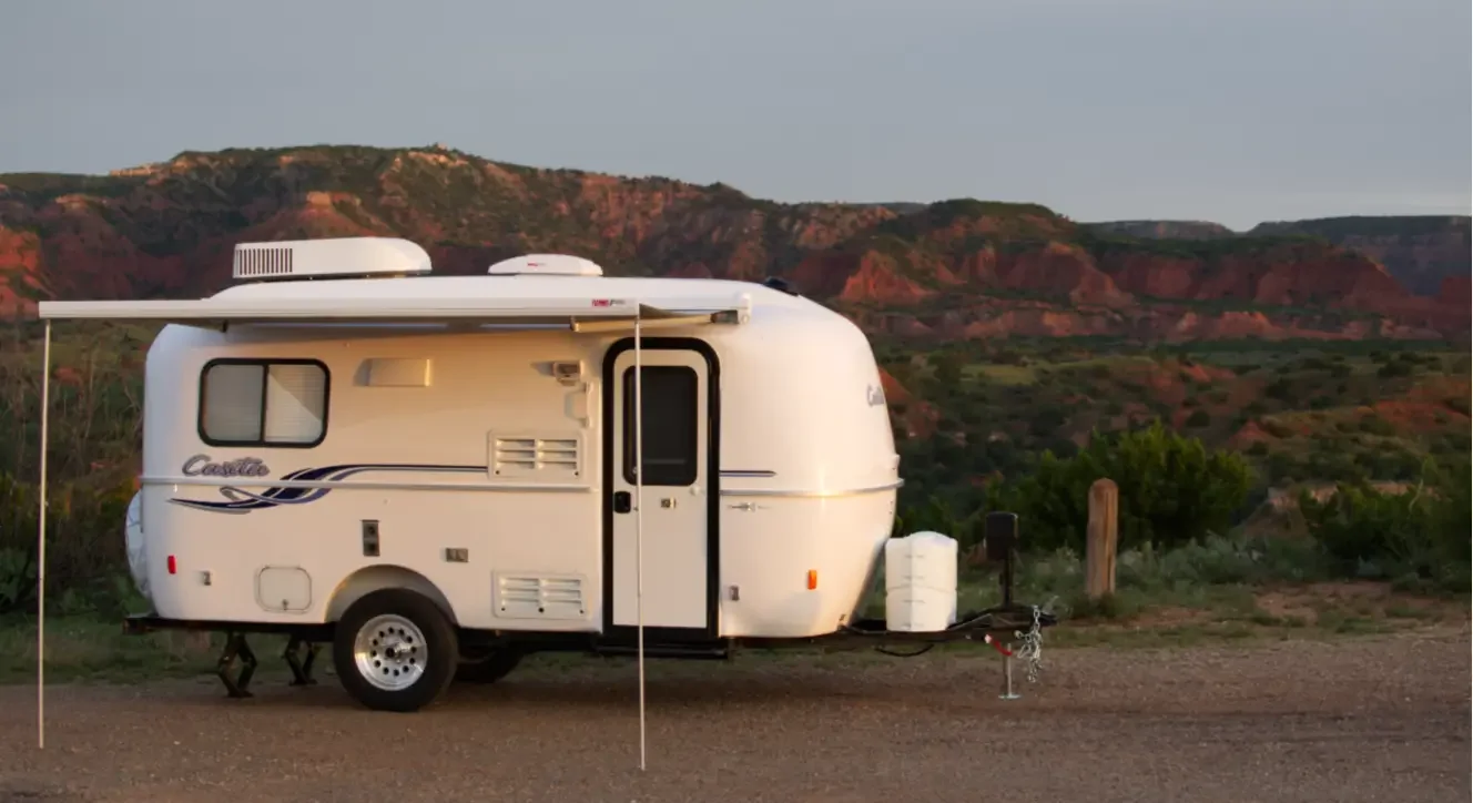

I stand corrected on the Casita Spirit Deluxe, the dry weight is 2,210 and hitch weight is 280. Should be no problem for the Maverick with the 4K tow package. Here is a picture of it.

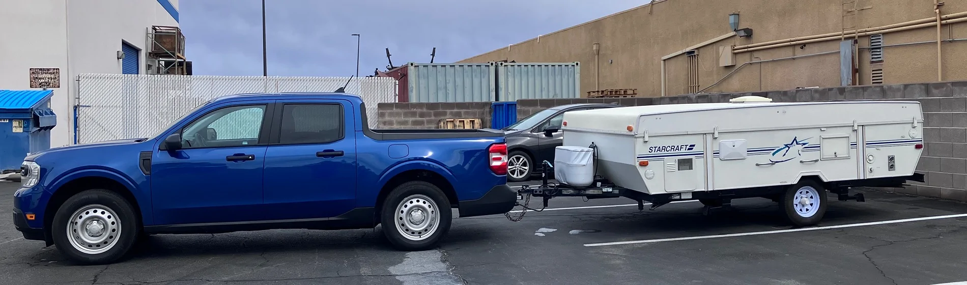

I love my pop up.
Ford Maverick Towing with Maverick Hybrid IMG_3481
This tows great 2023 XL Hybrid FWD. Right at 1800 lbs dry. This has no wind face behind the truck. I have pulled this from Las Vegas to San Diego (Anza) area several times. Have had no issue with towing. Climbs up Calhoun pass and the grade out of Baker with no issues even in the triple digit heat while still maintaining traffic speed. At traffic speed mileage is about 20 mpg. Way better than the 2006 F-150 at 12-14 mpg. I added a 7 pin connector and powered the charging pin from the bed accessory port and use the Curt Echo blue tooth plug in for brakes.

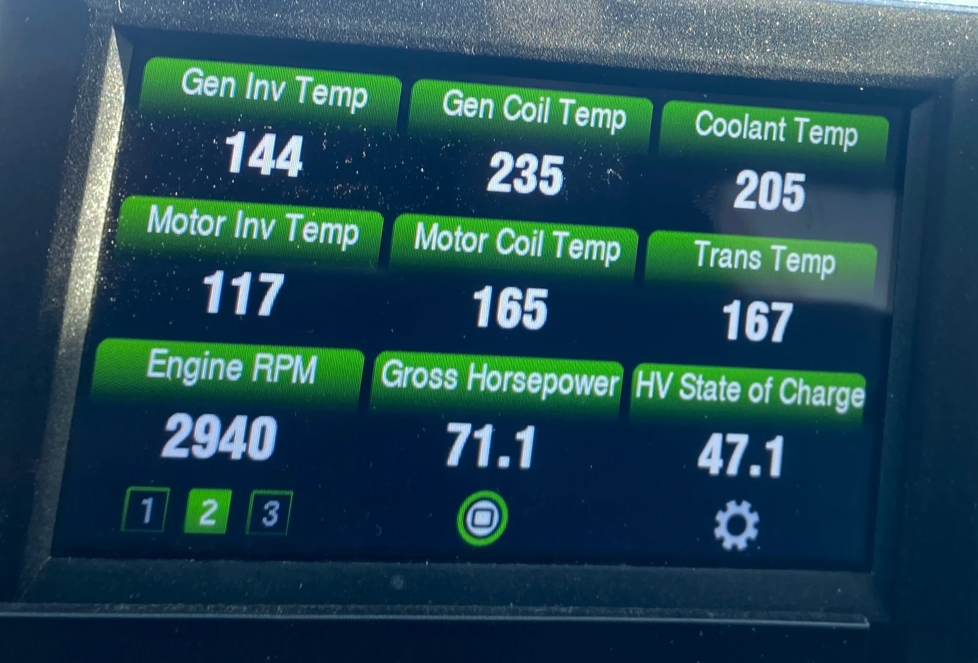

Just towed 3000 lbs. uphill on a 108°F day. Transmission oil peaked at 167°F.
Most of the day it was in the 150's.
Engine water peaked at 221°F
Battery peaked at 122°F
Traction Motor peaked at 225°F
(Got a too hot message at 265°F on a different trip.)
Generator peaked at 245°F but I have seen 265°F with no message on a different trip.
GET A SCANGAUGE to see real temperatures in your truck.

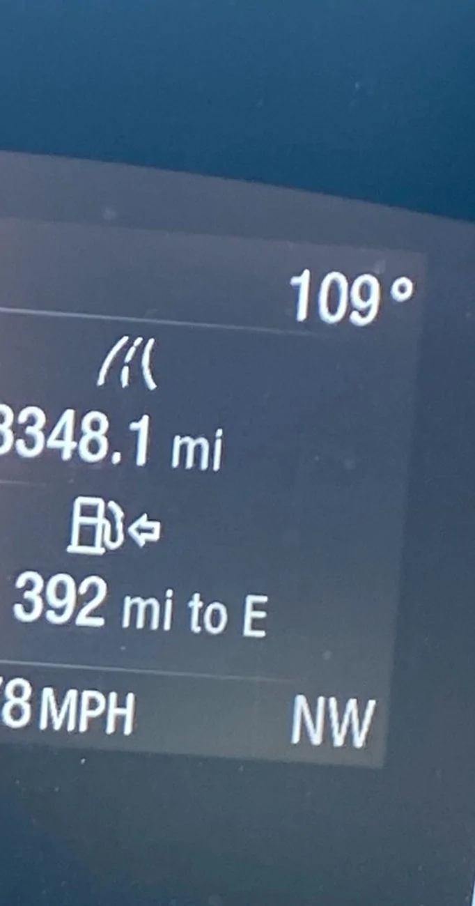

I took this photo because I was towing.
It was 108-109°F out.
And this was the warmest transmission oil I have ever seen in 4 years of ownership with 3 dozen trips towing big stuff.

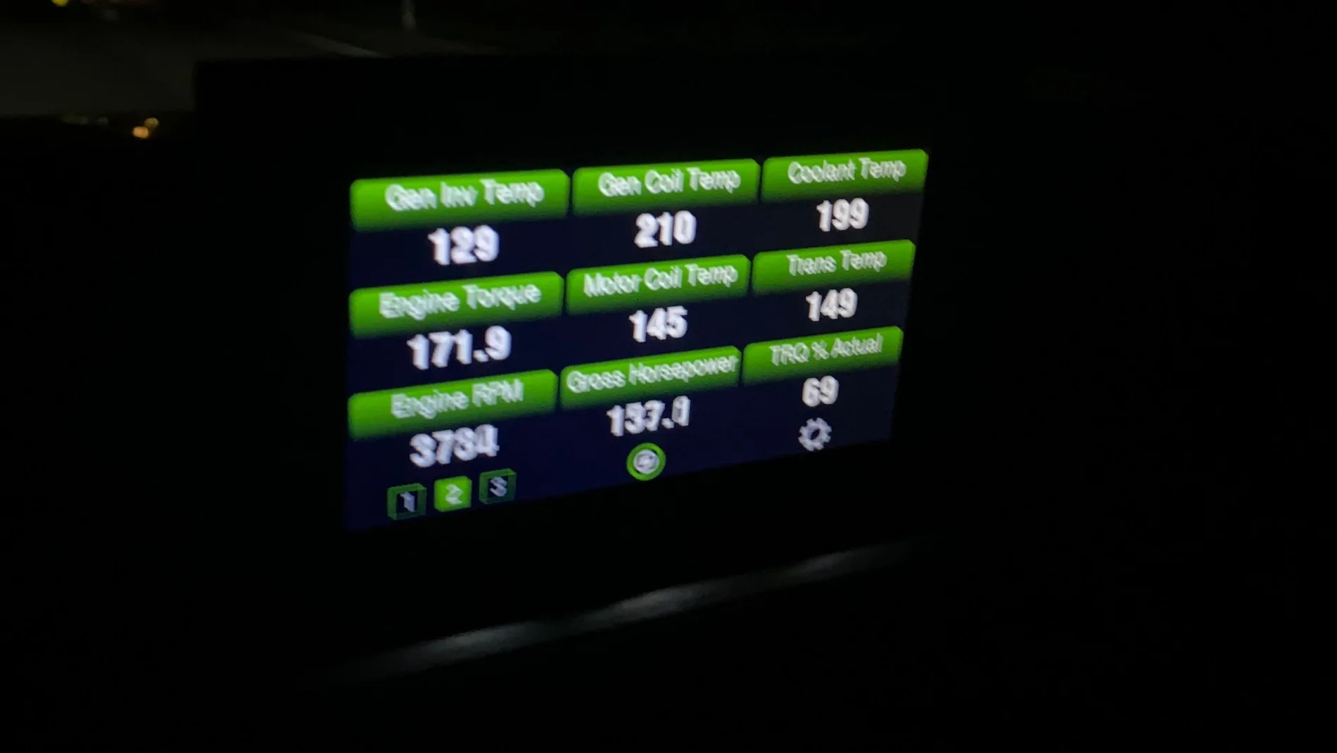

Here's an interesting one: slow shutter at night so blurry.
2022 Hybrid
171.9 lb.-ft. Torque @ 3734 RPM
171.9 lb.-ft. = 69% Torque
