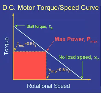

OK I have watched this video several times anti got me to thinking. Found the attached graph of torque of DC motor. Max it at zero speed and it goes to about nothing at max rpms. So every one is correct that the higher the truck speed to more the ICE has to take over the work of moving the truck. Now is makes more sense to me.
Except the Maverick eCVT does not use DC motors. The DC voltage from the battery goes through an inverter that converts the DC to AC voltage to drive the three phase AC motors.

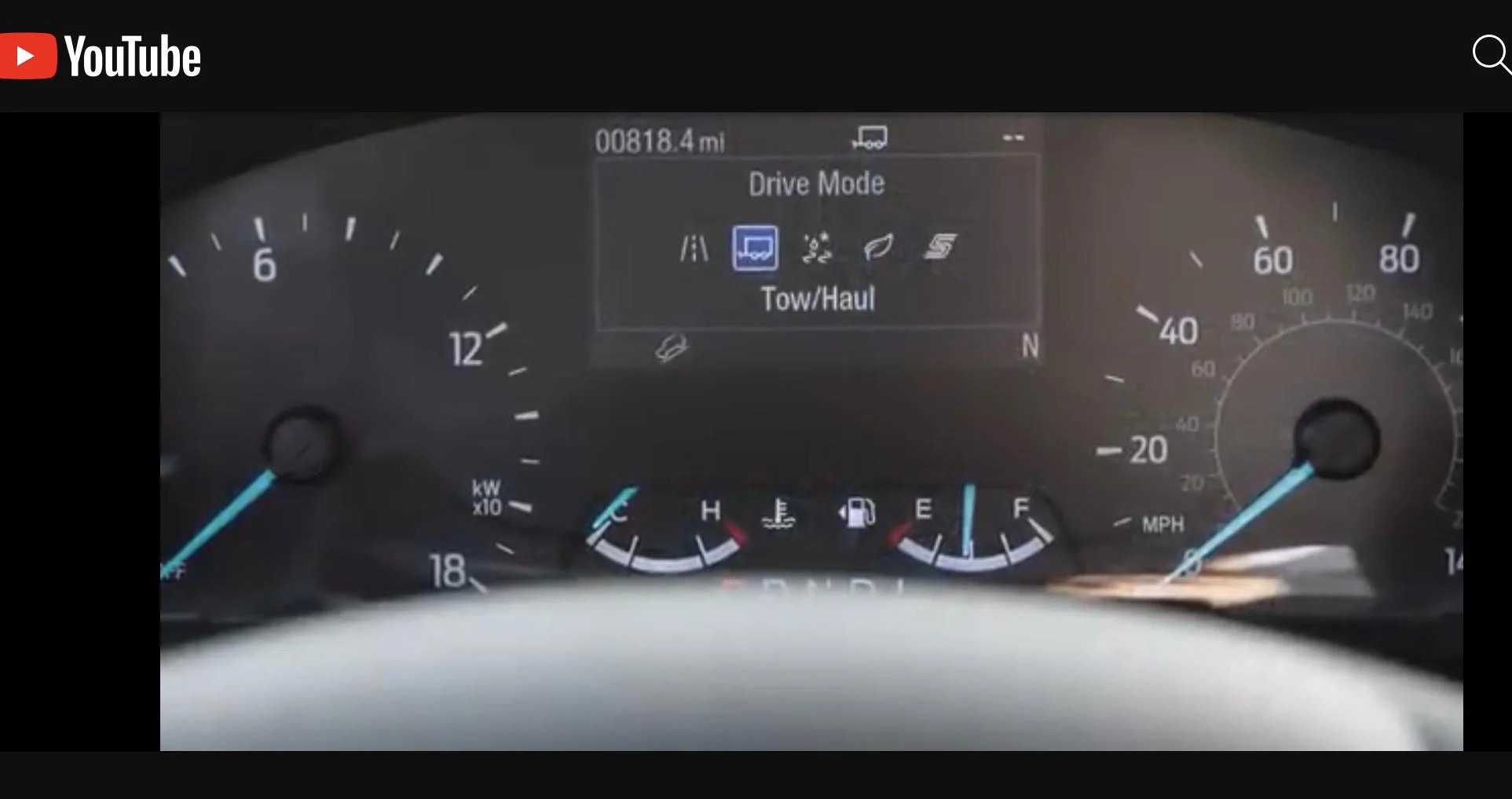

Wow. Did anyone catch the instrument cluster in Sam's video was either a pre-production vehicle or not in a Maverick?
Ford Maverick Total HP and Torque? 1149A0AD-48A2-4C6C-8BC2-E2787DFEE24D
Ya all see that Easter Egg in there?
The "Power Meter" is labeled "kW x 10".
Not %.
Very interesting!
Ford Maverick Total HP and Torque? F6AA26B3-9AC3-4C0C-BFE3-FE068F9EB7A5
Keep in mind horsepower and kW are two measures of the same thing. The battery is not going to output 180 kW of power. Well, maybe it could once.
