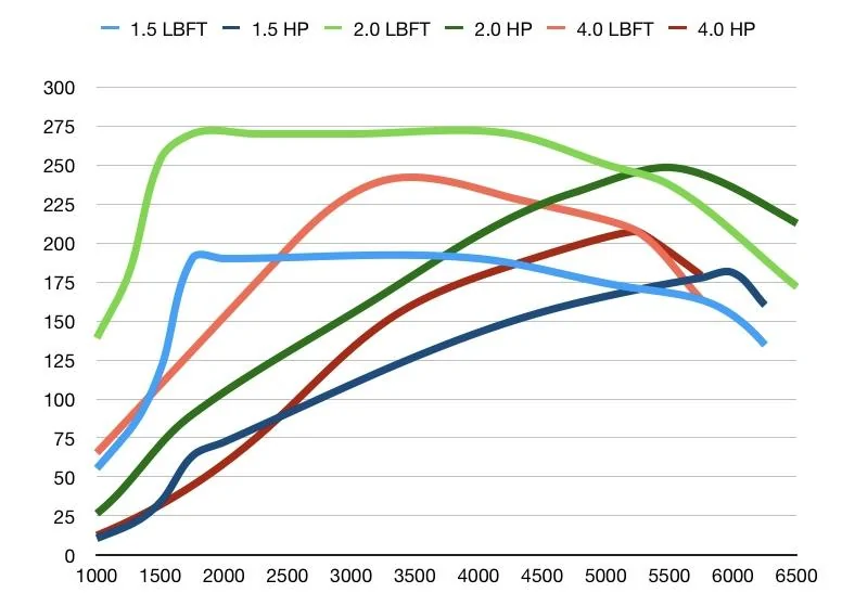

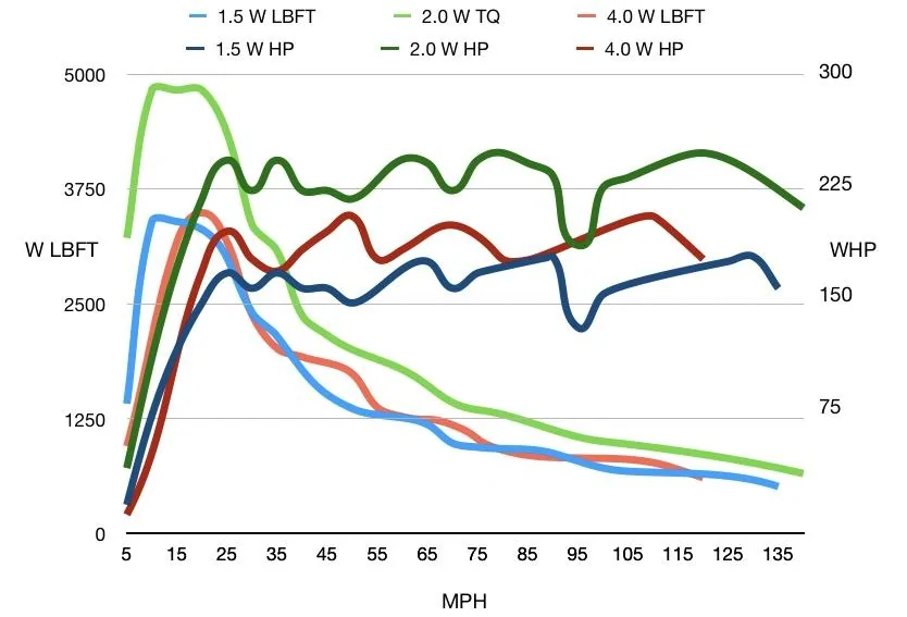

For those curious the difference between the 1.5L and 2.0 I made a graph of both the Crank HP and LBFT as well as the WHEEL HP and LBFT for both also including the old Ford Ranger 4.0

The 2.0 EB makes more torque at 1,000 RPM than my 2.0 Duratec makes at roughly 4.5K. Modern engine technology is truly insane.
I was originally thinking I'd be perfectly satisfied in the 1.5, but I might stretch my budget a bit for that 2.0.......

FirstOnRaceDay, could you give us more information about the wheel horsepower and torque? Is it calculated based on going flat out in regular drive, for example?

yes. Wheel torque uses the transmission and differential ratios. So at X speed you have UPTO Y lbft or HP.
and yes that is assuming Flat out, redline shifting.
The main reason why I use that is because of new EVs are 1 speed. So it’s hard to tell the difference

Cool beans. The second graph does a fantastic job showing the impact of gear ratios on torque. It is an education, many thanks.

absolutely. You can have a low Torque car as long as you have the proper close gearing. Your good to go! And the Ford 8 speed definitely has close gears 1-4 for fun in town driving (and good mpg) after that it’s nice tall gears for highway. (1750 rpm at 70mph in 8th btw)

Indeed. My old Suzuki sidekick has a really anemic engine that tops out at 96 horsepower factory, but it has a 5.125 rear end!

Nice! Bronco Sport has 3.81. So that really helps.
