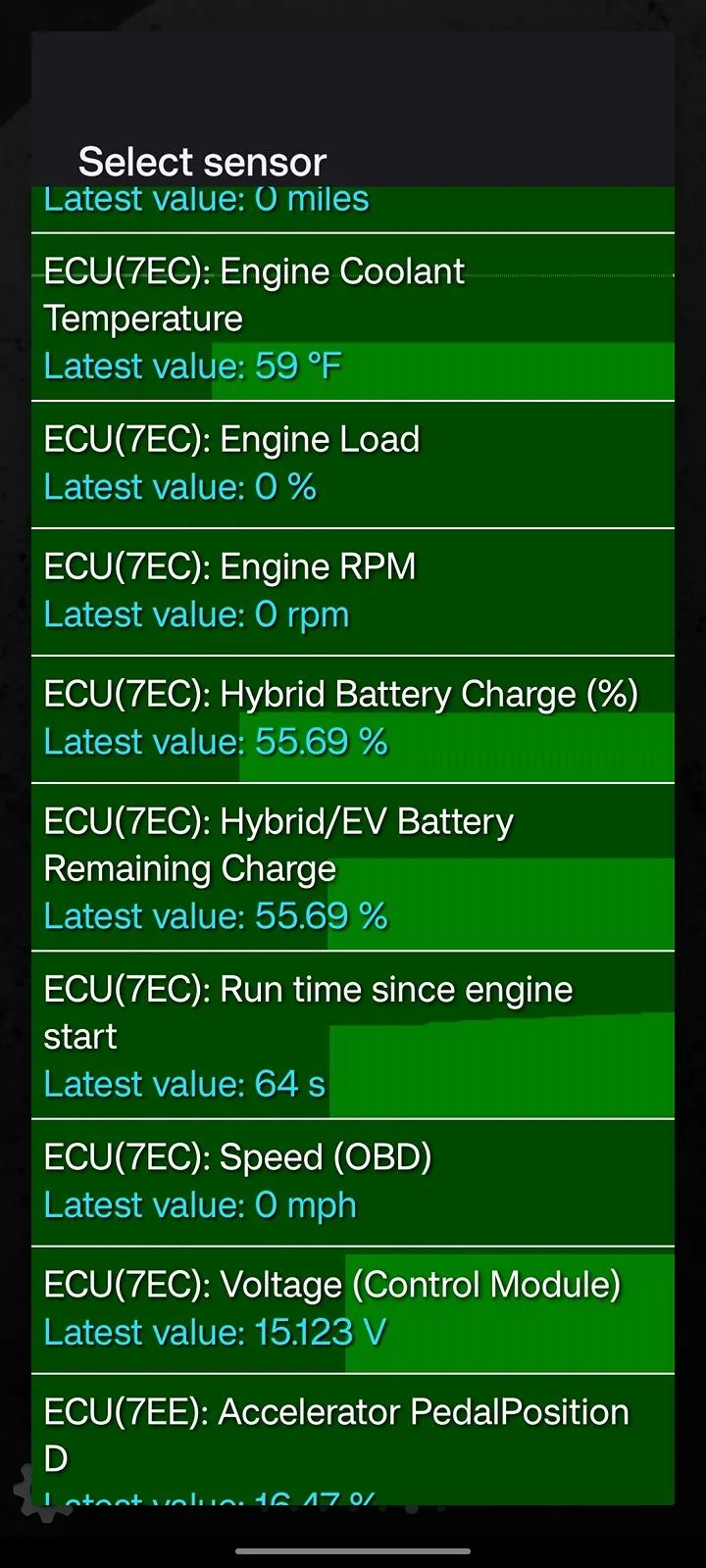

It's on my 2022 Hybrid.
Don't know why I asked where the PID as I have it as one of my View1 already. Must have been something else, but put it as coolant.
