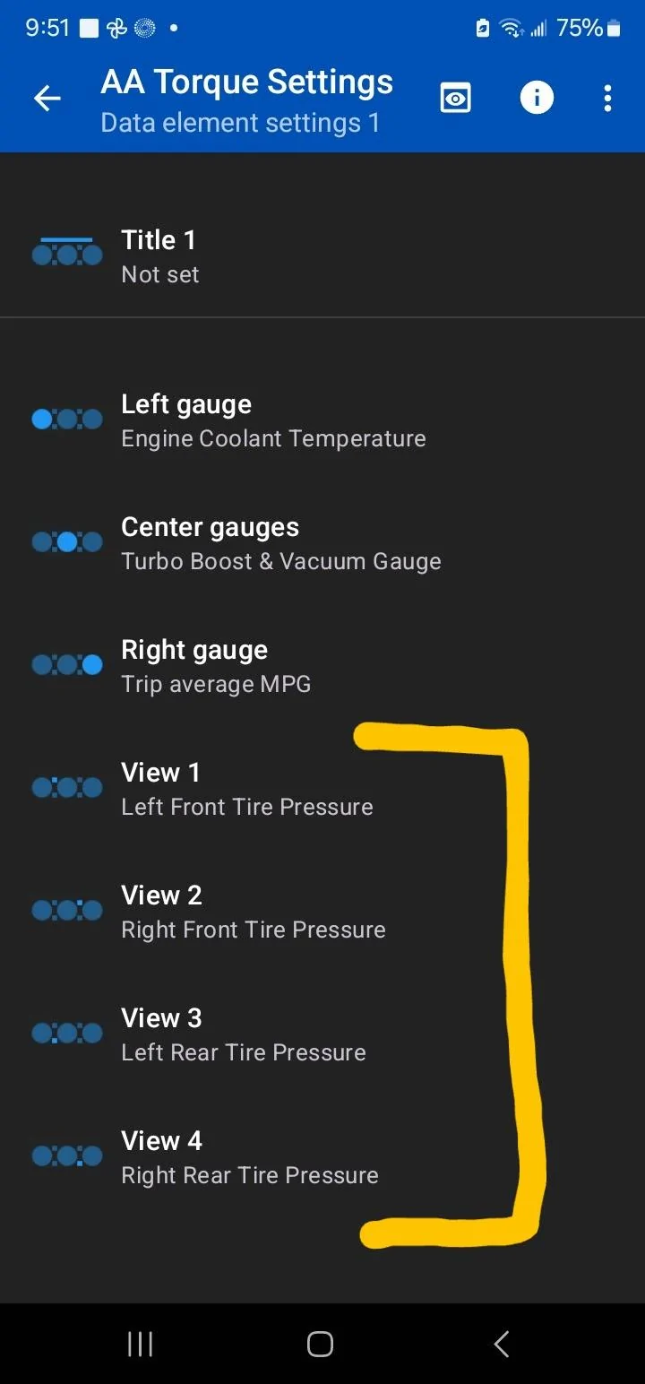

I have imported the pid posted by Gullzway
Through trial and error I have found the working gages for most things but can't get tire pressure.
I have added the tire pressure Guages bit don't display a value... always blank.
Anyone know how to get the pressure to actually display ?
To confirm, here are the PIDs I have:
LF 222813
RF 222814
LR 222815
RR 222816

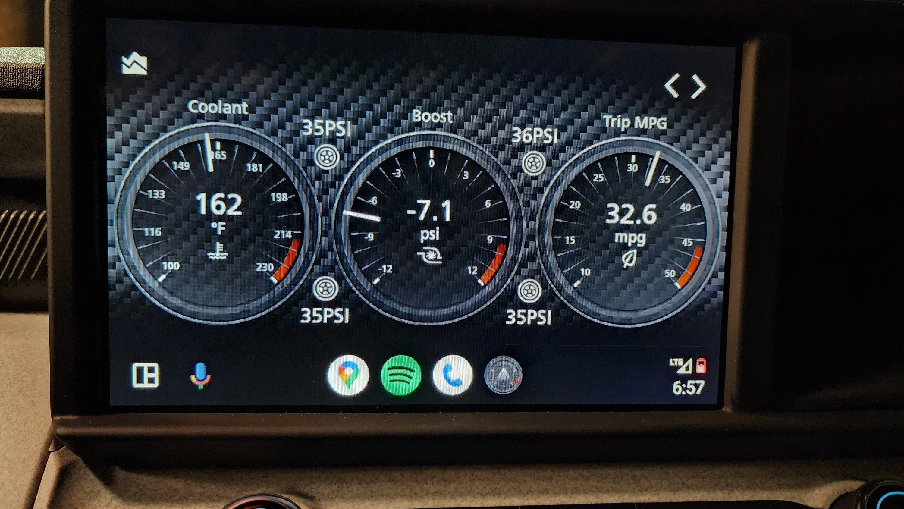

Just thought I'd show my setup. I use this every day.
LF 222813
RF 222814
LR 222815
RR 222816
I just went here to set tire pressure gauges.

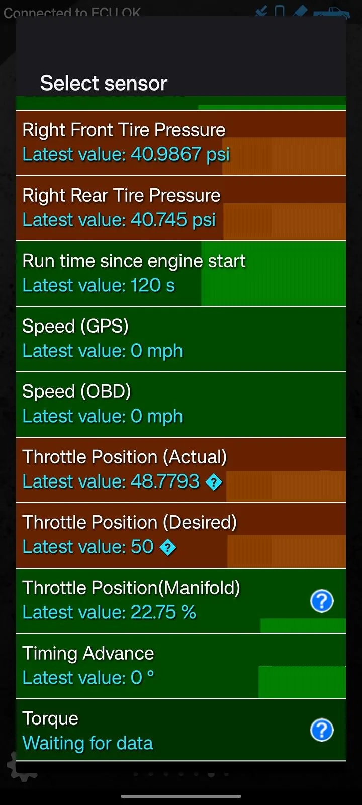

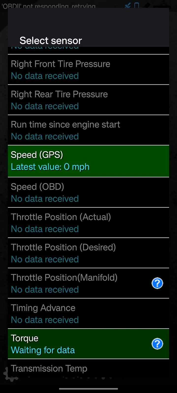

Are you showing Data for the tire pressure gauge in Torque when adding them to a screen?
I'm not connected to my truck at the moment, so there's no data displayed. Also could be your OBD2 reader if you're not getting any data.
Ford Maverick Torque Pro Android Auto plug-in released! Screenshot_2024-03-19-14-01-00-09_b9c66f921be6b9ee18febc2ed6906538
Connected to truck.

No, when driving other guages work fine but there is no data for tire pressure in torque.
Connected to truck.
