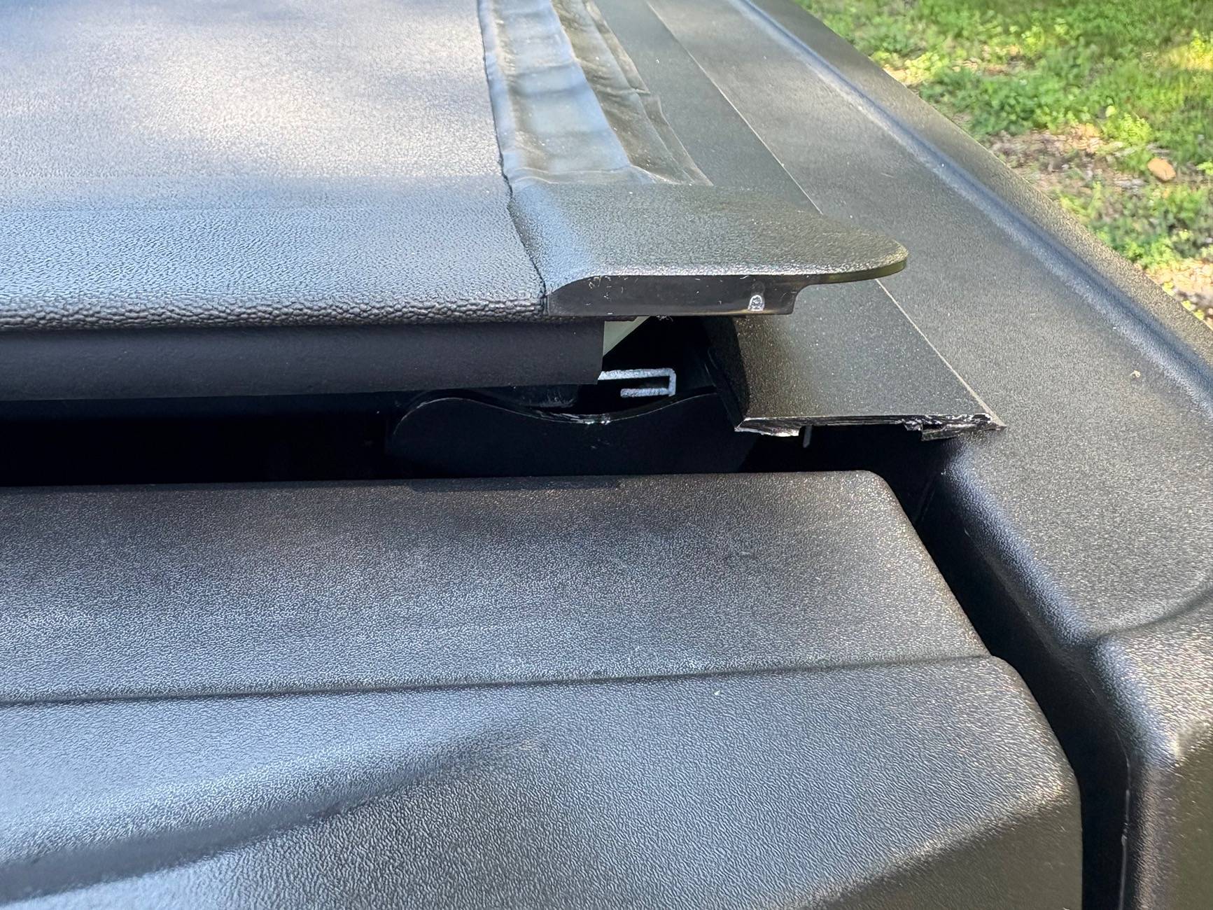

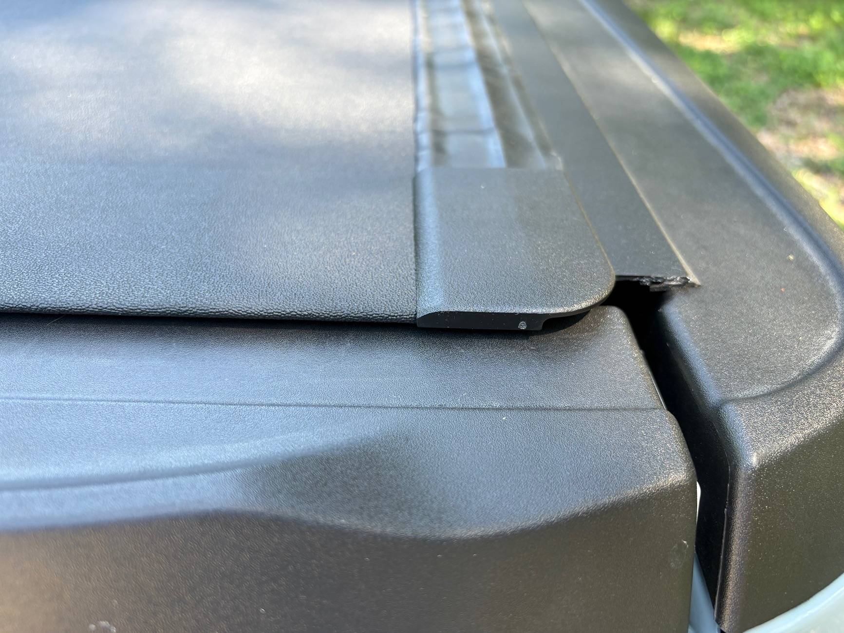

I’m looking to troubleshoot my BAK Revolver X4s hard roll up. The latch on the passengers side works intermittently—I’ve squared it off a number of times only to have it loosen after 2 or 3 uses, which tells me I’m close (and it’s not a defective unit).
Also, adding my obligatory grip about the poor quality of the end cap. Suggestions to secure or replace welcome!
Ford Maverick Tonneau troubleshooting—securing the BAK Rev X4s IMG_1381
Ford Maverick Tonneau troubleshooting—securing the BAK Rev X4s IMG_1382

Forgot to attach this image—end cap.
Ford Maverick Tonneau troubleshooting—securing the BAK Rev X4s IMG_1384

Those end caps are way too thin and weak, and also provide easy access to the latch holding the cover closed. Mine broke just opening my rollup cover. What I did is I got a 1/4" x 3/4" stainless carriage bolt, stainless washer, and stainless lock nut and bolted it on. Just drilled a hold where the broken clip was. Sorry, I don't have a picture available at the moment.
When the end cap completely breaks (which I expected it to do since it's thin and weak), I hope to make one out of aluminum.

I just installed an X4TS cover on my 25 Tremor and had to make several adjustments.... after getting it right, it works well. I found that without shimming it, the plastic pieces that lock the top down didn't fit into the tracks, but rode on top of them. After shimming the rails out from the truck bed, they sit within the slots. I also had to adjust one side up slightly higher due to the poor fit of my tailgate, which was slightly higher on one side than the other. It didn't look bad, but when putting on the tonneau cover, it was very evident. Just a small shim in place and all fits well and it latches properly.
I also have concerns about the security, but there is no top cover that is 'secure' It wouldn't take much for anyone to break into almost any cover or canopy with a pry bar. The car itself is easily accessed by someone breaking a window. I think that the X4TS does a very reasonable job of securing the bed of the truck and allows me to put some things on top of it if needed.
I recommend you reach out to the Realtruck support. I think you'll find their customer service is excellent and they'll work with you to ensure you have a good fit.

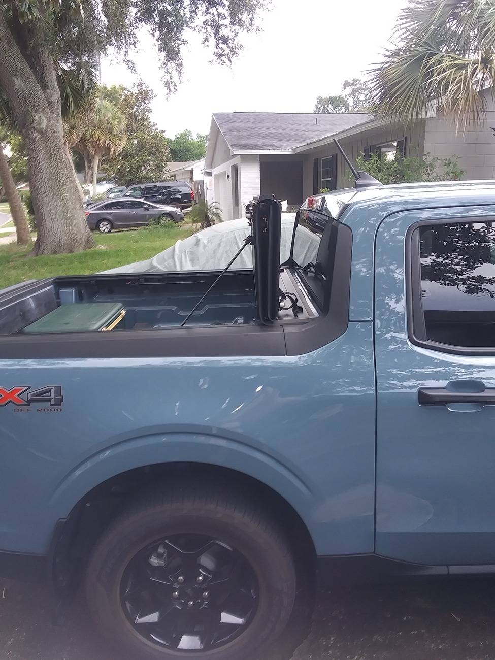

Happy with my undercover armor tonneau . :) no issues yet after 3 years.
