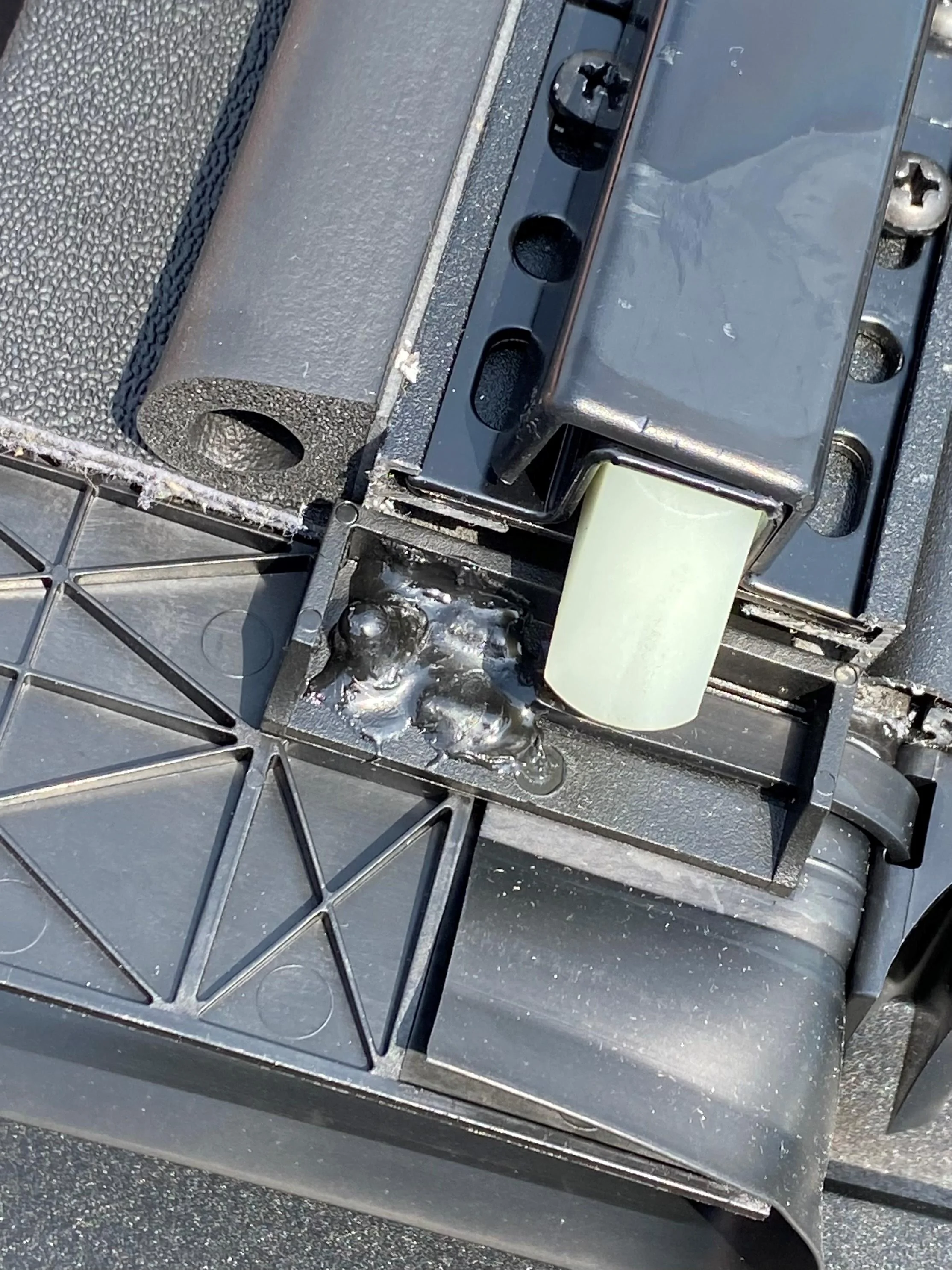

The corner plastic covers pop off way too easily on the BAK x4s. I found this JB Weld Plastic Bonder that seems to be the best long term solution for making these covers stay in place. I mixed up a batch and covered the underside of the trim piece before inserting the clip back into the cover and applying some more on top. It dried super quickly and doesn't budge at all. The black blends in nicely and you'd never notice if you didn't know it was there.
