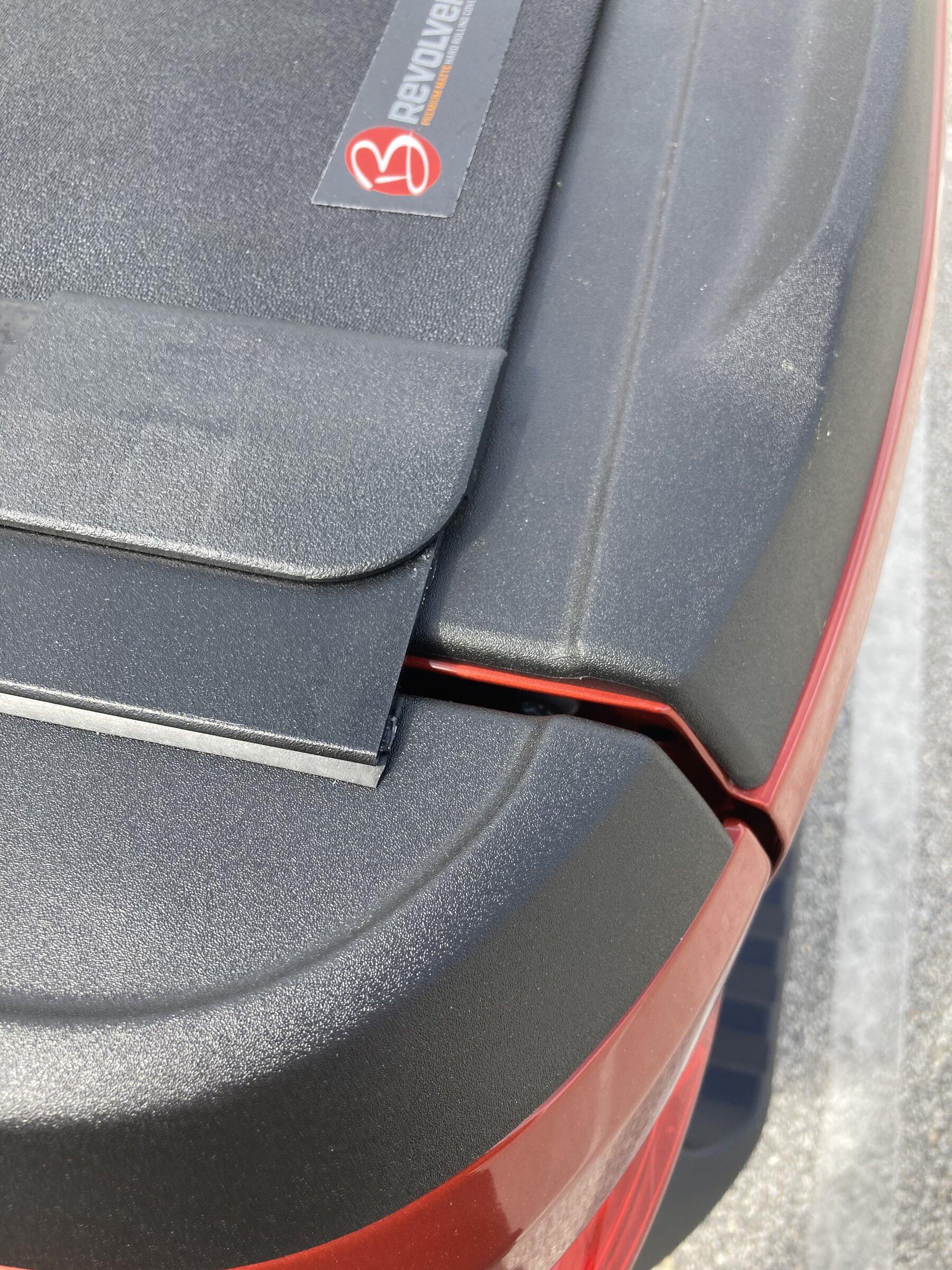

I ended up cutting off 1/8" of the right side rubber. Now mine fits evenly. I'll try and take a pic.
You can see the Before and After ..... Much much better now.

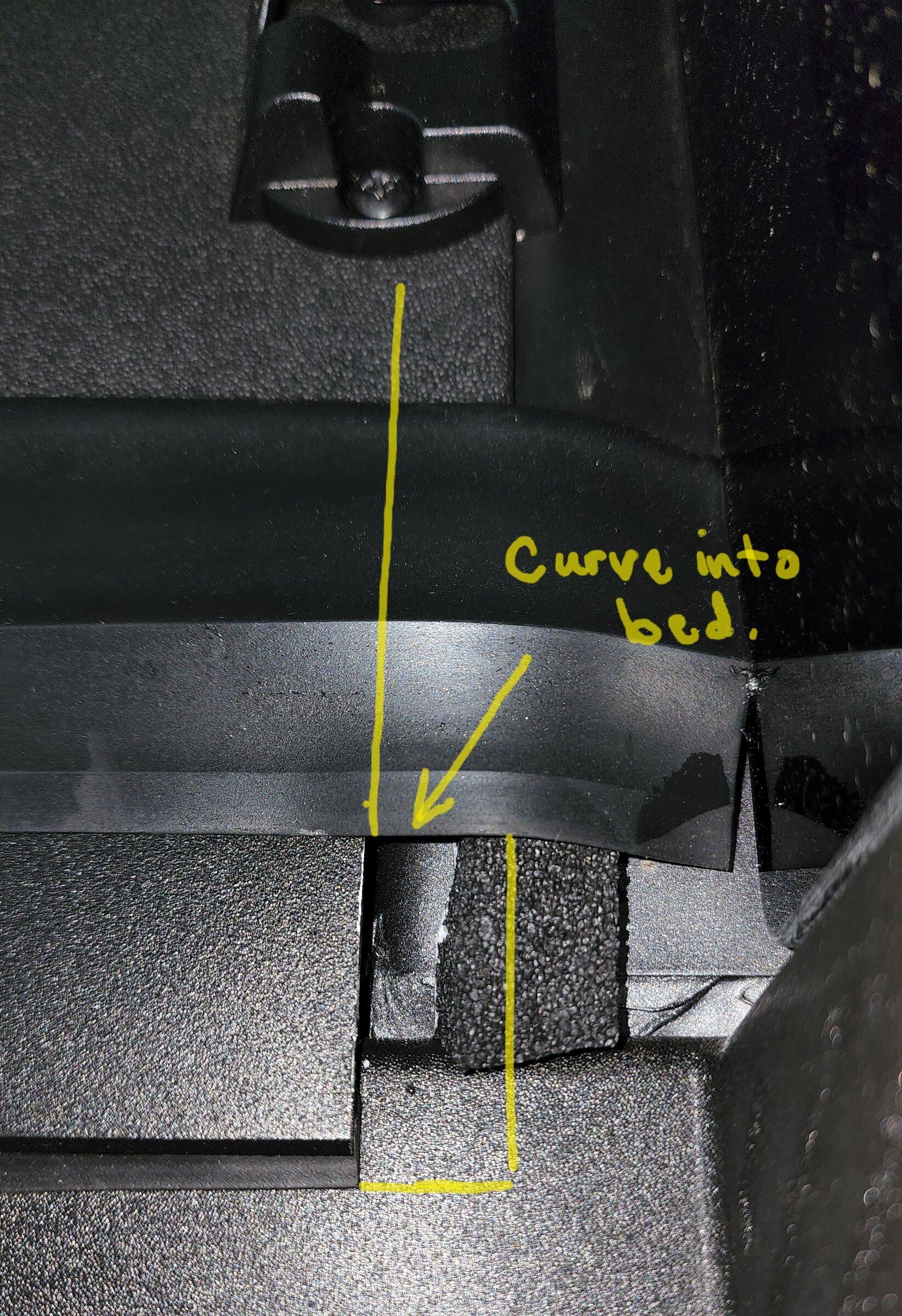

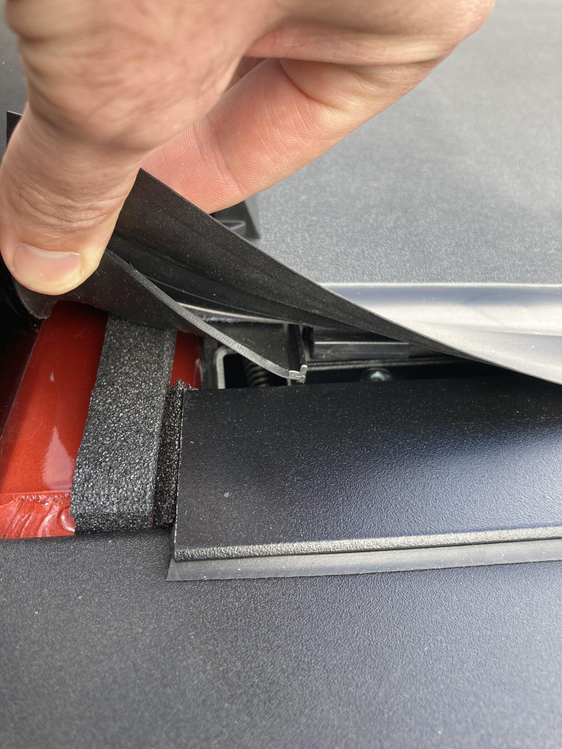

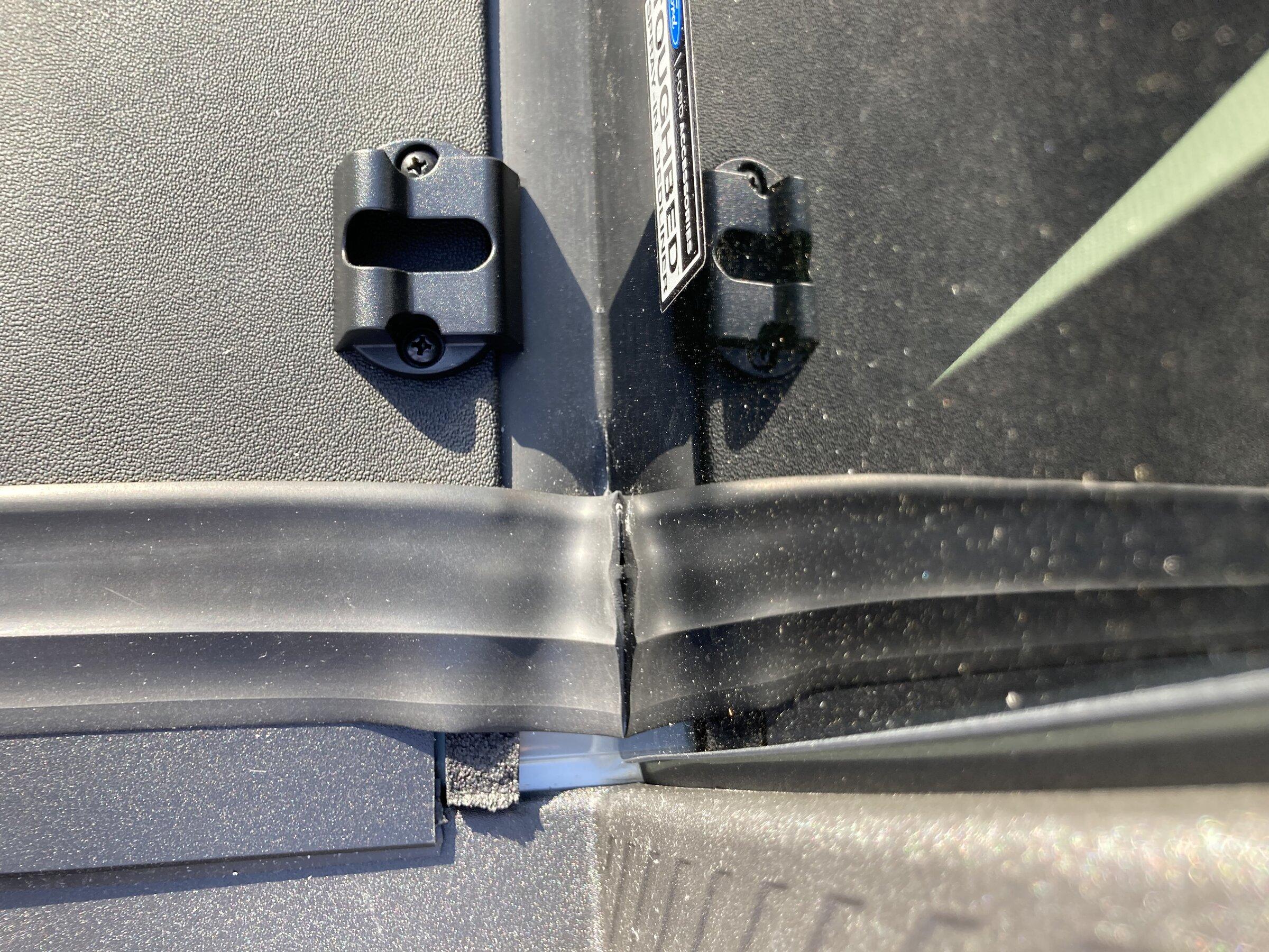

I installed mine with the thin rubber seal strip curved up against the rear window instead of down on the bulkhead. I did have to trim a small amount of the wide side strip to do this. I don’t have any leaks doing it this way and it looks like a neater installation to me.
I’m just installing mine today and I have done the same thing with the seal sitting up on the rear window. It seems to do that if you follow the instructions. I haven’t trimmed the side seals yet but I will now I see how it looks on your. Thanks.
