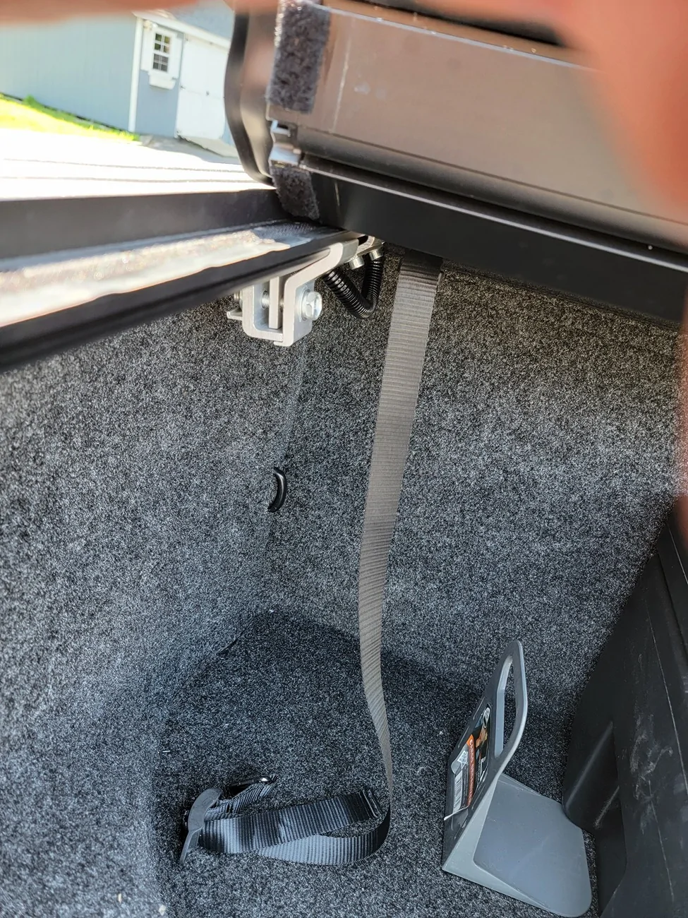

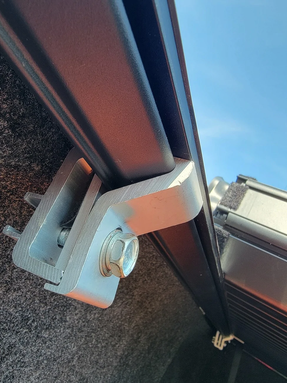

Here are some pictures of my rails, in case that helps.

Check to see if there is a thin wall that runs along the bed rail downturn. If you are positioning the clamps behind the downturn, that may be the problem. Mine are in between that thin piece and the downturn. I could see where going behind the downturn might pull the track down.
Look closely at my second picture and you'll see the inner clamp is not behind the bed rail; it is nearly straight up. It's in between two pieces there.

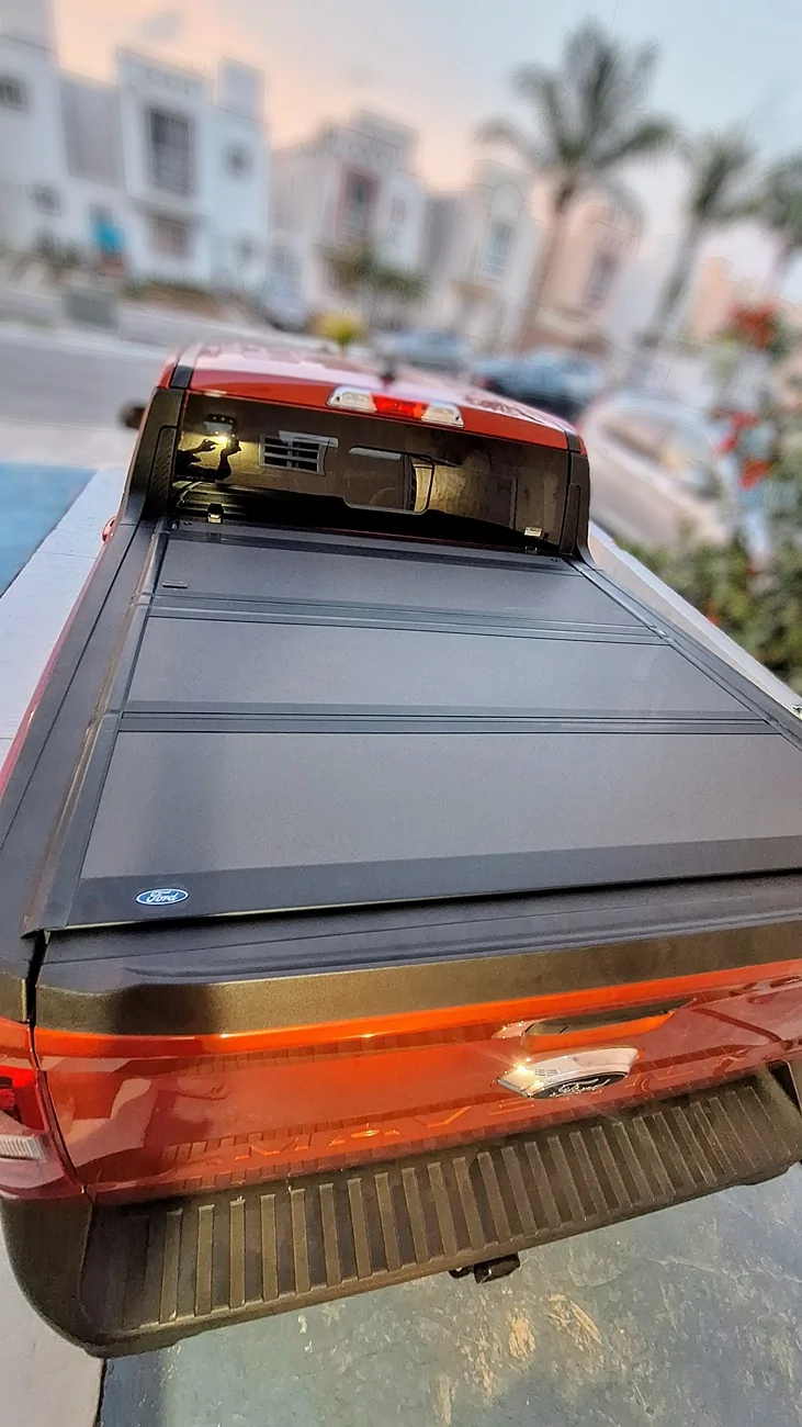

I went with the Ford OEM Hard Trifold Bed Cover
So far so good

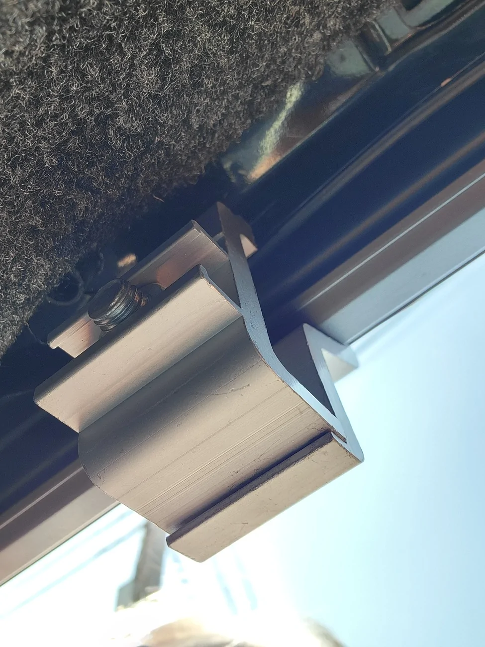

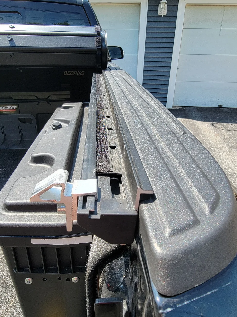

Here's another couple of clamp pictures in case they help.
