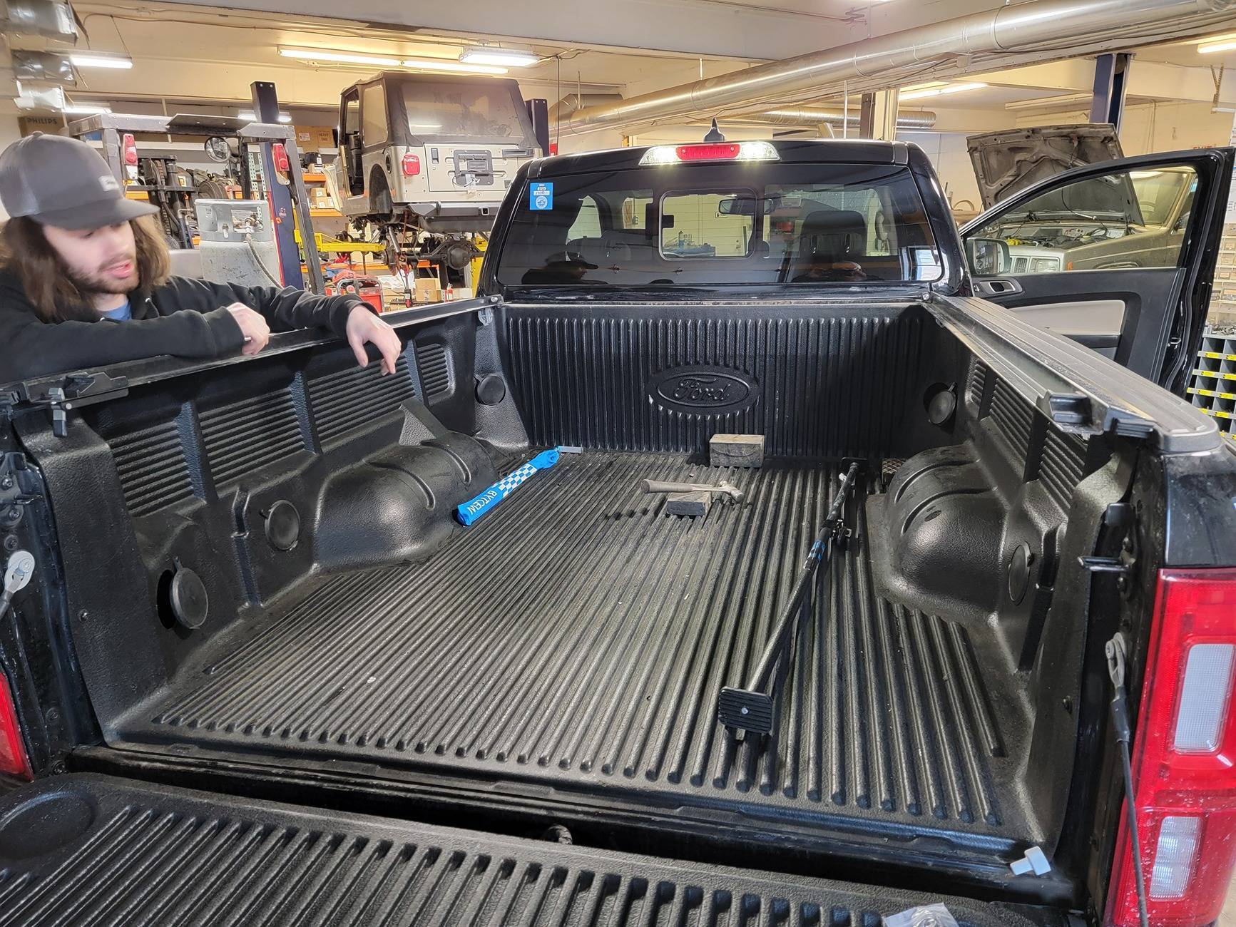

This was our starting point (Ford drop-in liner and Truxedo Lo Pro soft rollup that's been partially removed already):

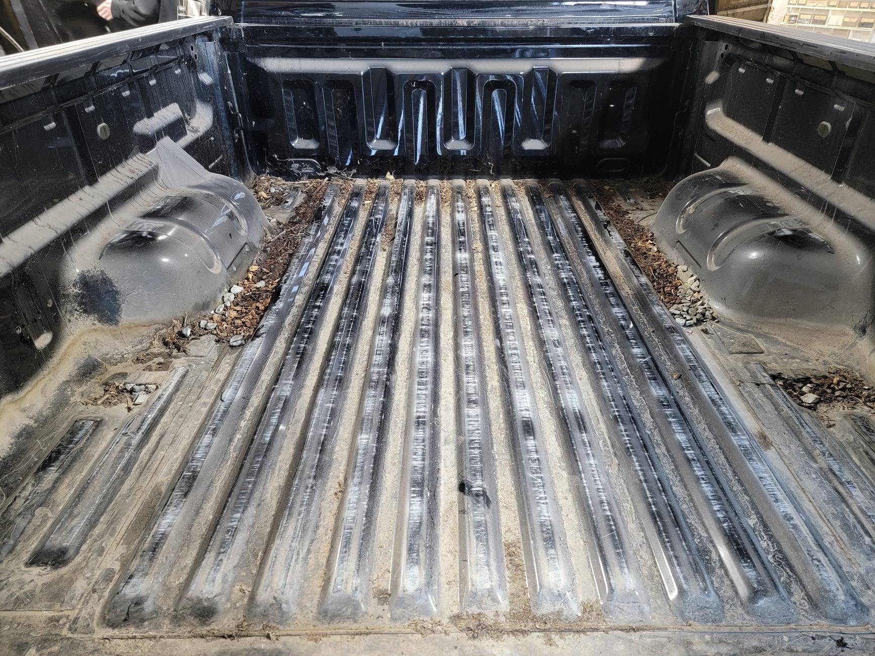

Here is what the bed on my 2020 Ranger looks like after only 4-5 years with a drop-in liner:

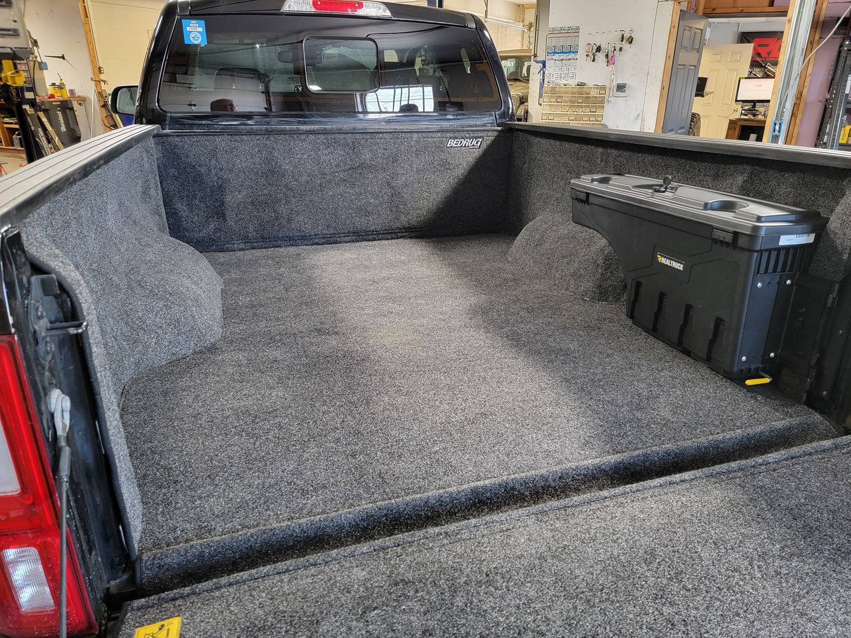

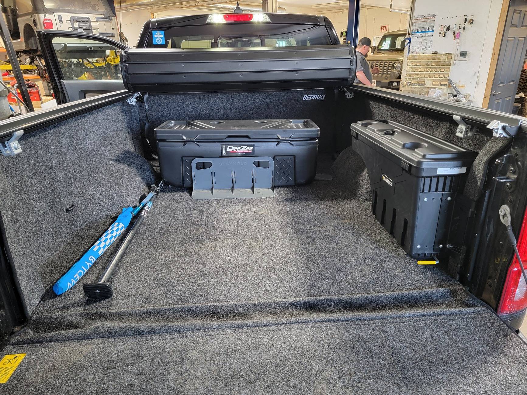

The first order of business was to install the BedRug replacement liner and the RealTruck swing case:

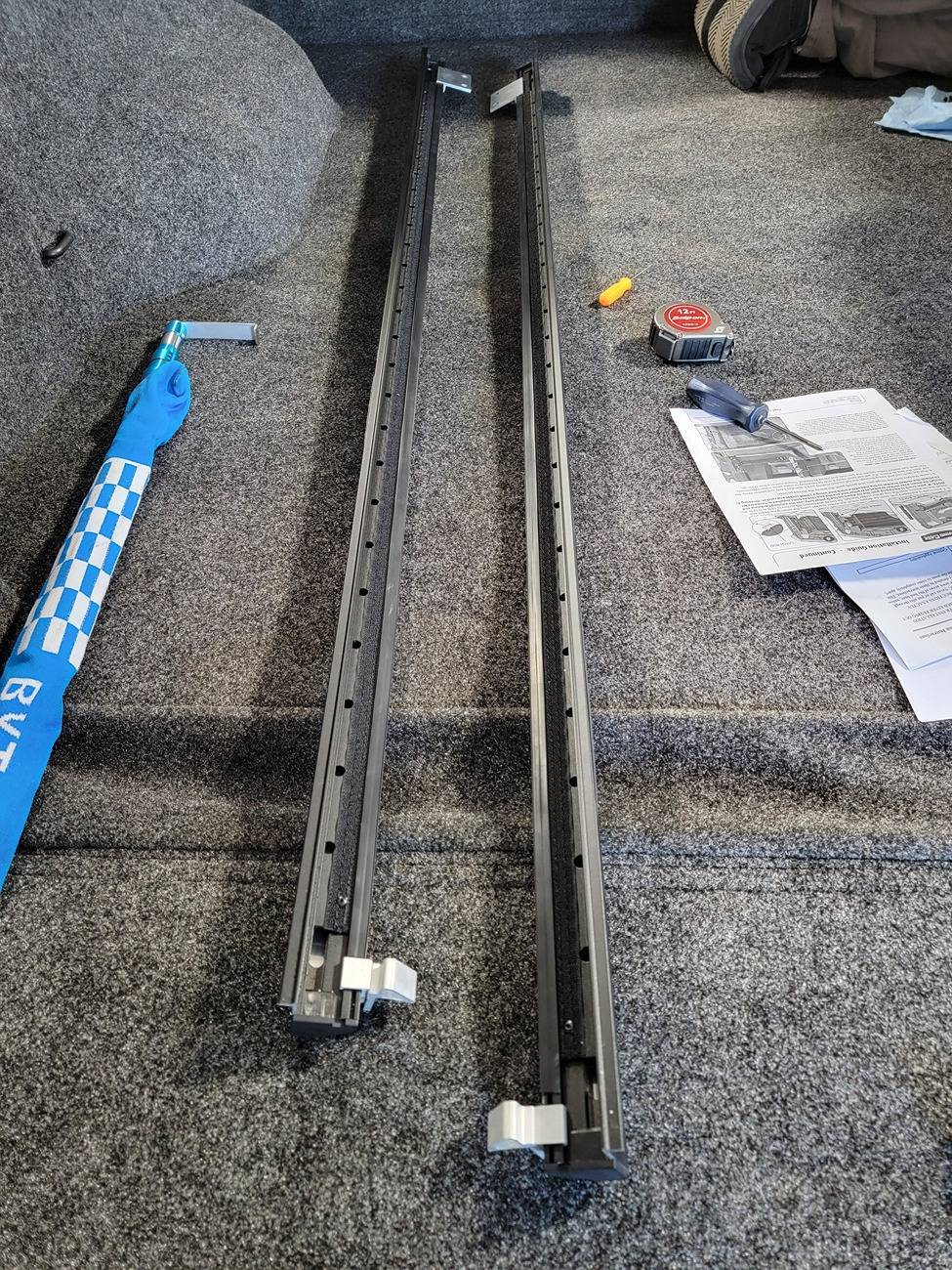

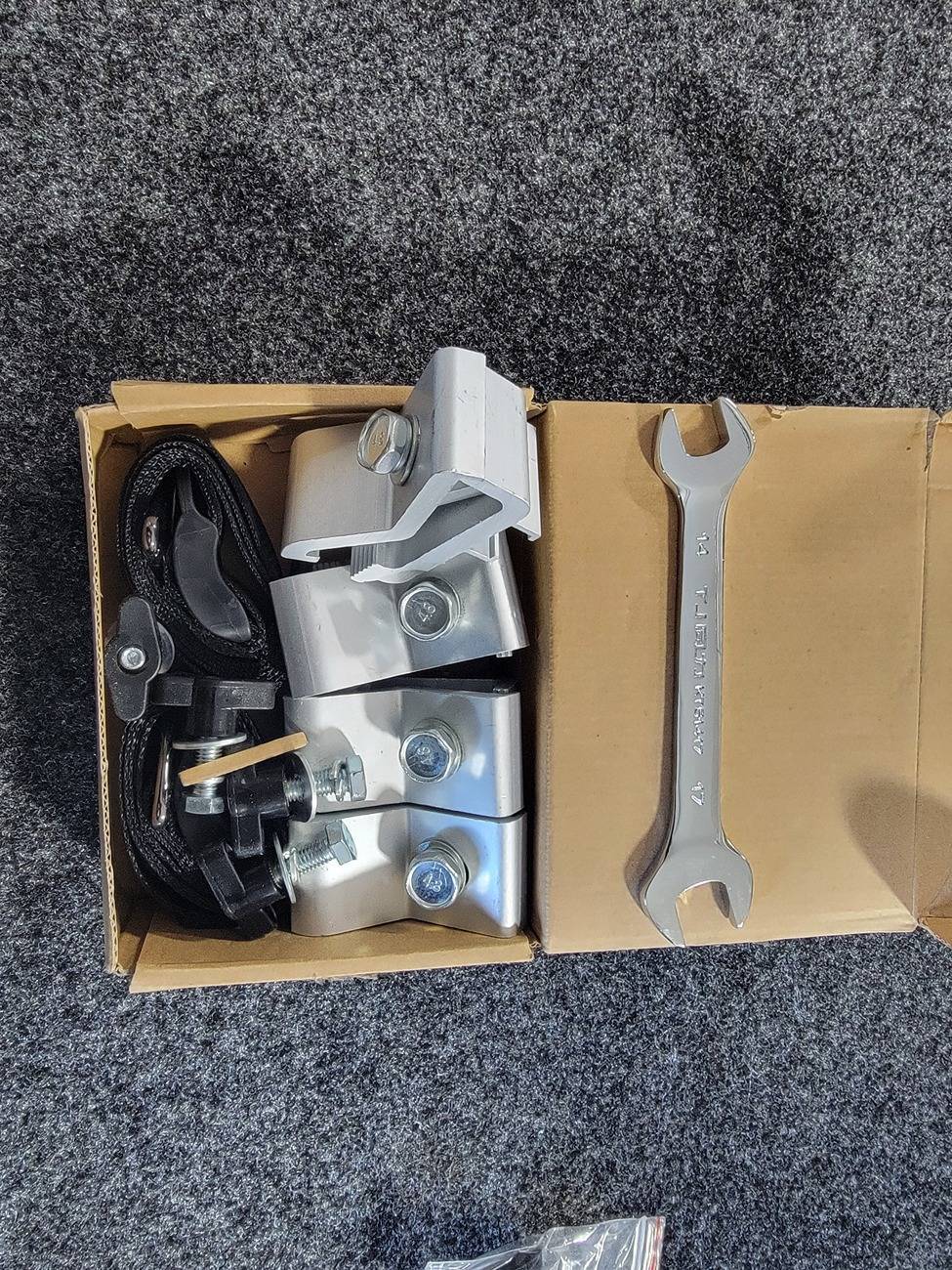

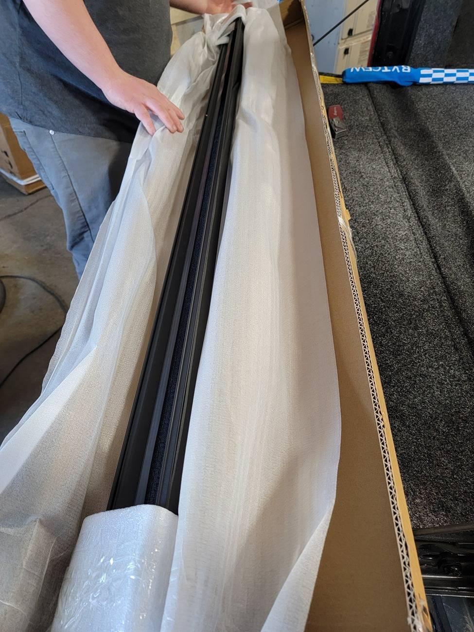

Next came the TLAPS hard rollup tonneau cover from eBay. The following pictures show the components and packaging, which all looked like quality items. The contents even included a 14/17mm wrench that wasn't a throw-away tool as so many of these things are.

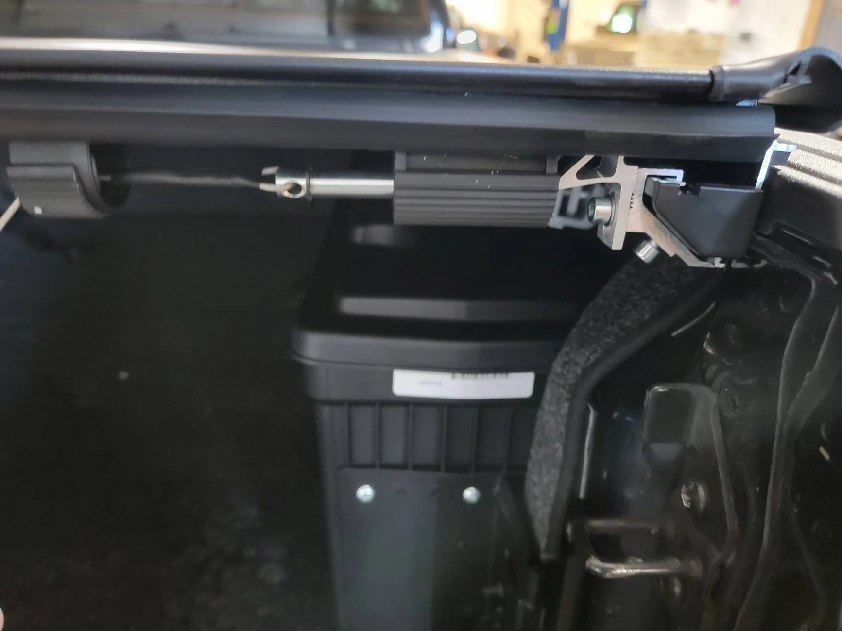

The picture below shows the latching system. The latch itself is adjustable and seems to be a quality component. My former techs were impressed with the overall quality and felt it exceeded both Truxedo and BAK Industries.

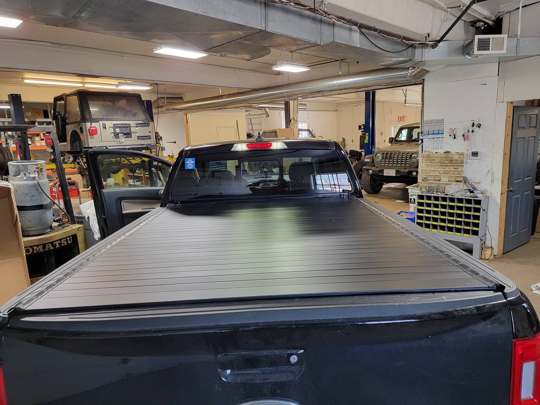

Additional observations:
  1. The weatherstripping along both sides of the cover is built into the grooves between slats rather than just taped to the top of the cover.
  2. The rails have drains near the front.
  3. The product comes with a very thick weatherstrip that, even when compressed, fills the space between the bulkhead and the bed rails.
  4. The straps to secure the cover when rolled up have a carabiner style attachment to hook into the posts at the front of the cover and the eyelets that attach the straps to the cover are embedded securely into the strap material; you cannot get a fingernail under them.
I paid $569.00 for this cover (it's now up to $642) on eBay and consider it equivalent in design and build quality to any of the major brand covers. Of course, time will tell as to durability but the prognosis is favorable.

I'm also impressed by the latch mechanism. It's a very positive close, leaving no question it's latched and both sides latch equally well. The Truxedo on the Maverick typically required that I press down on each corner to get both sides latched.
