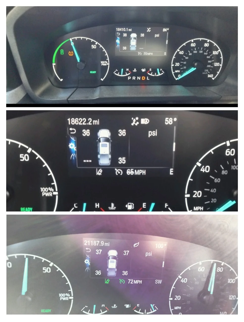

I don't think it's the batteries I think it's the screwy computer.
The top photo 18,410 isn't the first time it happened. It's the first time I had my phone in the car the first time it happened was actually one of the front tires.
The next time was 18,622.
Then it happened four times while we were on 4th of July holiday.
Everything always return to normal. It takes about 10 to 20 miles before the tire warning light goes out and the pressure numbers came back
I have never had a sensor changed.
You had 3 different tires go intermittent - all at speeds 65+
I’m guessing the computer is losing signal due to batteries? I don’t know if our tpms have a “low battery” warning - or will just act intermittently weird. Or like you said - the computer is screwy.
Anyway, when mine poop out they will stay that way & I’ll keep my tires inflated the old fashioned - eyes & a gauge:)

How would you explain them all coming back to normal after 15 to 20 miles while continually driving at 70 miles an hour. Remember I'm going a couple hundred miles in between stops?🤷‍♂️
I can walk out to my truck right now and I know all the sensors will be working.
Ford Maverick Tire pressure sensor fault 20250911_182709
I can damn near guarantee it's not the batteries.

How would you explain them all coming back to normal after 15 to 20 miles while continually driving at 70 miles an hour remember, I'm going a couple hundred miles in between stops?🤷‍♂️
It is a mystery to me too. Do our Mavericks have a “low battery” warning for the tpms? Guess I’ll ask the OP how he diagnosed his dead battery…

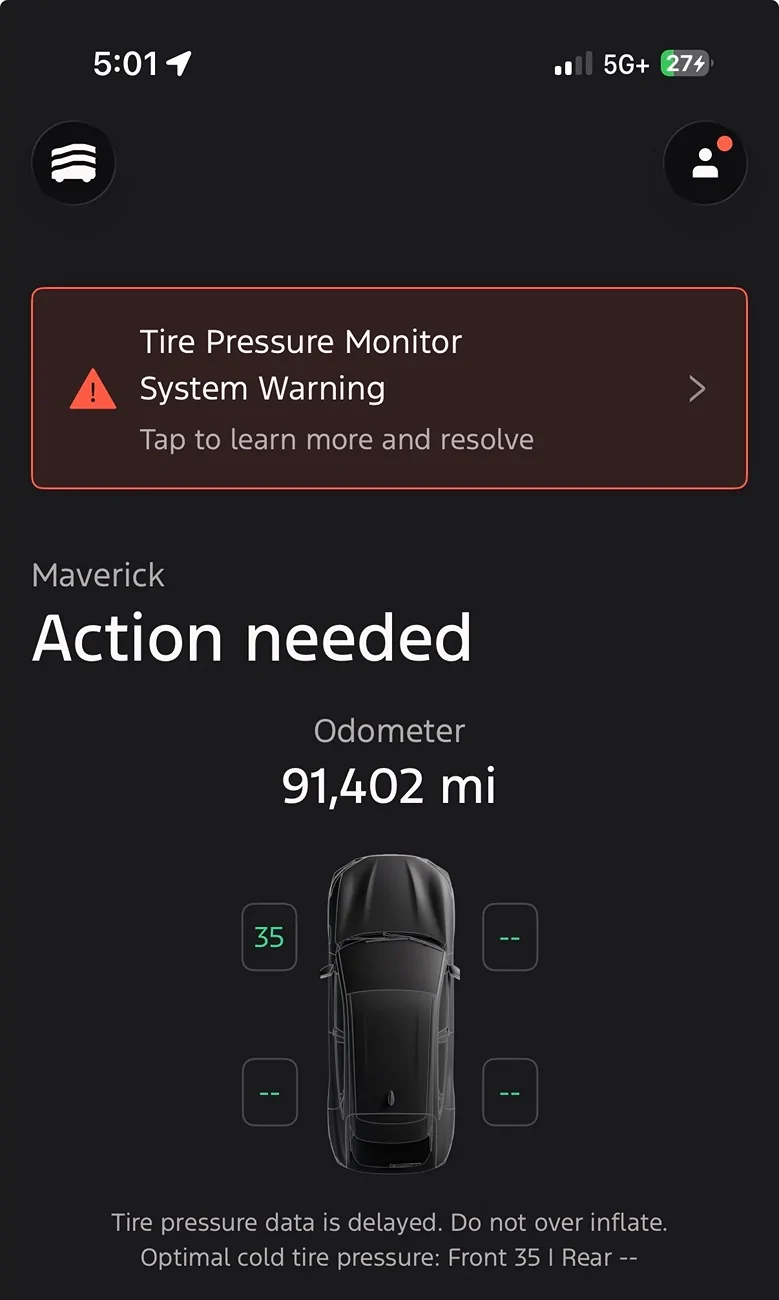

Clarkdonbran
Clarkdonbran
Aug 1, 2021
104
2,693
7,288
I got a Tire Pressure Sensor Fault warning on the dash screen.

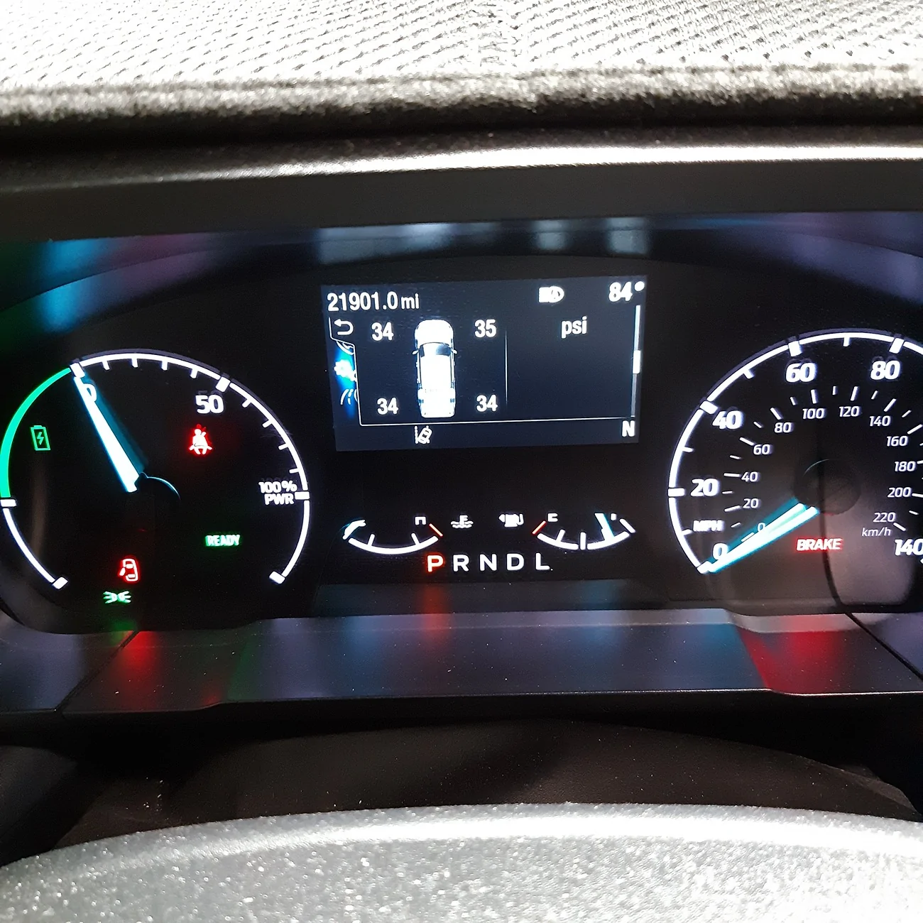

Kim
Jan 21, 2025
So my question would be what if 3 sensors fail at the same time? I’ve had about 2 months of intermittent warning about my tpms and it’s always the same 3 tires. I had my tire guy run a check and it isn’t showing as a fault on code reader and the tpms check isn’t saying faulty.
