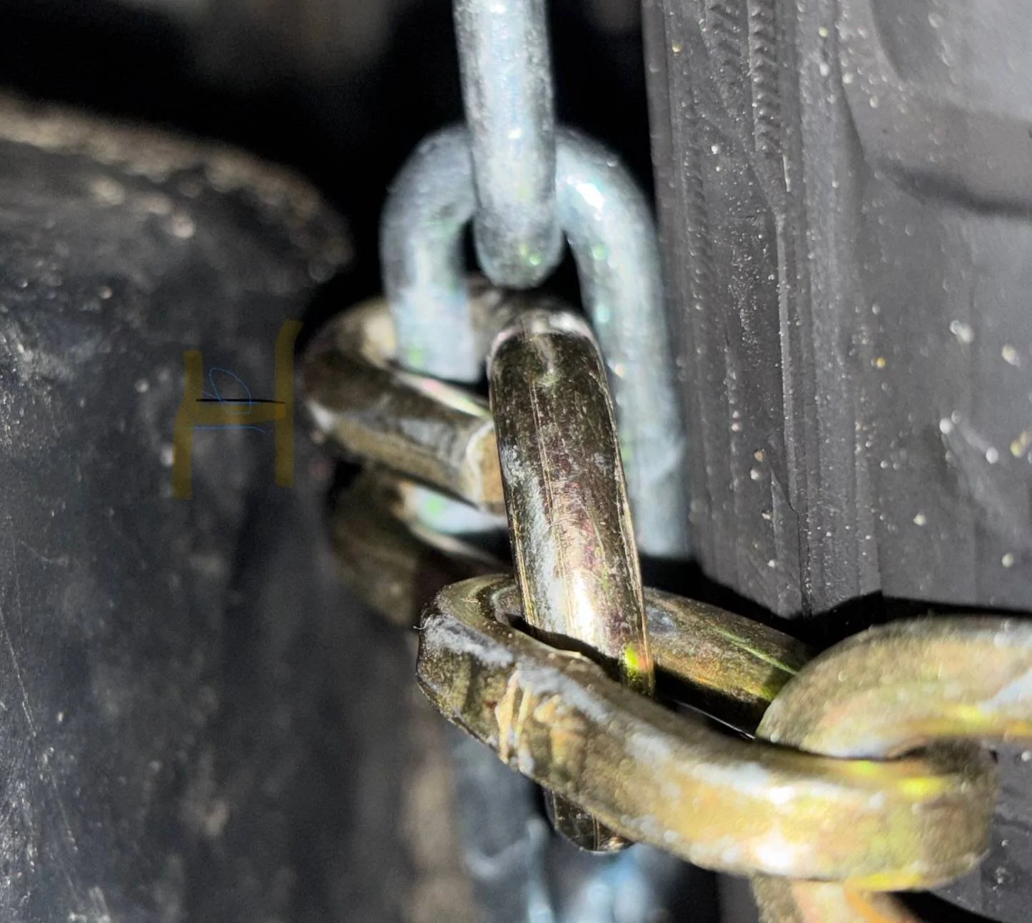

so, let’s talk ladder chains. unless you have 225/65/17r tires, actual 5.5mm chains with a 7.9mm cross link will be a very very tight fit in my opinion. There is a section of plastic behind the rear tires that has only an inch or so of clearance for the links. To be clear, 225 tires will work with these style chains but 235 and up might not.
If you have bigger tires than the 225 you can still get cables or Simon’s pattern chains like the ones peerless sells. Also, the 5.5mm chain with 7.9mm links should work on 235 tires. It’s not the top of the tires clearance that’s the problem, it’s the rear back sidewall of the tire.

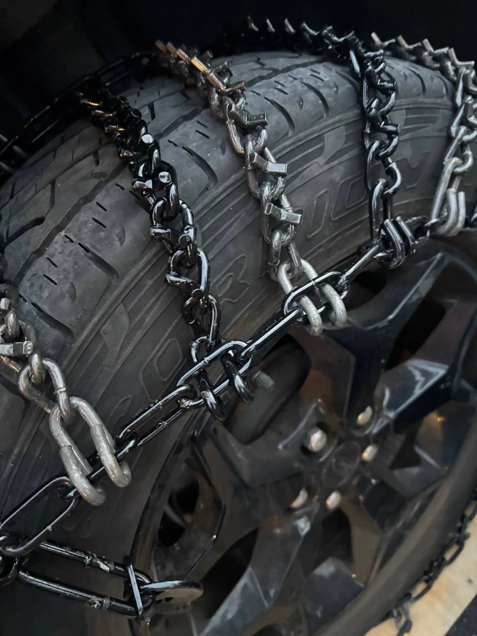

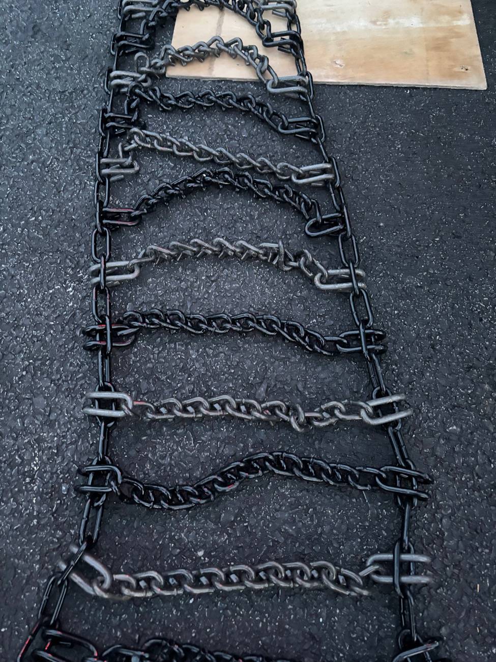

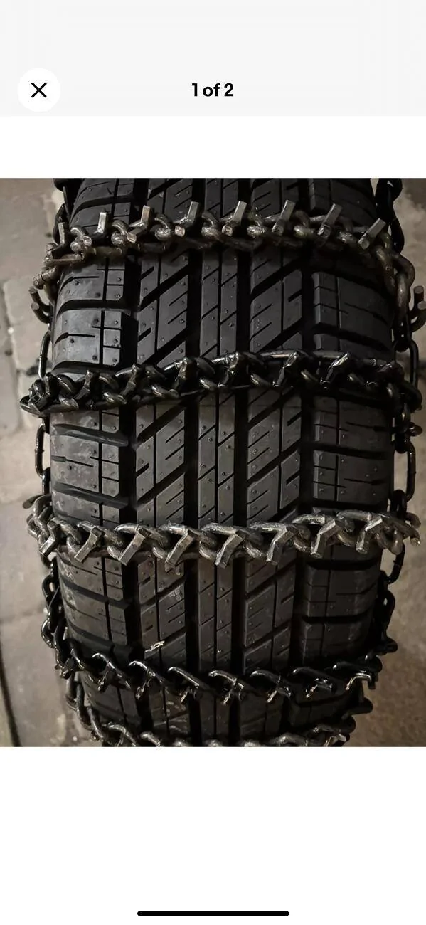

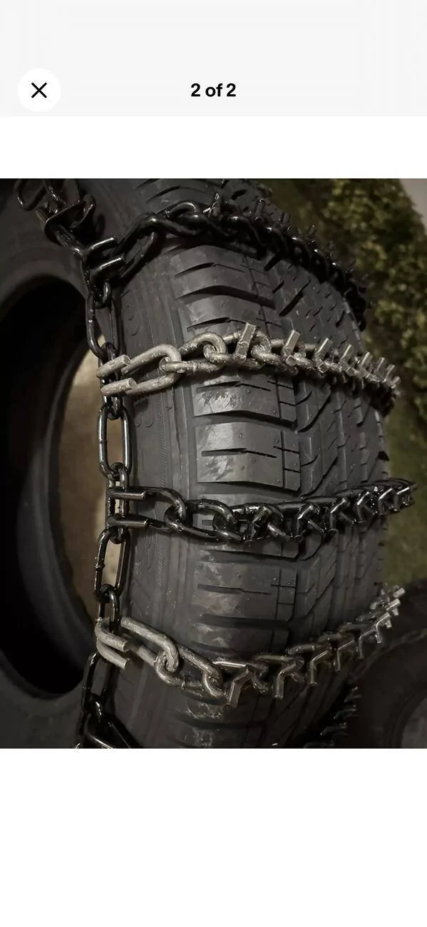

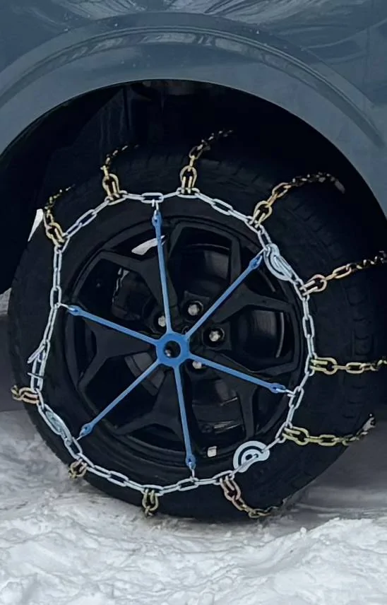

There is a seller on ebay that made these for me. They are 2 link v-bar chains (more ladders than a standard set and have to be custom made for that tire size they also have spikes for ice in addition to more cross ladders) $331 shipped. Please note they are non cam and will need at least one spider style chain tensioner but two for each tire is best. These offer the best grip and traction possible for the mavrick in my opinion. Please message the seller and talk to him first so you can be sure he knows what you want. I guarantee he will remember making them for my truck as the link below was made for my order. He will talk to you in great detail.
The other option is tirechainsrus.com and they are standard square link off road rated (stronger steel) chains with cams. You can just call the company number in the website and ask for the tire size you need but the link is below.
I’m adding pictures of the two chains. Also, when installing these make sure all the links on the back side of tire are tight and flat as can be. There is only an 1 3/8 of clearance in one spot and you need 3/4 for the links that sit on the inside sidewall. One of the pictures shows the spot on the rear inside sidewall where the clearance is tight, but works fine. I’ve tested both of these and they are fantastic. I’ve got a set of each type and put them on all 4 tires.
please note that there are some cheaper options around, some from the same seller from the eBay link. The reason these are more expensive is due to them being off road rated. I need them to get down the trail to my hunting camp. Very bad trail. If you just want to do highway and road, a standard set of ladder chains or the peerless or similar self tightening chains would fit as well. Just note that if you want another brand of ladder chains, the links should be 5.5mm give or take a little. When calling any tire chain company or asking a seller a question ask that.
Any other questions, ask. This took me too much time to work out to not share.

non cam-V-Bar 2 link ladder chains:
