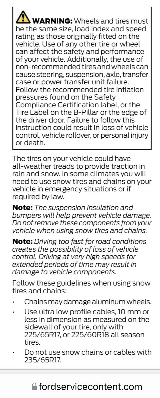

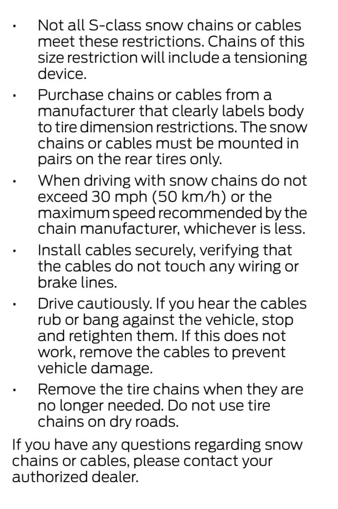

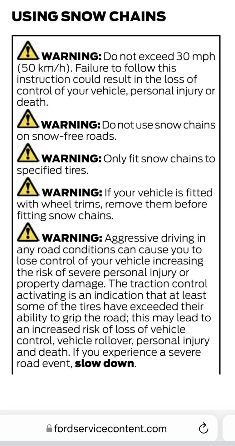

Snow chains required or not with AWD?
bgn
Jun 12, 2021
3,035
5,688
WA
Ford says 8.7 inches clearance for maverick .
8.3", unless you have the $795 wheel upgrade option, which brings you up to 8.6" with the Wildpeaks.
