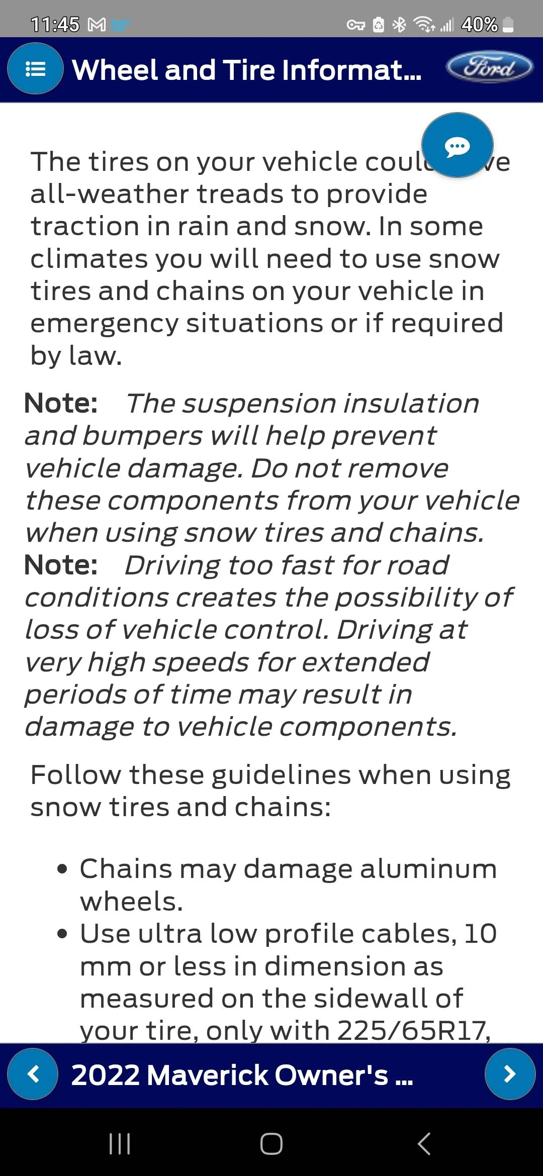

Just a reminder on snow chains...30 mph, stock tire size only, front tires, low profile 10mm and steel wheels...
https://www.fordservicecontent.com/...ingEnabled=False&userMarket=USA&buildType=web
  • Chains may damage aluminum wheels.
  • Use ultra low profile cables, 10 mm or less in dimension as measured on the sidewall of your tire, only with 225/65R17, or 225/60R18 all season tires.
  • Do not use snow chains or cables with 235/65R17.
  • Not all S-class snow chains or cables meet these restrictions. Chains of this size restriction will include a tensioning device.
  • Purchase chains or cables from a manufacturer that clearly labels body to tire dimension restrictions.
  • The snow chains or cables must be mounted in pairs on the front tires only.
  • When driving with snow chains do not exceed 30 mph (50 km/h) or the maximum speed recommended by the chain manufacturer, whichever is less.
  • Install cables securely, verifying that the cables do not touch any wiring or brake lines.
  • Drive cautiously. If you hear the cables rub or bang against the vehicle, stop and retighten them. If this does not work, remove the cables to prevent vehicle damage.
  • Remove the tire chains when they are no longer needed. Do not use tire chains on dry roads.

I don't know where you got your info but it is incorrect.
The owners manual clearly states when and how to use tire chains. If it's in the manual it can't void your warranty. People need to open that book instead of listening to so much misinformation.
The Ford' text you cited mentions "...as required by law" and that is important info in states where "chain enforcement" occurs as a matter of law.
