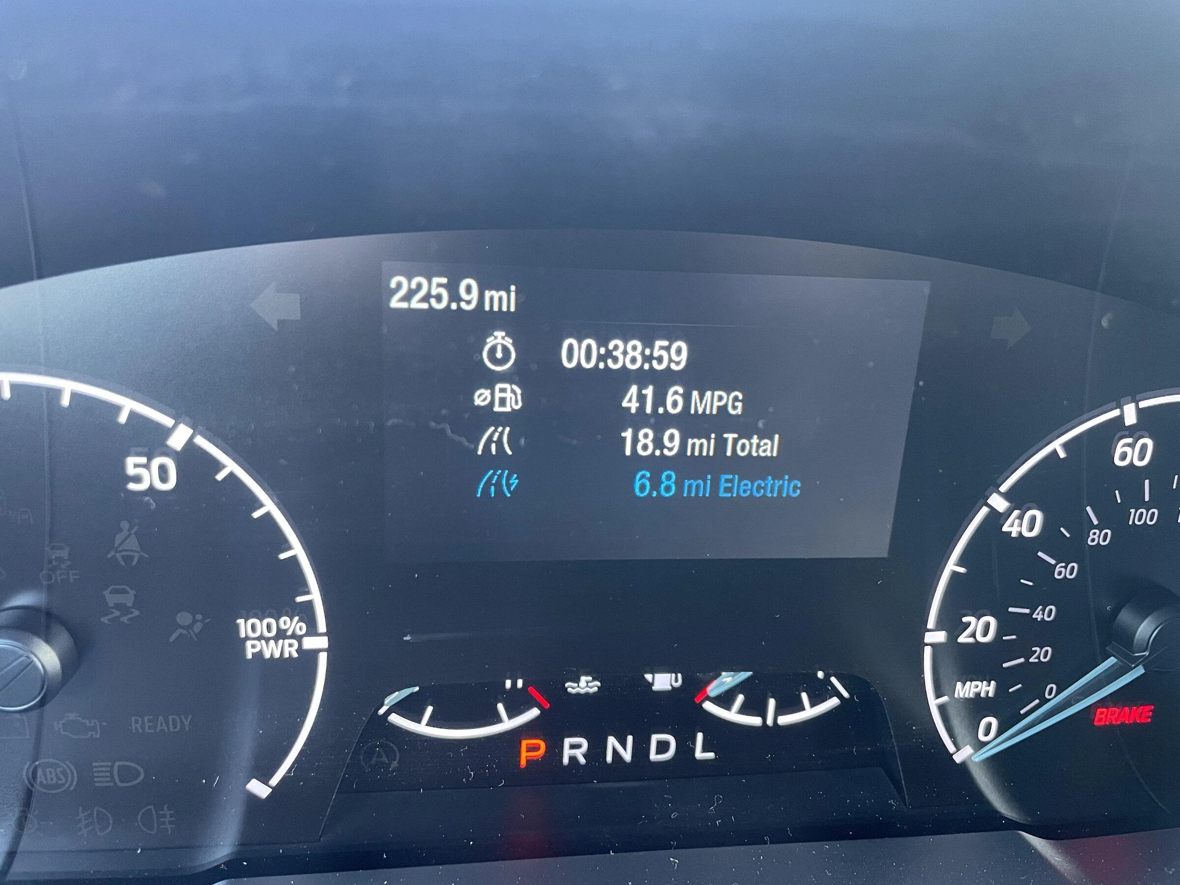

Now to the good part. The mav in XL trim is a freaking steal. Is definitely not luxurious in any way but we’ll designed for the price. The hybrid is not fast in anyways but plenty of power to get from A to B. The breaks are a bit touchy weird regen to breaks feel but after only 30+ miles it’s not bad I’ve just been letting up on the break as I get close to a complete stop and that seems to stop it smoothly.

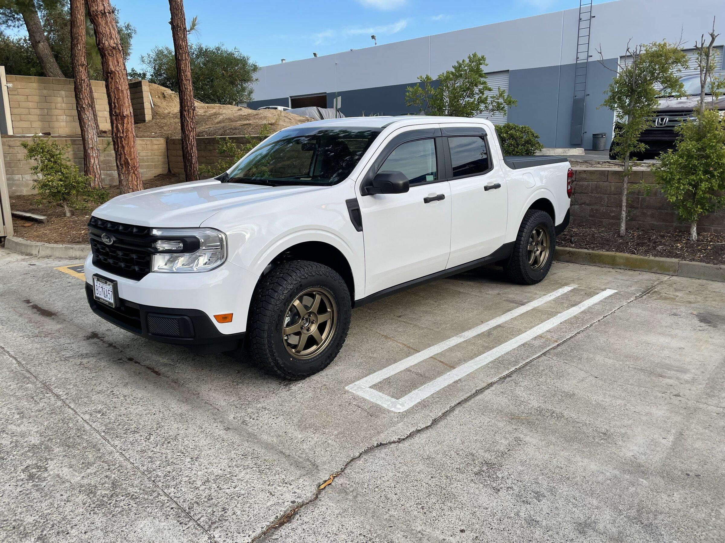

Couldn’t stand the steelies so swapped those out today with only 30 miles on the odo. Lol.
Threw on the some TE37’s with adapters and falken rubitrek 245/70 17 and a 1.25 inch leveling kit. I am getting very slight rubbing on the felt liner but nothing that concerns me. Did notice that bumps are a little harsher now but could just be me after all I only have about 50 miles on it now. Lol.
Just have a couple crappy pics for tonight still have some things to install so will get better pics when it’s done.

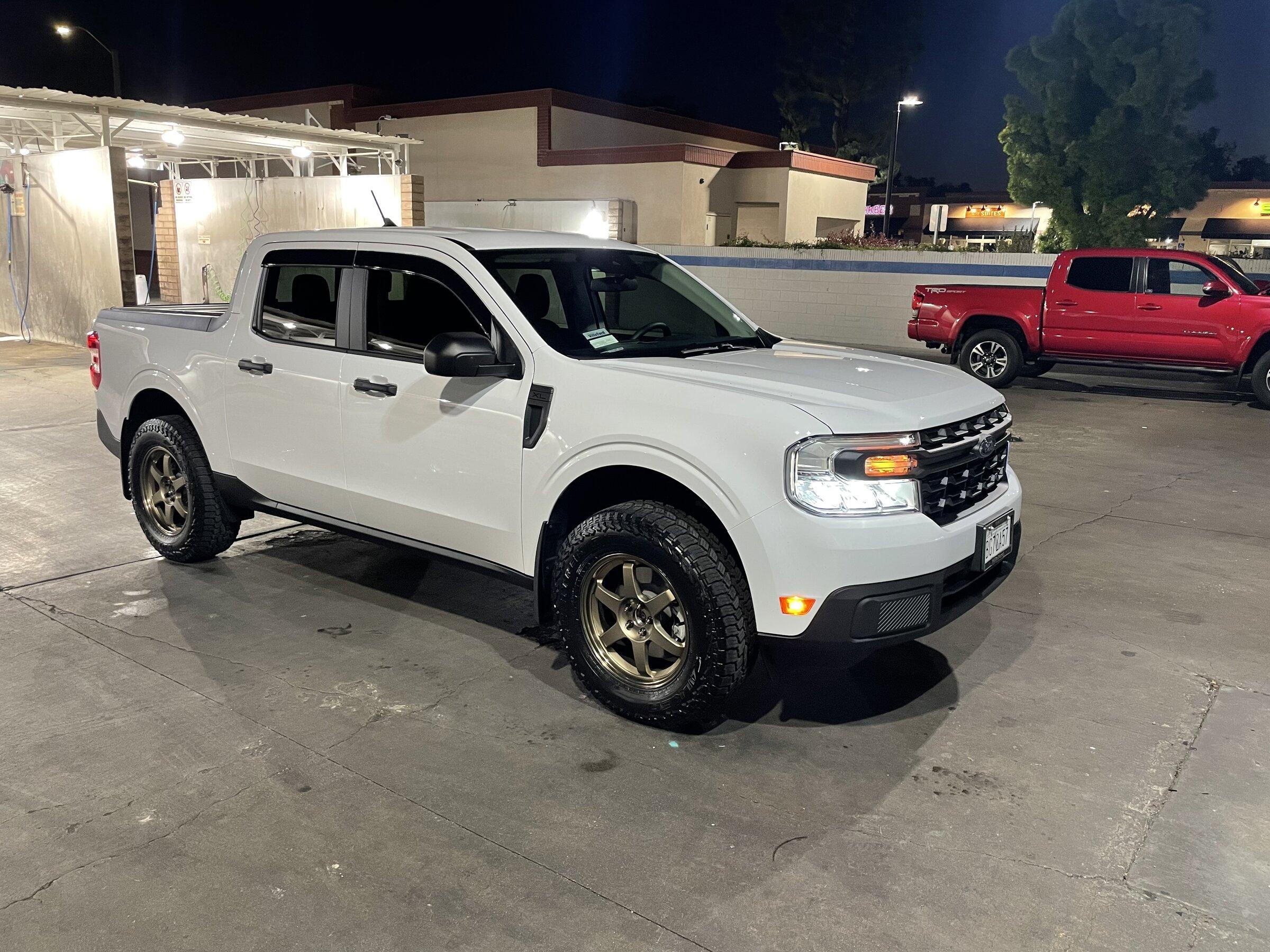

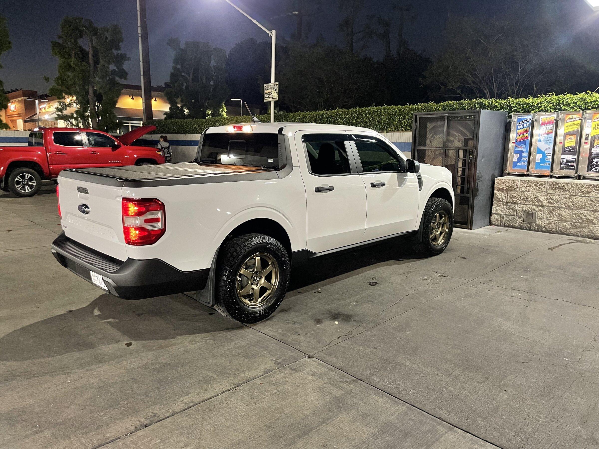

First wash and added mudflaps and Tint matched the front windows.
Pretty simple. I’d recommend ordering 2 sets of camber bolts. I only ordered 1 set and still have a little positive camber. Second set is on the way so I can fix that.How hard was that leveling kit install? Definitely want that on my hybrid XL
Interesting, I did the RC one inch leveling and all in spec after alignment with out additional camber bolts .Pretty simple. I’d recommend ordering 2 sets of camber bolts. I only ordered 1 set and still have a little positive camber. Second set is on the way so I can fix that.

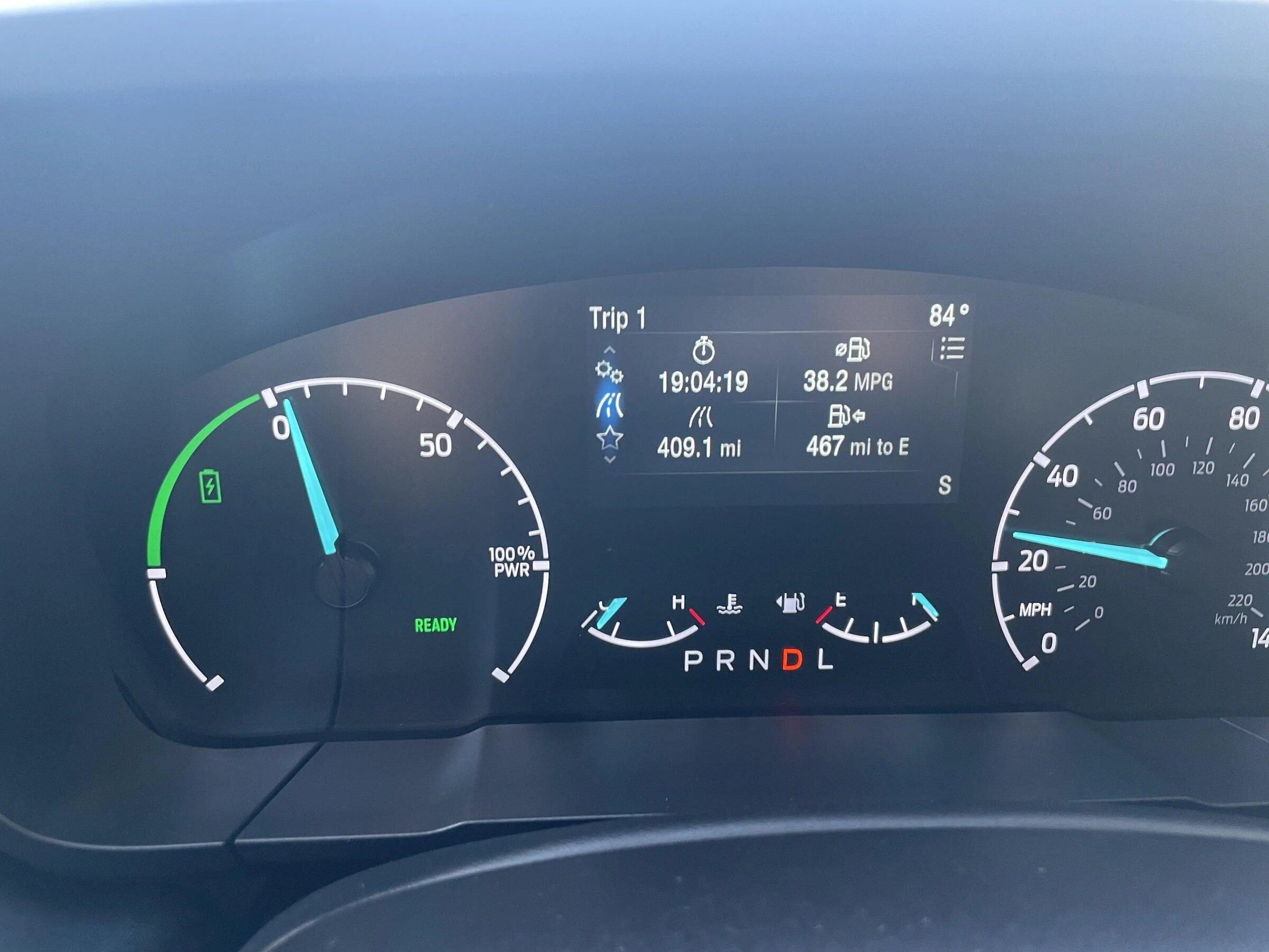

First off, great truck and mods.First fill up. 65/35 city/hwy. about half I tried for best mpg. 37.7 mpg. 409miles, 10.848 gallons.
Only first 20 miles were in stock wheels.
not bad for a level and 245/70 17 at tires. I’m sure I could easily do better if I drive conservatively the whole tank.
It aligned ok. Drives straight and no issues but I can tell it has a little bit of positive camber and the bolts that came with the kit have almost no adjustment. But alignment usually varies a bit from vehicle to vehicle so could just be mine.Interesting, I did the RC one inch leveling and all in spec after alignment with out additional camber bolts .
Love the bronze on white , sharp looking truck.
