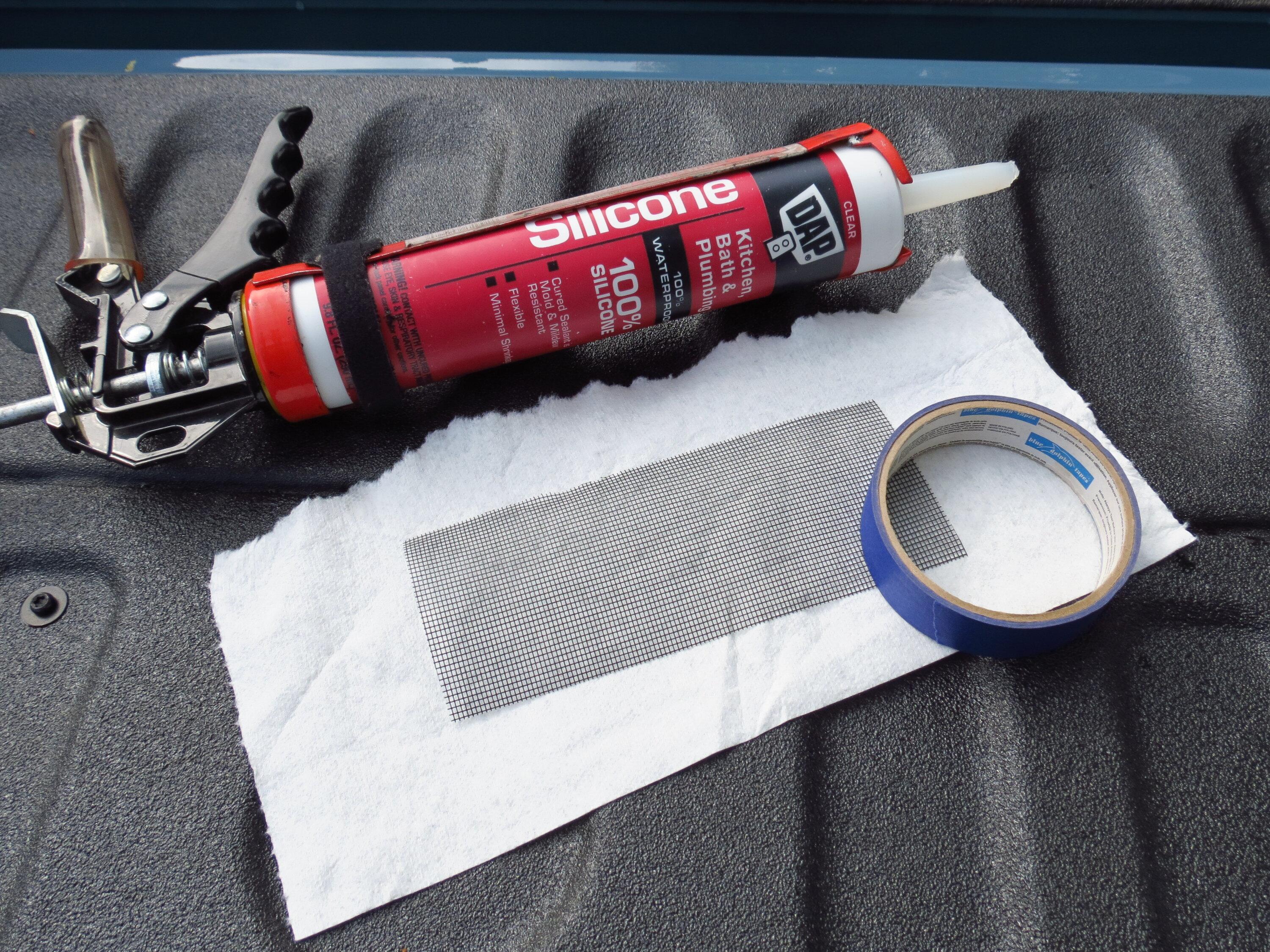

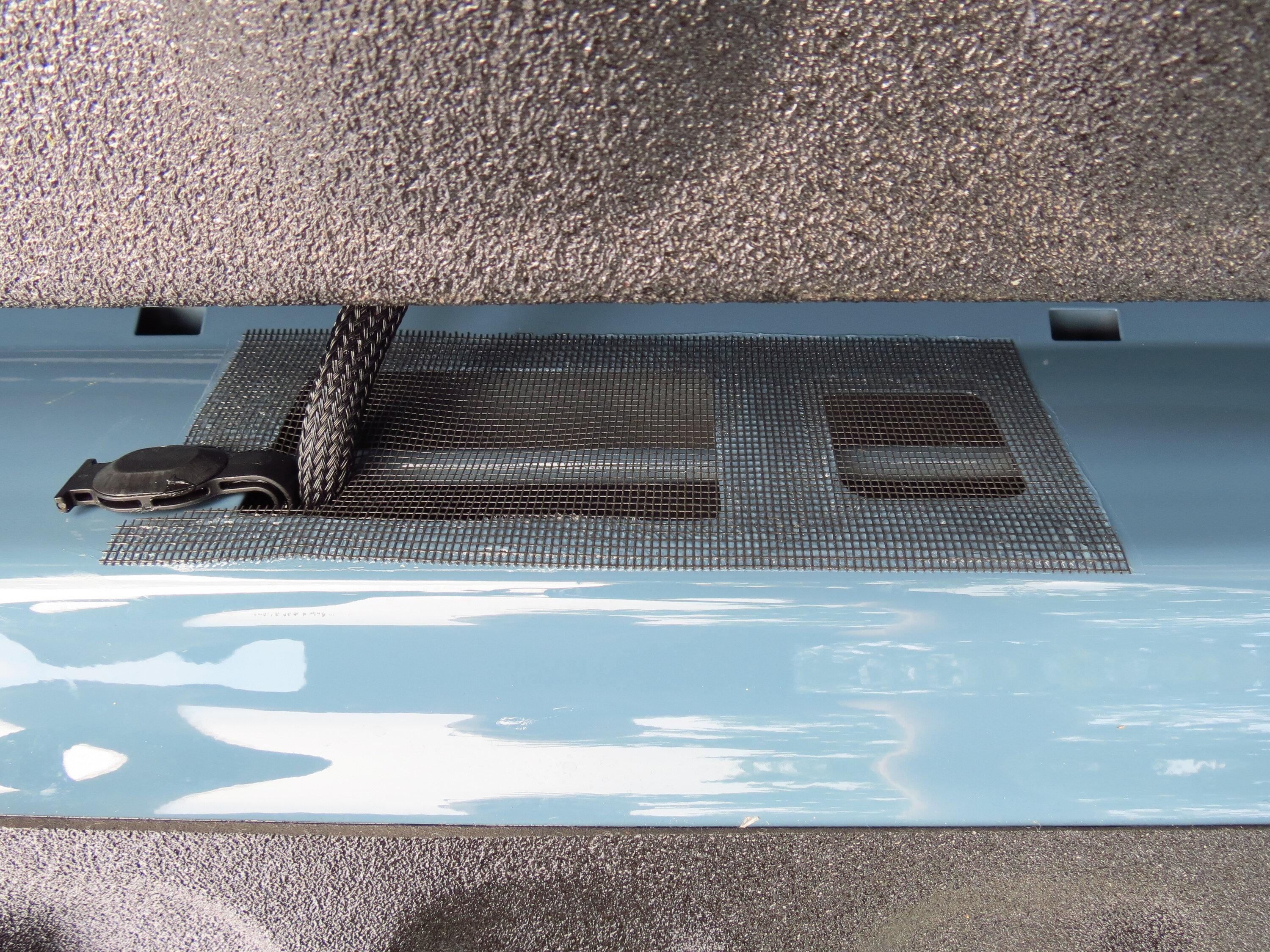

Since the prior thread on this topic is closed, here's what I did to address it.
A past truck I owned had rust come through the paint on the bottom of the tailgate and it started to appear about 3 years from when it was new. I'm convinced it's from dirt, wood chips, leaves, grass, and everything else making its way into the tailgate vent holes. It sits in there for years and retains moisture and rusts it from the inside out.
Before I hauled anything in my Maverick, I wanted to reduce the odds that this was going to happen here. It'd be easiest to put some butyl tape right over it, or as others have suggested, 3D print a cover for it but I don't think those are good options as they'd reduce the airflow provided to the inside and make it even more likely to hold moisture.
In the existing tailgate hole, I added a zip tie to the harness which exits the hole to hold it to its plastic fastener better so it wouldn't move around as much as the gate is opened/closed. I cut a piece of fiberglass window screen a bit bigger than the hole, and notched out a spot on one end for wiring clearance.
I masked off the hole, then applied a couple millimeter layer of clear silicone around the perimiter. Embed the screen in the silicone.
I don't know if it will keep everything out, but it will certainly be better than it was. The fiberglass screen isn't the strongest, but I'll be installing a tailgate gap cover shortly to keep the big stuff out of the gap completely. And if I ever need access into the gate through that hole, the screen and silicone can just be peeled off.

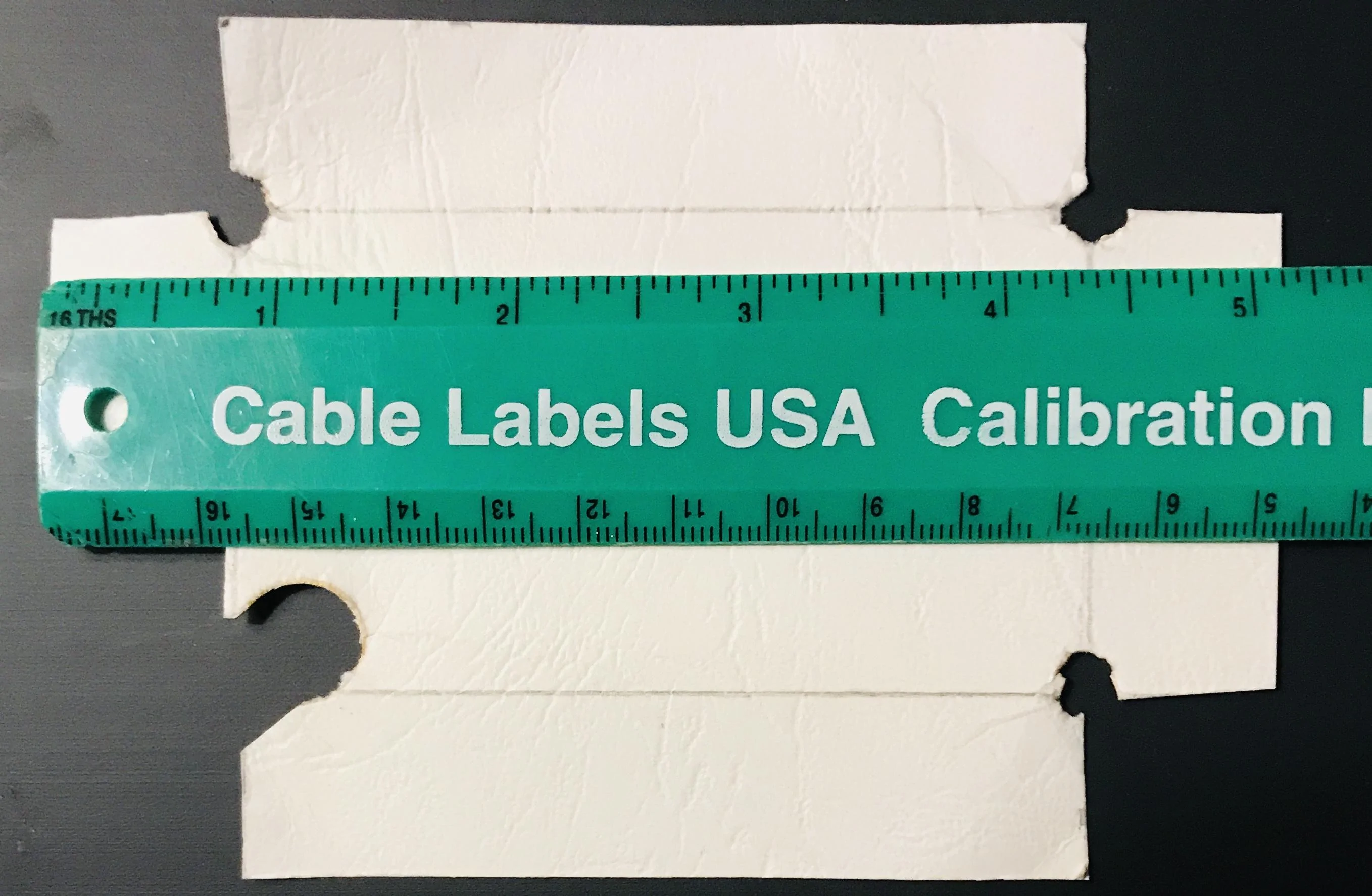

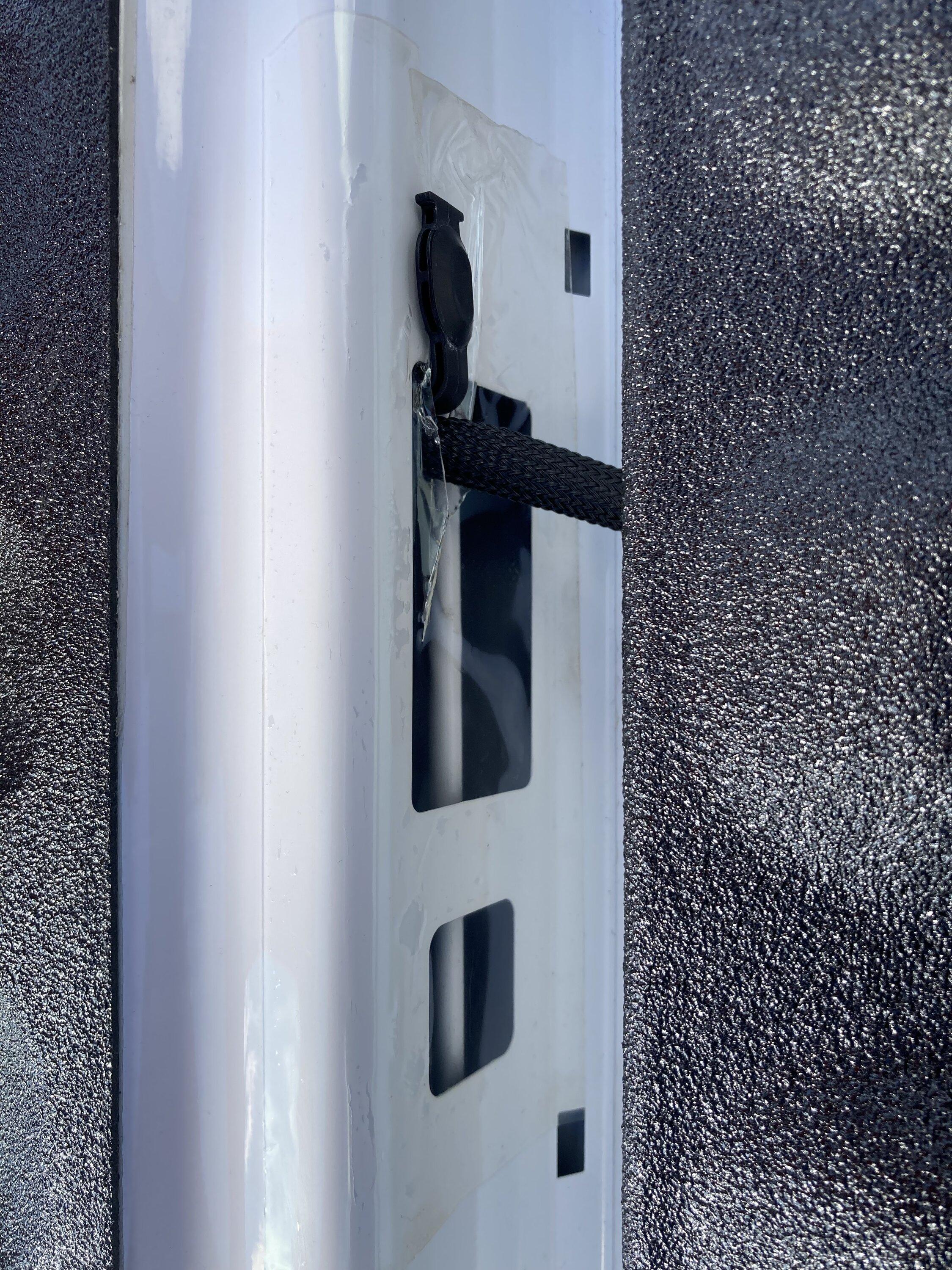

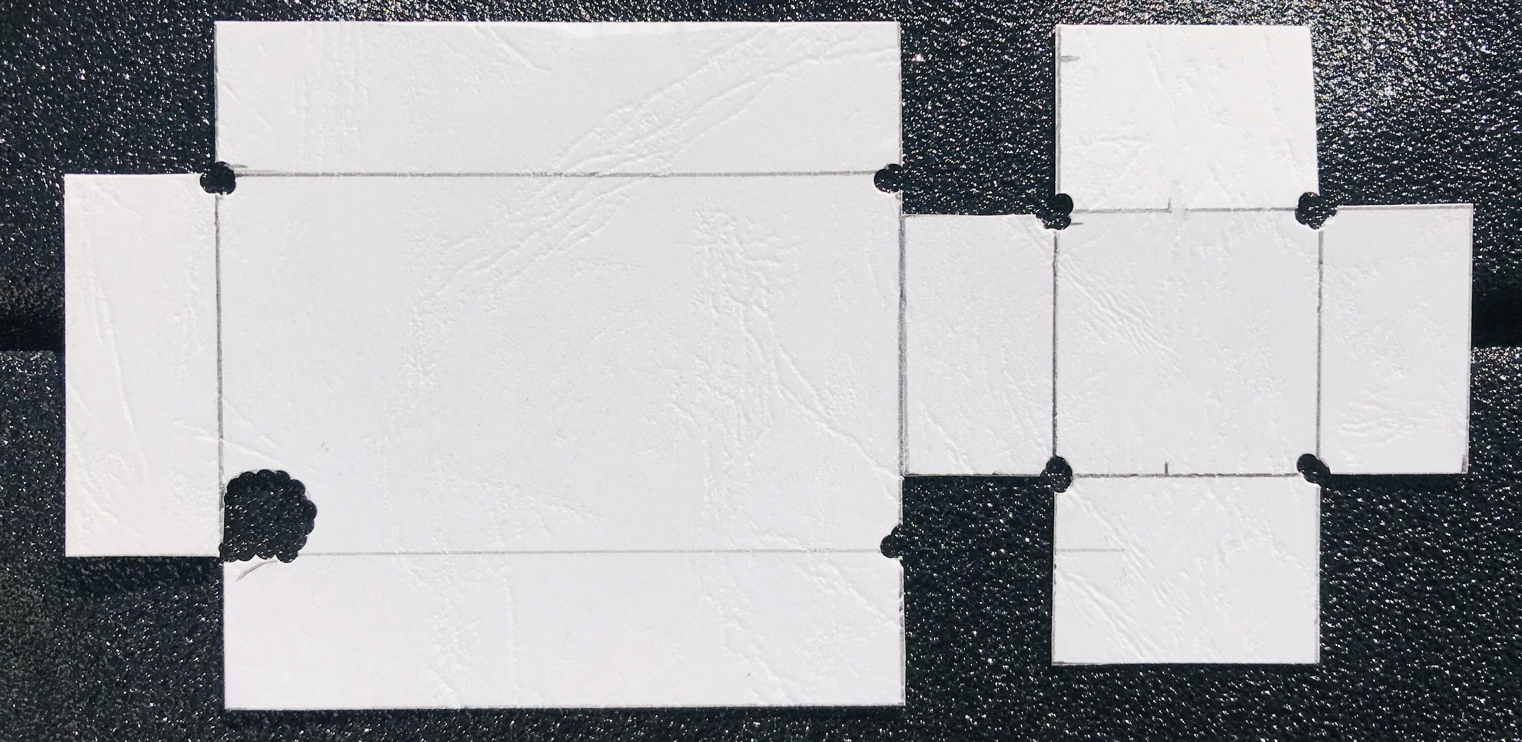

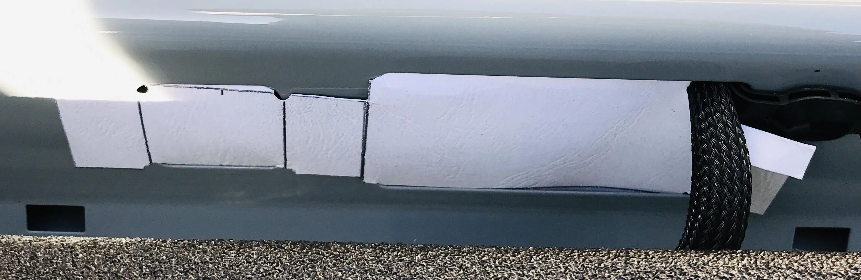

I ran out of daylight but my plan is to make a cover out of 3-ring binder divider, or similar flexible plastic. Managed to make a template for the larger rectangular hole, then realized it can be extended to cover the smaller opening.

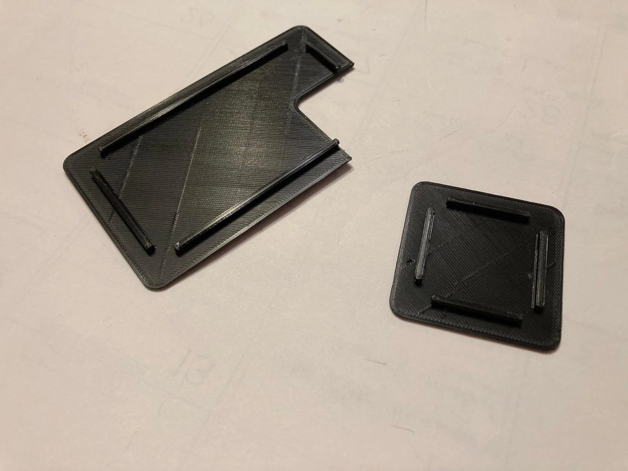

@P99Guy and I are really close to having solution. He is a 3D printing machine. We have been tweaking the design and he has been printing a bunch of prototypes. He is going to print our latest design tomorrow and hopefully he will update. I think we are close! Stay posted, we haven’t forgotten about you.

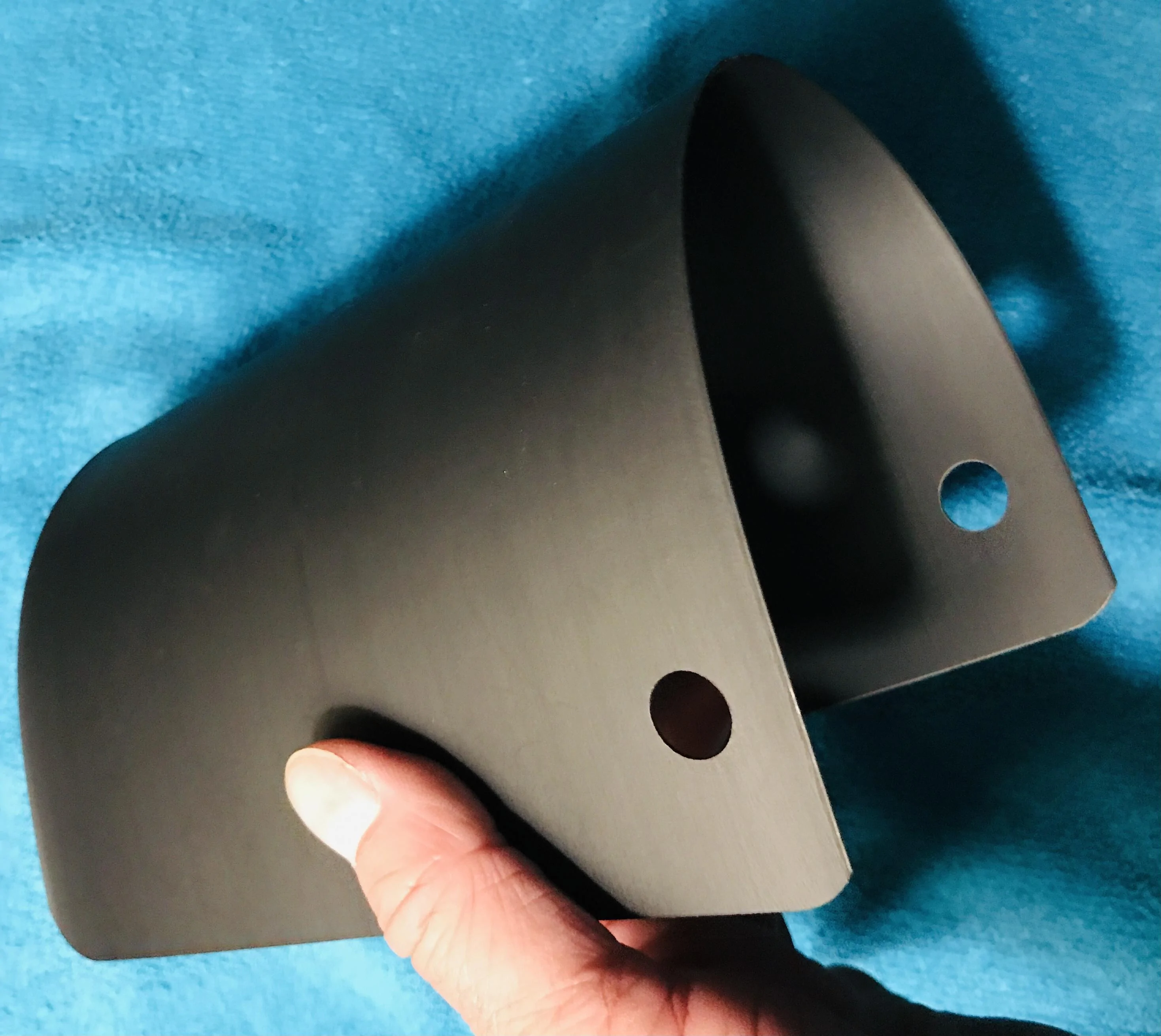

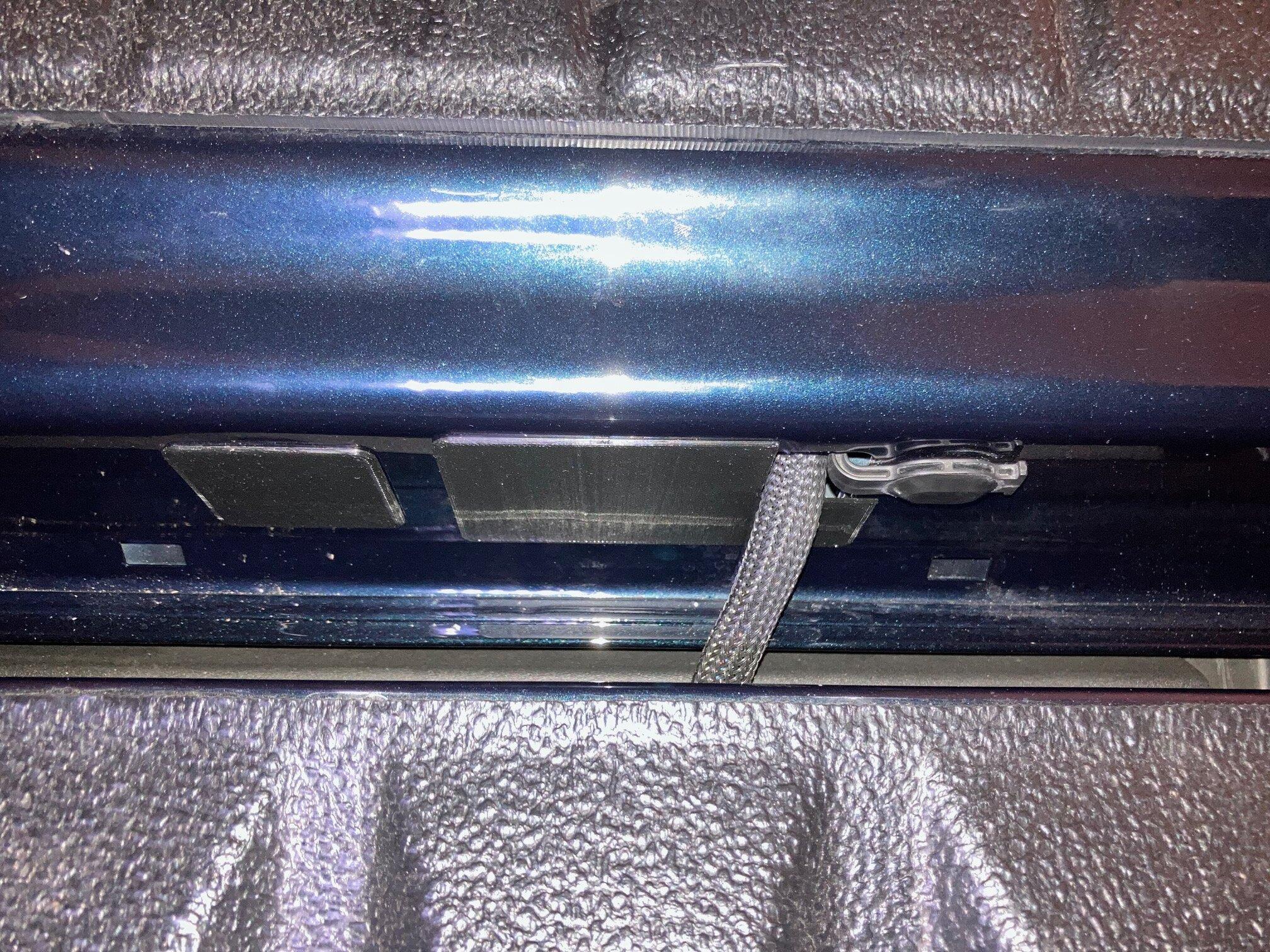

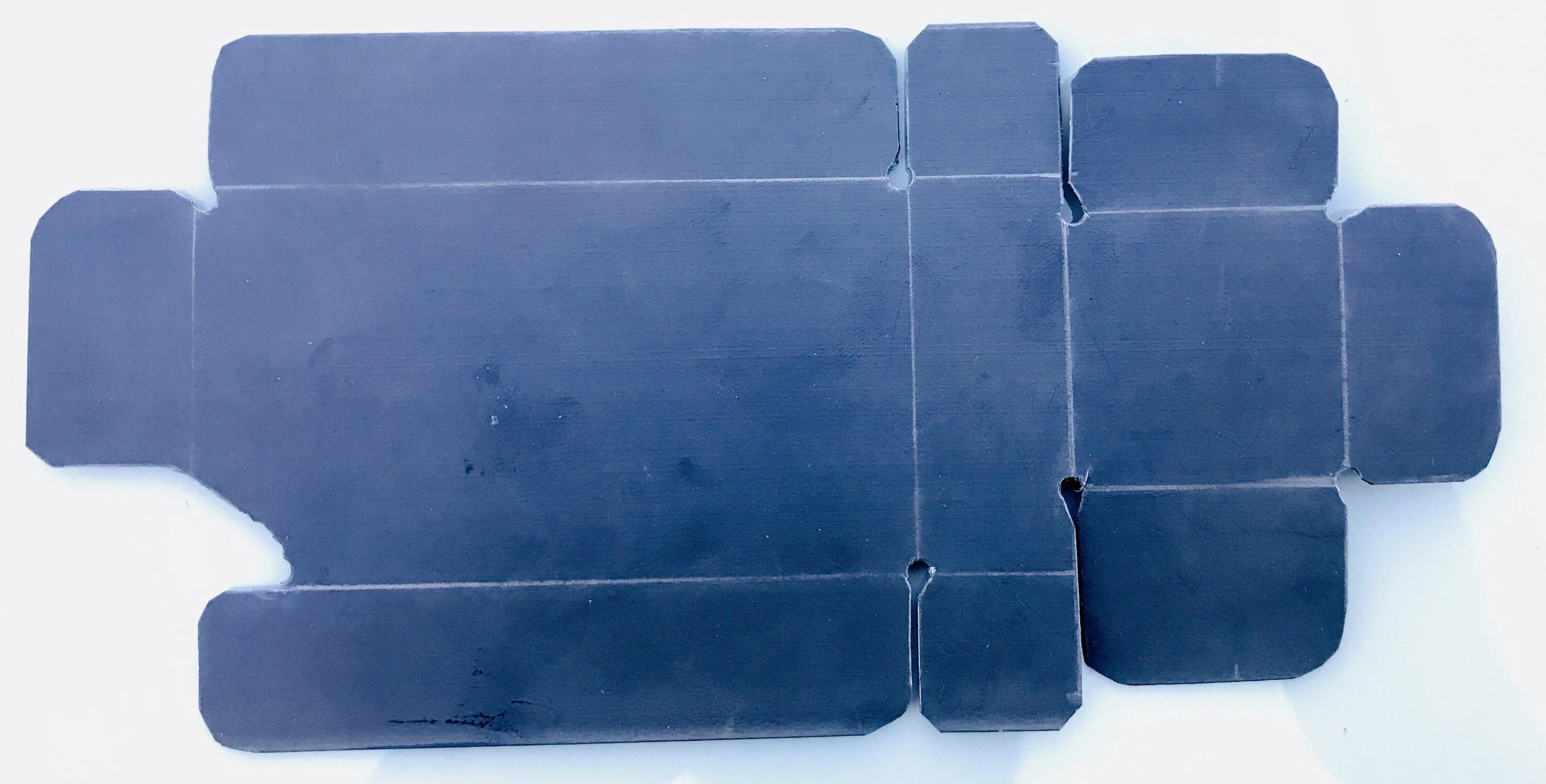

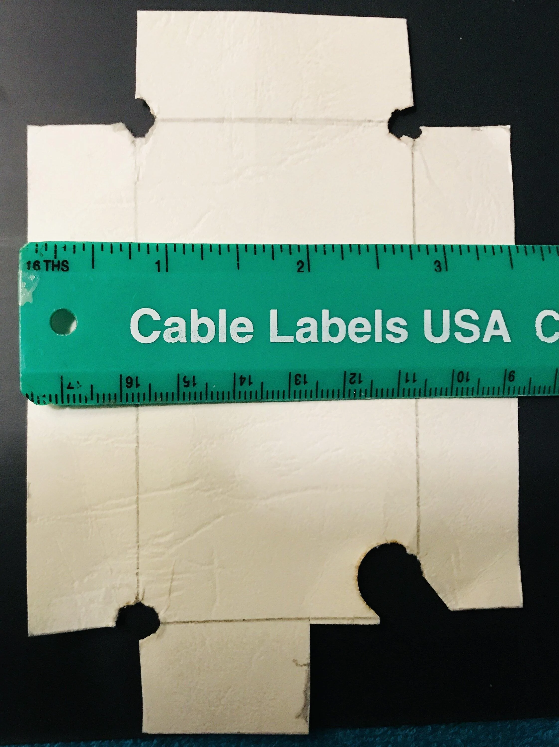

Template needs adjusting but it fits and is removable.
Ford Maverick Tailgate Hole revisited, with easy solution 0B0AD737-8A18-4136-8210-7E4227A6CC23
Template is the right size but the plastic cracked during installation. Need to find more durable alrernative.

Cool! Thanks for posting this. Did you design it?
I did… they fit ok, but slightly loose. I’ll probably scale them up a couple percent if they ever come off. They were printed on an Ender 3 Pro which is dimensionally quite accurate using PETG filament for higher temperatures.
