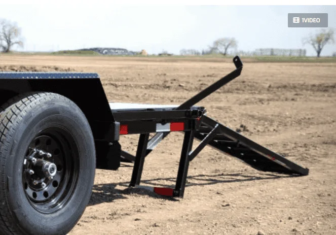

Perhaps a support/brace for the top of the ramp?
Interesting idea. Thanks.
One more thing to fabricate and store though. Oh. On second thought, it won't really work.
The truck goes down a couple of inches as the springs compress.
I think stronger (thicker) wire cables are still the best bet. Or maybe two stock ones on either side? Wonder if gate would still close. 🤔
