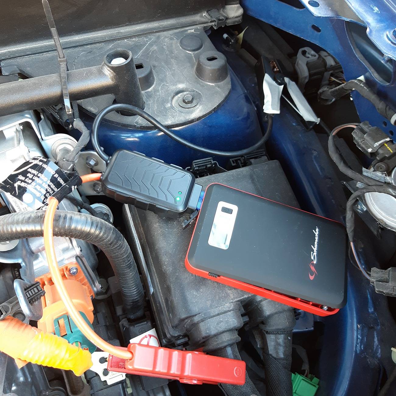

Here's a picture my bad Schumacher jump starter with the cables in the same place they would be hooked up, if I were using it to jump start my Maverick.
I'm going to go out on a limb and say that most portable jump starters are pretty similar as far as how long the cables are.
I added masking tape to the negative clamp so it could be seen.
The negative clamp is hooked up to the negative body bolt. The positive is not hooked up, but is right on top of where the positive terminal is.
Yes I know the case is split on my Schumacher jump starter. I don't use it. This was just for demonstrative purposes. This is the second Schumacher where the case split, from the battery swelling.
Nice to see that it fits. Really not that far apart.
