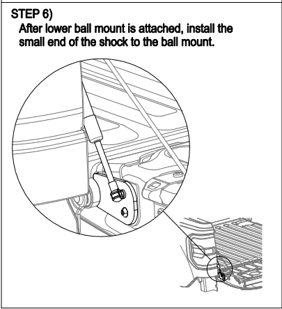

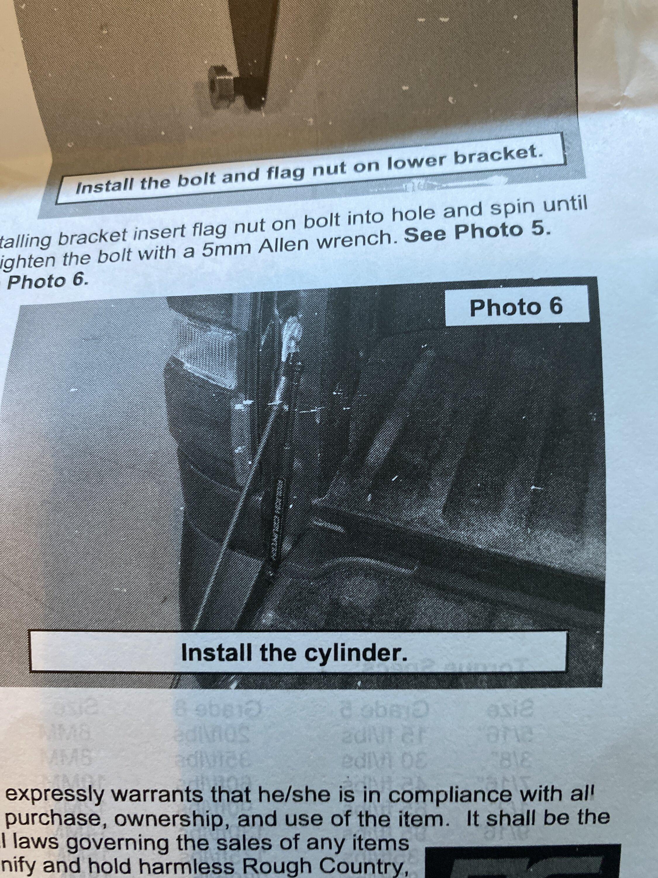

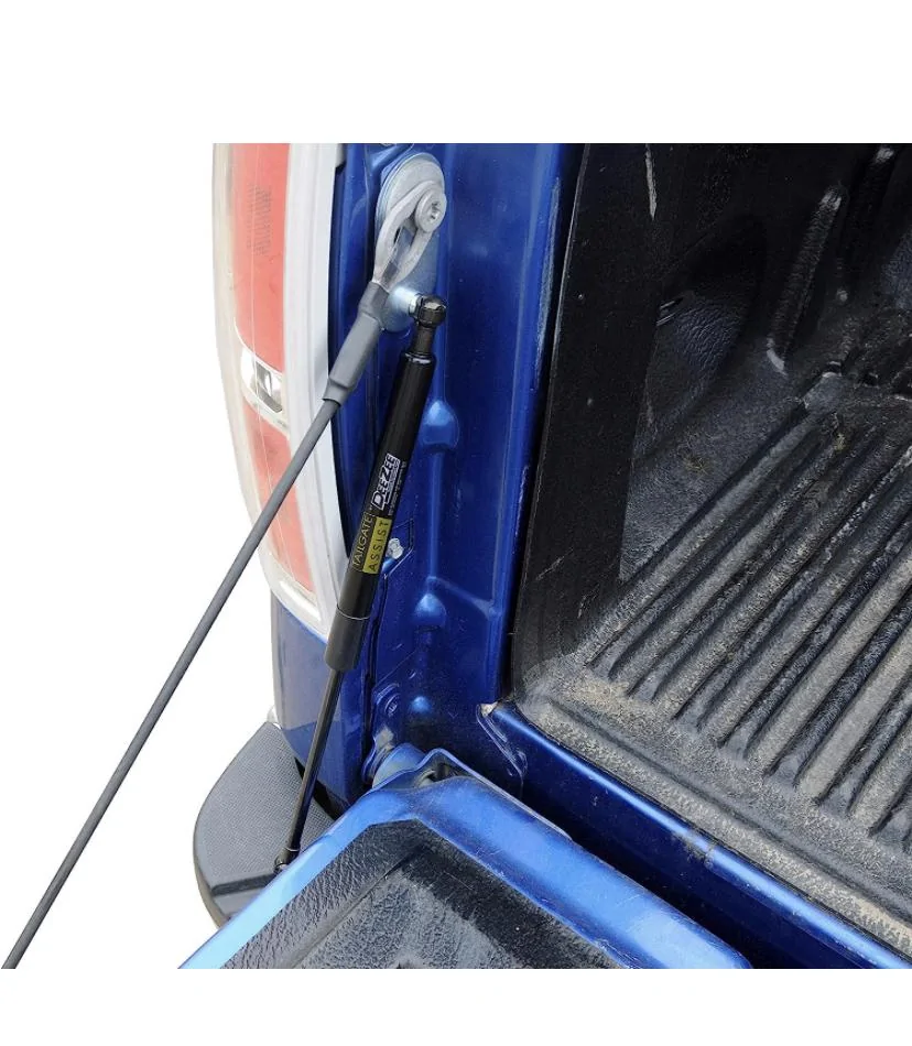

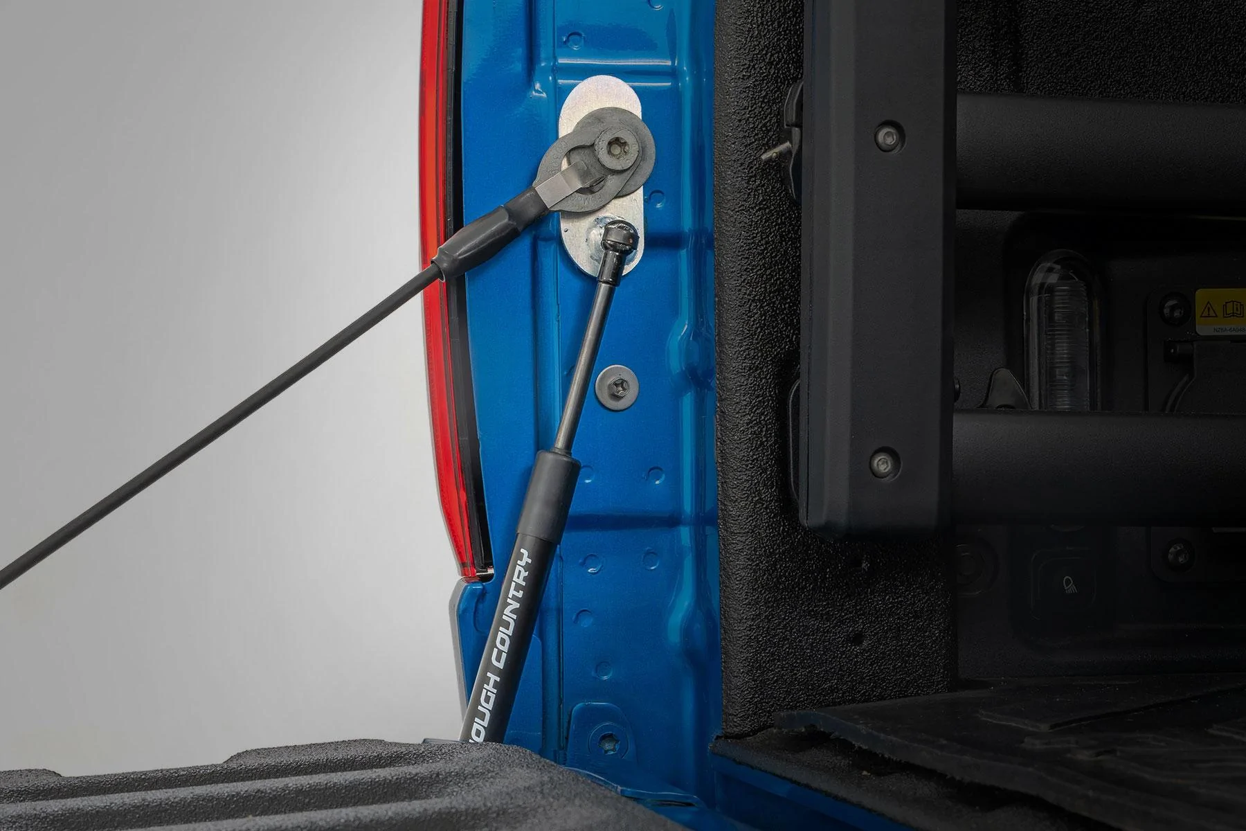

It's worth it for a cheap upgrade. The bolt that goes inside the tailgate is a PITA to seat. Tighten it down as far as it will go before putting in the tailgate. Then loosen just enough so it will turn into place.Thanks for the link. Wow, I thought getting this would be a luxury but it seems like a PITA honestly. No real clarification on orientation of the strut and both ways seem to have issues. Thinking I’ll return it and just keep slamming the tailgate instead.
