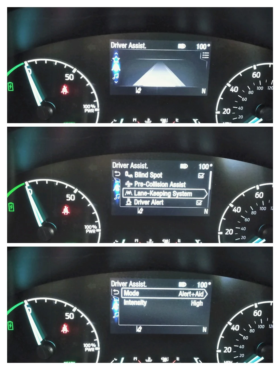

What setting do you have your Lane Assist on?

I'd have to check. Is it under the settings? I thought just tapping the side button on the turn signal turns it off or on. It didn't even occur to me there might be settings for sensitivity. I'll have to check.

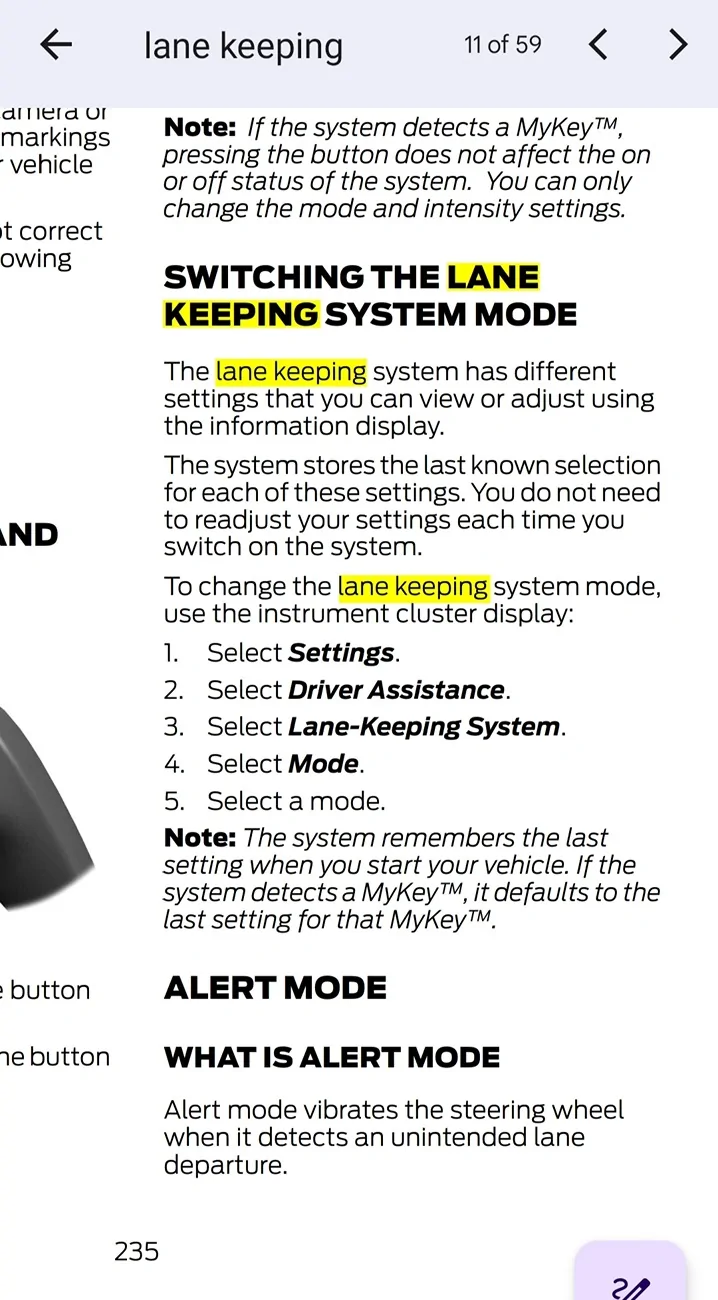

Frank, I hope this helps.
Technically it's called 👇🏻
The Ford Maverick’s Lane-Keeping System.
Not to be confused with Lane Centering which I believe requires Adaptive Cruise Control.
It helps prevent unintentional drifting by providing steering nudges or wheel vibrations. It functions via a button on the tip of the turn signal stalk and works at highway speeds (typically over 40 mph) when road lines are clear.
